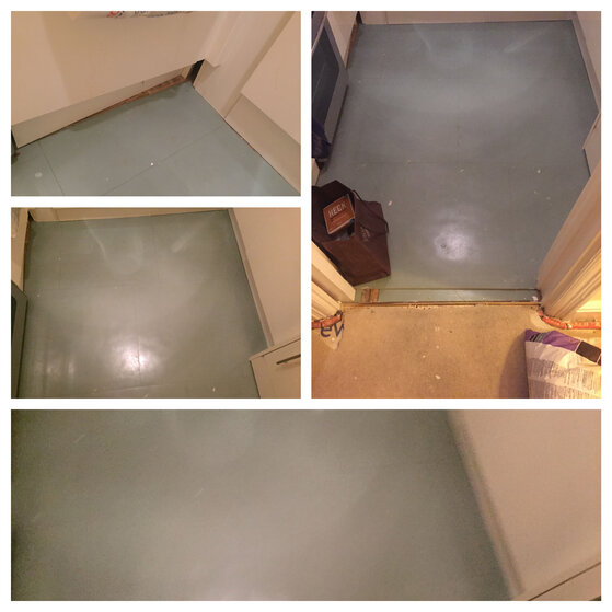

its stuck and it won't come off without causing wear and tear to the ply and he reckons we would have to lift the whole kitchen out to replace it, am thinking its maybe simpler if I just add Vinyl to it for now and later get the whole thing done,

here are some snaps of the kitchen and bathroom floors
guys instead of using an hardboard would removing the lino, putting a mesh and tiles over be another option,
Thought the lino was tricky to get up!?
I had a few other people look at it and they think the Lino may come out with a heat gun, the floor may get damaged a little as the adhesive is sticking well and they have suggested I put a mesh and then the tiles, will this work ?
I have had 3-4 more professionals(hopefully) look at it and its down to two options,
1. One option was to cut the lino+ply sections and replace with 3mm floor + ditra matt and then tile on top. This would keep the height consistent
2. The other option was to just remove the lino and then add a steel wire mesh and then add tiles on top. this would increase the height but is a simpler job
am leaning towards first option,

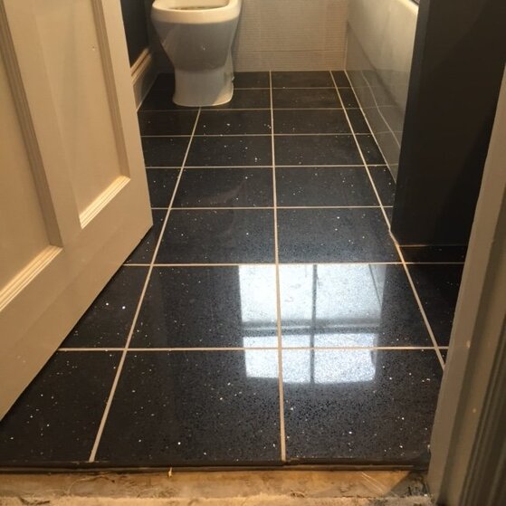

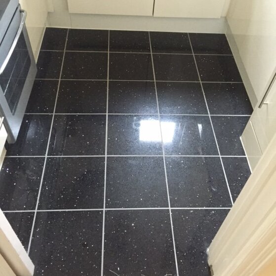

removed the vinyl and ply underneath , replaced with hardboard, had to replace some of the timber too as it had gone bad, took ages to level it as the floor was not even but worth it and in the end the height dint increase much too,
