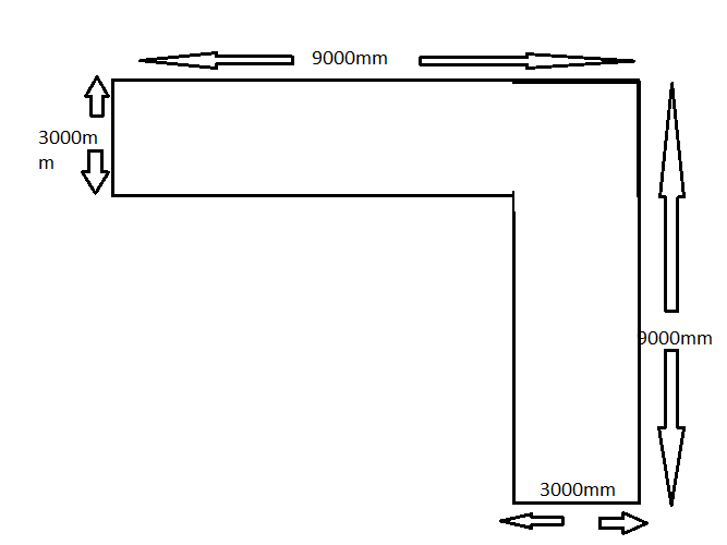

I've now taken on a lockdown project which I'm part way through preparing the substrate for a large porcelain patio that I'm intending on laying myself - yikes. WIP pics attached. Some of the advice from last time was not to take on the internal project so I found a really good tiler who did a fantastic job which was a god send as I would not have met the critical Xmas deadline.

They've also mentioned I should install movement joints at 3m intervals but having scanned the net I'm struggling to work out what these are and exactly how to install, thickness, materials etc so any pointers would be really appreciated.

I assume these aren't being grouted, therefore no expansion joints needed.

Hello, I am grouting so it sounds like an expansion joint is required then?
