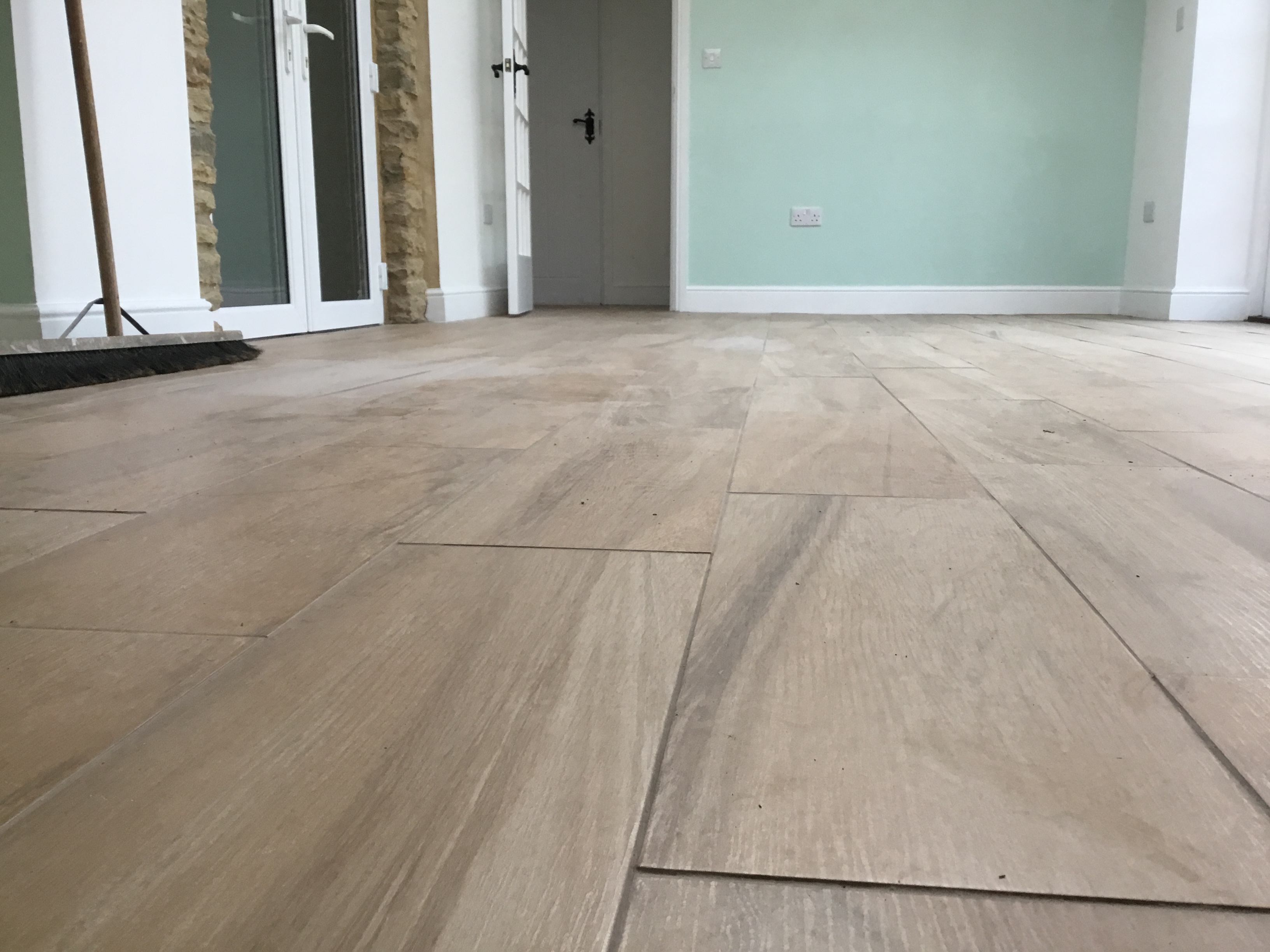

this is why I will always centre doorways even tho this has been handled terribly poor because the tiles are not centre it looks shoddy
Well you can either center the tile or centre the grout joint cant ya so I would always do it... Unless it causes slithers around the room and being off cant be avoided I just think doorways look 10 times better centred
Well if theres 3 doorways you have to sacrifice 2 and centre one... Unless it actually went smoothly enought to centre them all lol
