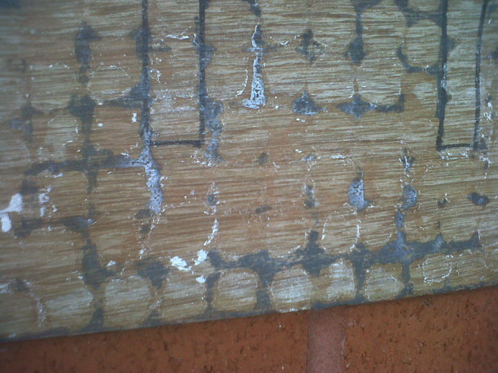

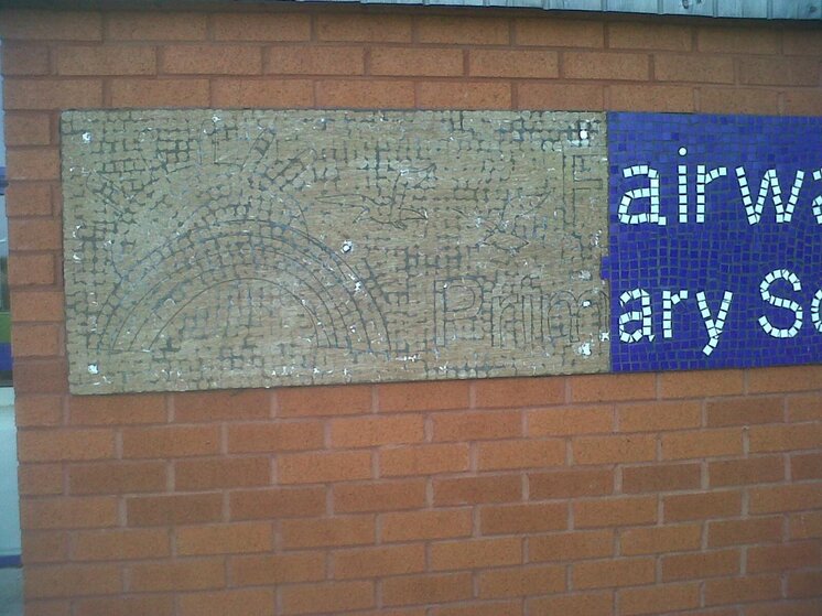

An example of a PVA disaster... just now, in a mosaic artist group I belong to, this poor mosaic artist, commissioned to do a 24ft! community mosaic had this happen to her mosaics 2 days after it was installed - she used exterior ply (wrong), primed it with pva, (so so wrong) and then used a cement adhesive and grout - this is the result. Yes, I have given the lecture... have given it several times before but it's horses to water, isn't it... and it doesn't help that most mosaic books on the market still say, "prime with pva solution".. bladibla..
