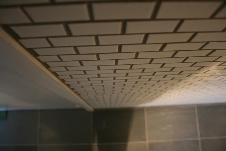

I have just had some work completed in my kitchen, small 1inch by 2inch ceramic wall tiles (provided free issue) on open woven sheets in a stretcher pattern, white, on 5.6 square metres of wall. The kitchen is 95% refurbed, lighting in place etc.
Because I am not sure of my skill levels in tiling and wanting a very high quality finish I hired a professional.
The quote and subsequent bill was for 2 days, fee: 330 + 45 for adhesive/grout, two days to complete. It took him 7 + 5 hours.
See the photos for the results.
No1 shows the top line looking back towards cupboards, apparently no level was established.
No2 shows the variation in grout width, from 1.5mm to over 5mm. The tiles adjacent to the wall and behind the pipes are not grouted at all. note the variation in width and the face-normal rotation of some tiles. note the lack of horizontal (or parallel) lines. also, vertical lines are not in line for every other course.
No3 shows the vertical misalignment on a section 1200mm high from skirting level. this is the same patch of wall as photo 1. The grout on the floor was advised (with a half empty bag presented also) as the grout colour required. We asked for pale grey grout and got a fairly dark grey. of course the paler grout may have mitigated some of the bad alignments.

The problems are:
grout is very much the wrong colour
uneven line widths, not plumb, not level across courses.
grout has variable colour and cavities, adhesive shows through in places.
is it normal to sweep grout upto accessories so they are set in it (and wonkily at that (they can be set ok as before))
What is a reasonable conclusion to draw? any comments?

Hi there the work is sub standard however if the tiler is switched on you maybe in trouble for stopping his cheque. As far as I am aware and this was told to me by a lawyer it is illegal to stop a cheque if you have handed it over for work completed. In other words if you have not complained to the tiler for the poor work completed and handed over the cheque as payment it is against the law to stop it. Once paid into the bank and the cheque bounces you would then be laible to any charges incured by the so called tradesman. If you have a problem and you do you should pursue him by letter and then if he did not respond you then can follow the legal route. Mind you your guy might be not switched on lets hope.
Check it out with citizen advice or someone like that.
All the best the job does need started again though.
