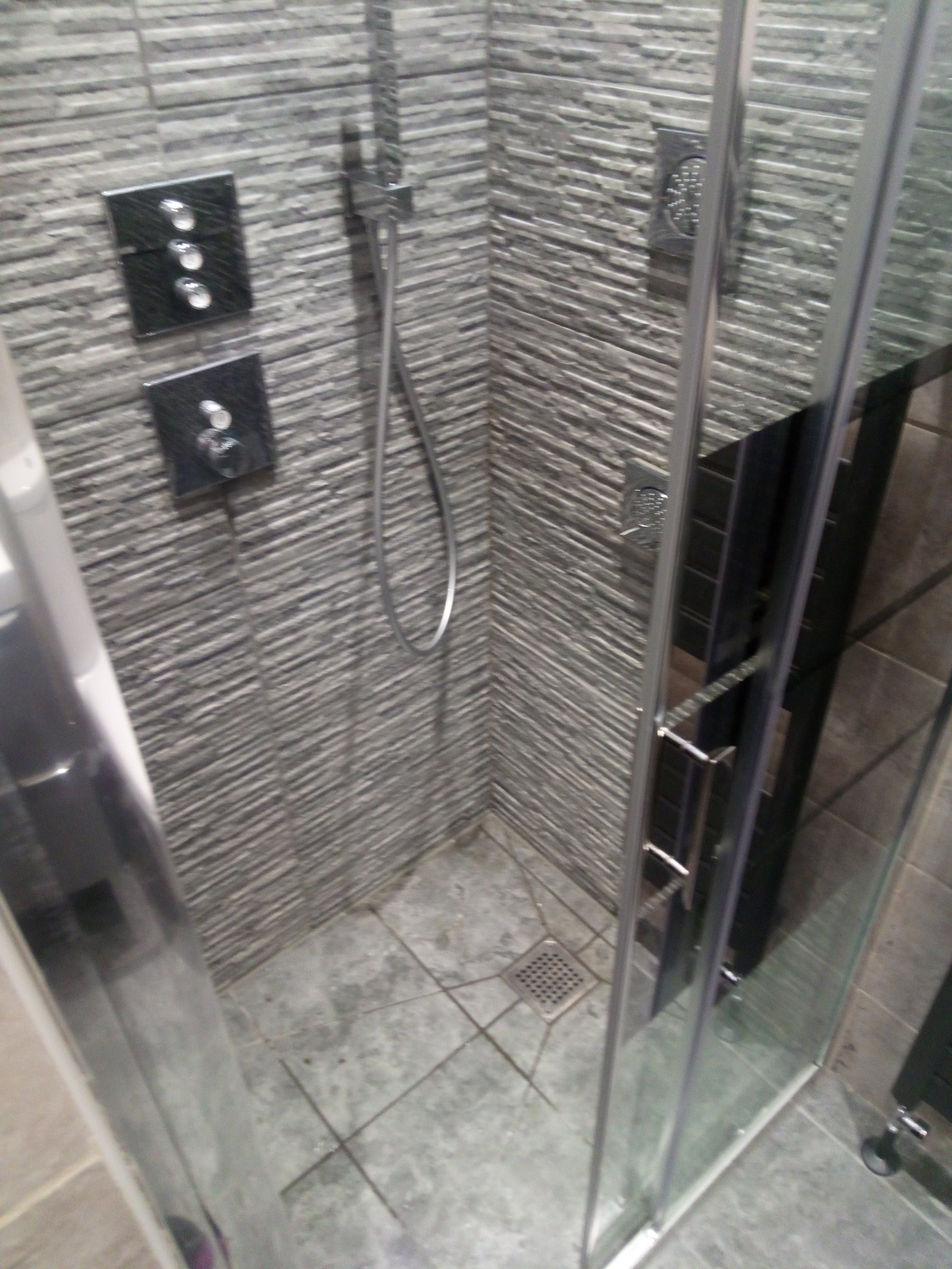

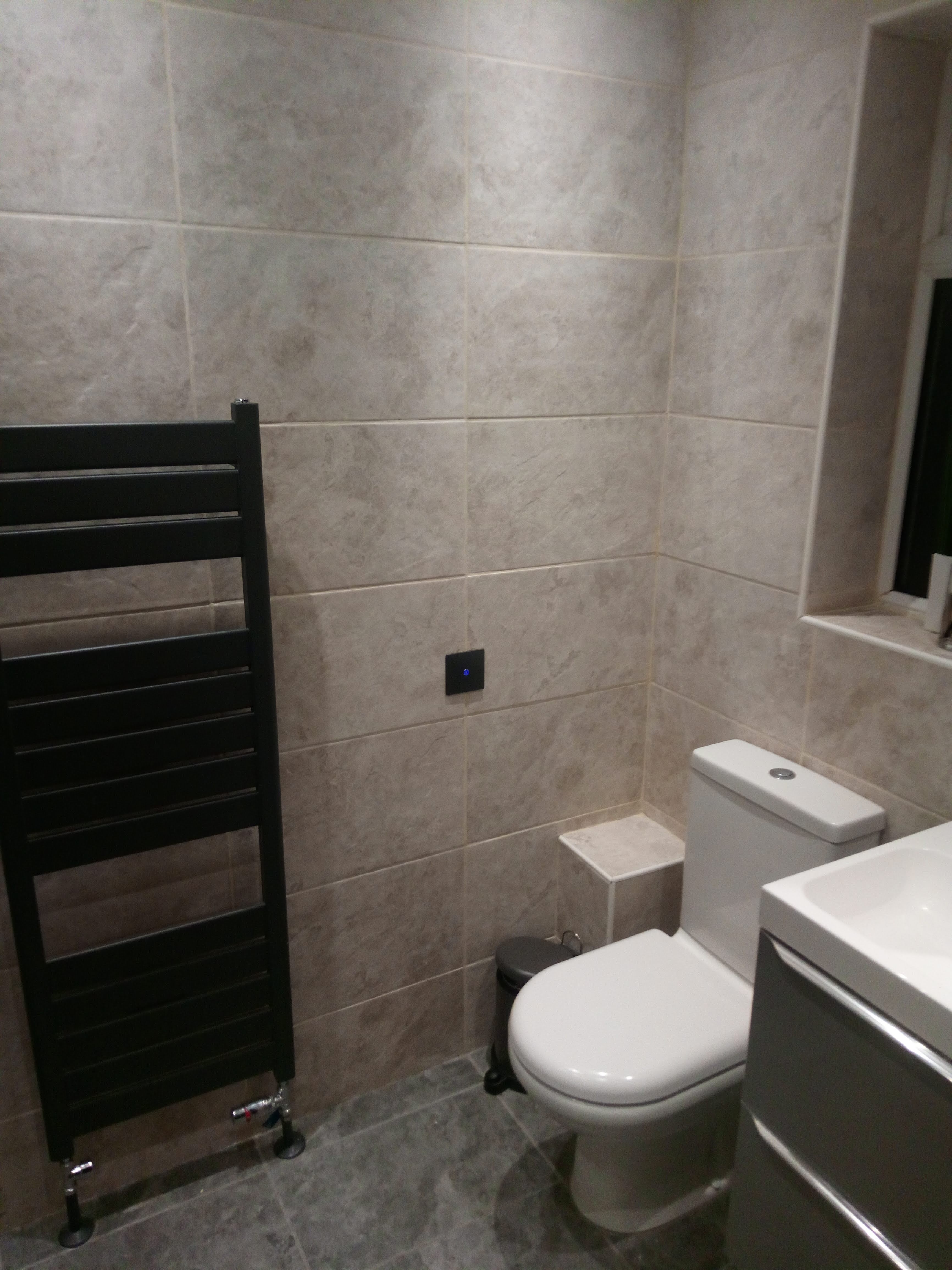

Here are the photos of the room (my first real effort at tiling) and the shower enclosure.
Its currently not sealed on the outside. But it is on the inside. After studying the destructions - it doesnt seem that it should be sealed on the inside. RTFM!
But even so - when it was sealed on both sides - the water still got in and came through where the lower bar meets the side bars. IMG_20190318_194448.jpg IMG_20190318_194424.jpg IMG_20190318_194356.jpg IMG_20190318_194345.jpg

A pic to show the detail. Silicon isn’t yet smoothed off. Red marker to show the sealant.
All screens have the same principle.
Usually only the outside wants Silicon so that water doesn't get trapped. If it's filling up you may have to restrict the water flow.
You are fine with Silicon in the inside vertical channels but not on the bottom between channel and floor as condensation builds up inside the wall channel and this needs to drain back into the wet area.
So I had Silicon exactly along the red line - i just had it on the wrong side.
My (untrained) logic was to stop the water getting under there in the first place. But I guess it makes sense to let it in and out without trapping it.
