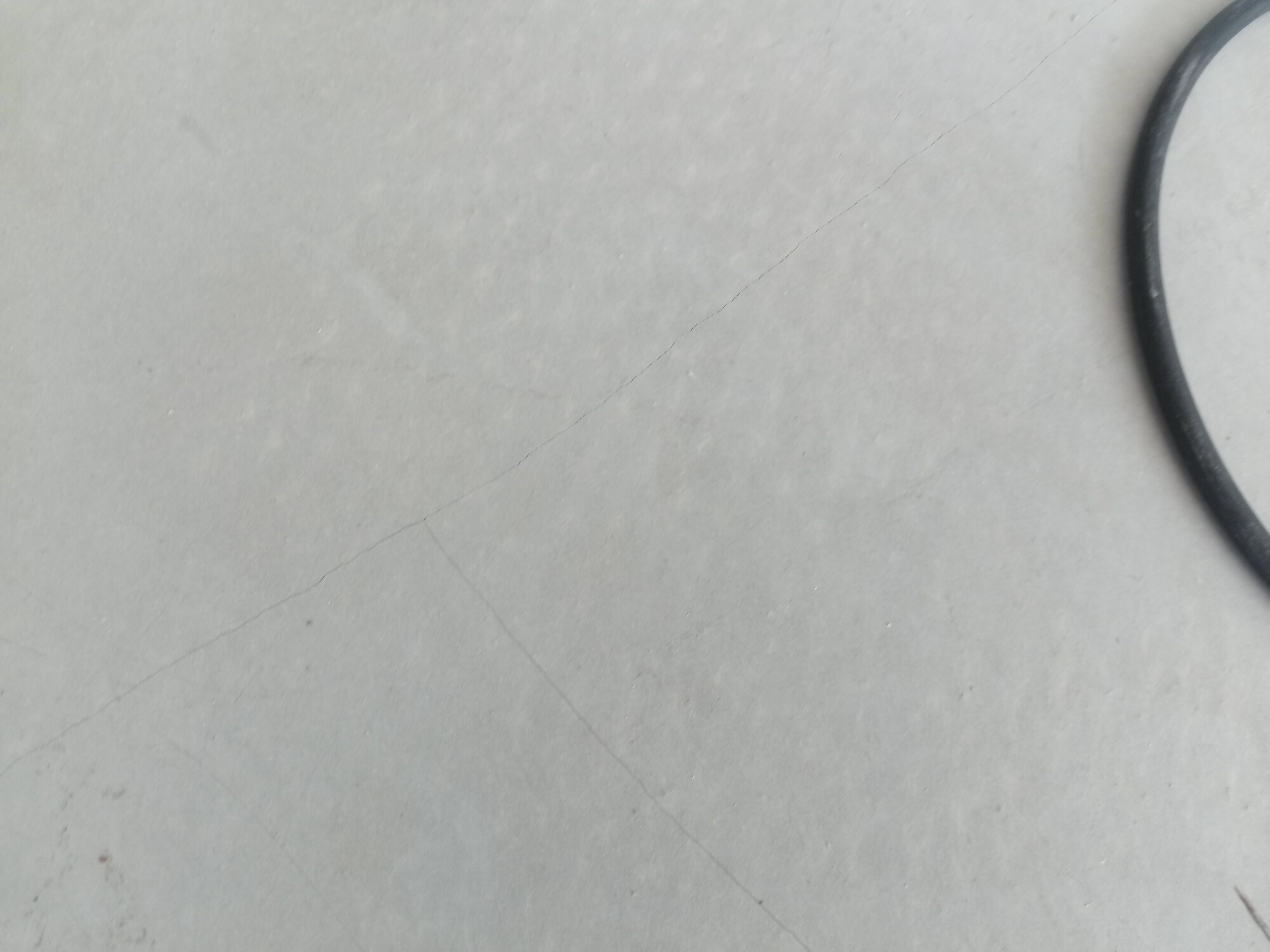

Left the floor alone for a few days to be on the safe side and then I walked on it. All seemed ok and then next day whilst walking on it again I noticed some long and also some short hairline cracks had appeared over the whole floor, these were not in straight lines and were not coming from one particular spot. As the day went on whilst I was working in the room I noticed that more of these hairline cracks had appeared obviously by me walking on the floor.

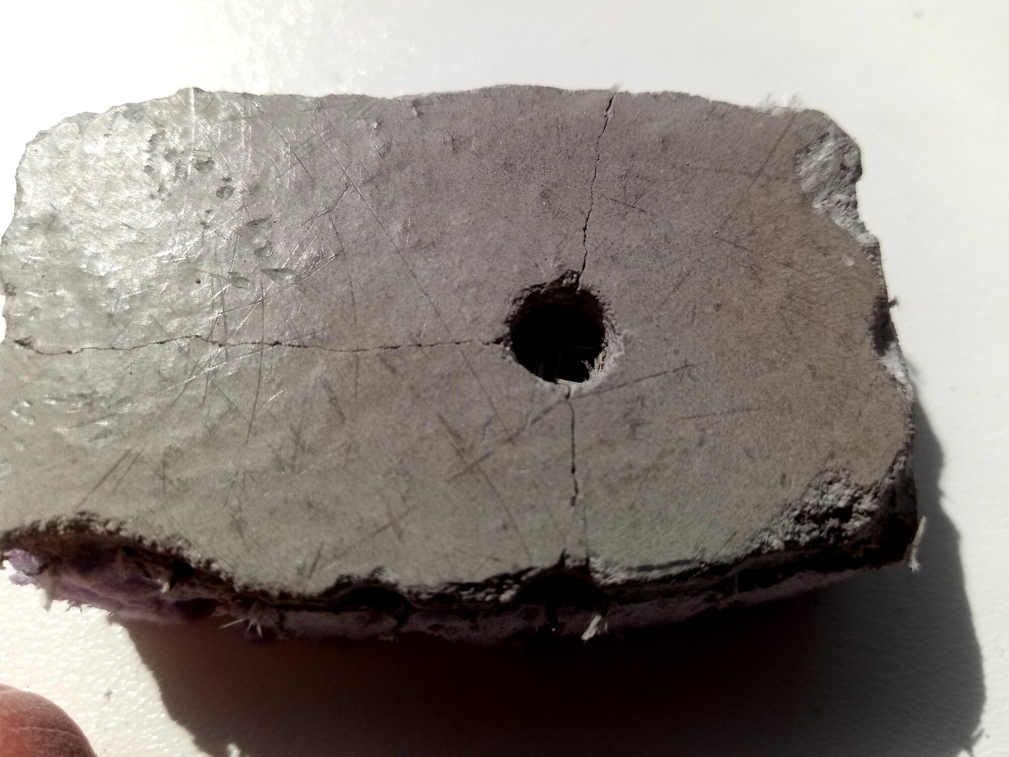

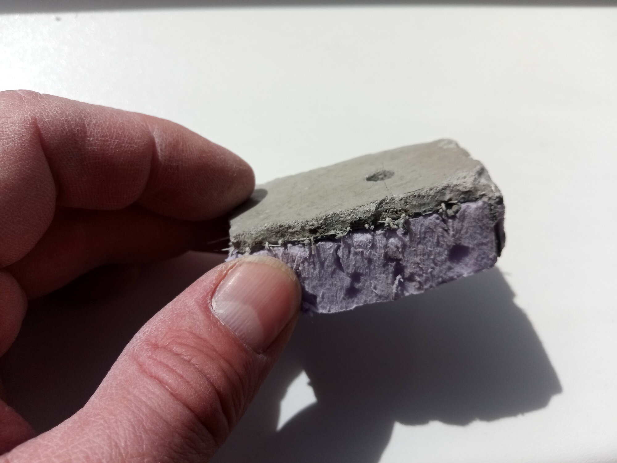

I have inspected the SLC and remove some small sections from various locations and taken photos. SLC is bonded to the boards see photo of pieces removed.
Are these drying out hairline cracks or is it because I have walked on it after 24 hours and cracked it because of thin layer on top of 20mm cement faced XPS boards?
There are about 20 of these cracks all over the floor ranging from 600-1800mm in length.
What do you think has happened here?

Ideally the floor should have been levelled in one hit, you can try taping the joints but the crack will normally appear again in the second coat. As I said the Ditra will stop the cracks going through to the tiles.
I contacted Mapei Tech Support today and they say its cracked because of walking on it as an 8mm depth of SLC on top of 20mm XPS board will give a bit so they have recommended to use Mapei Eporip to repair the hairline cracks before applying another layer of SLC. They say this stuff with bond the cracks together so making the floor strong again.
