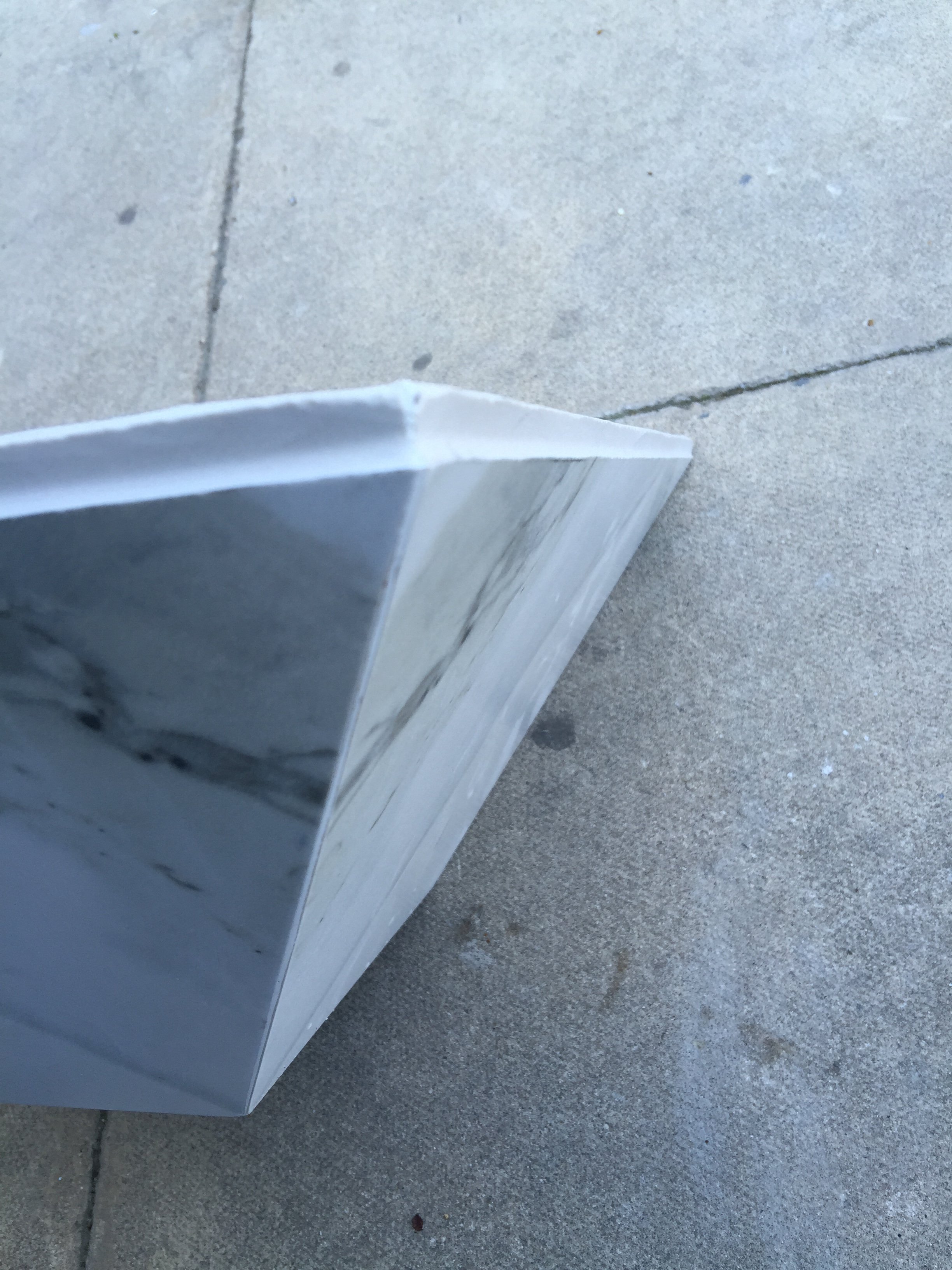

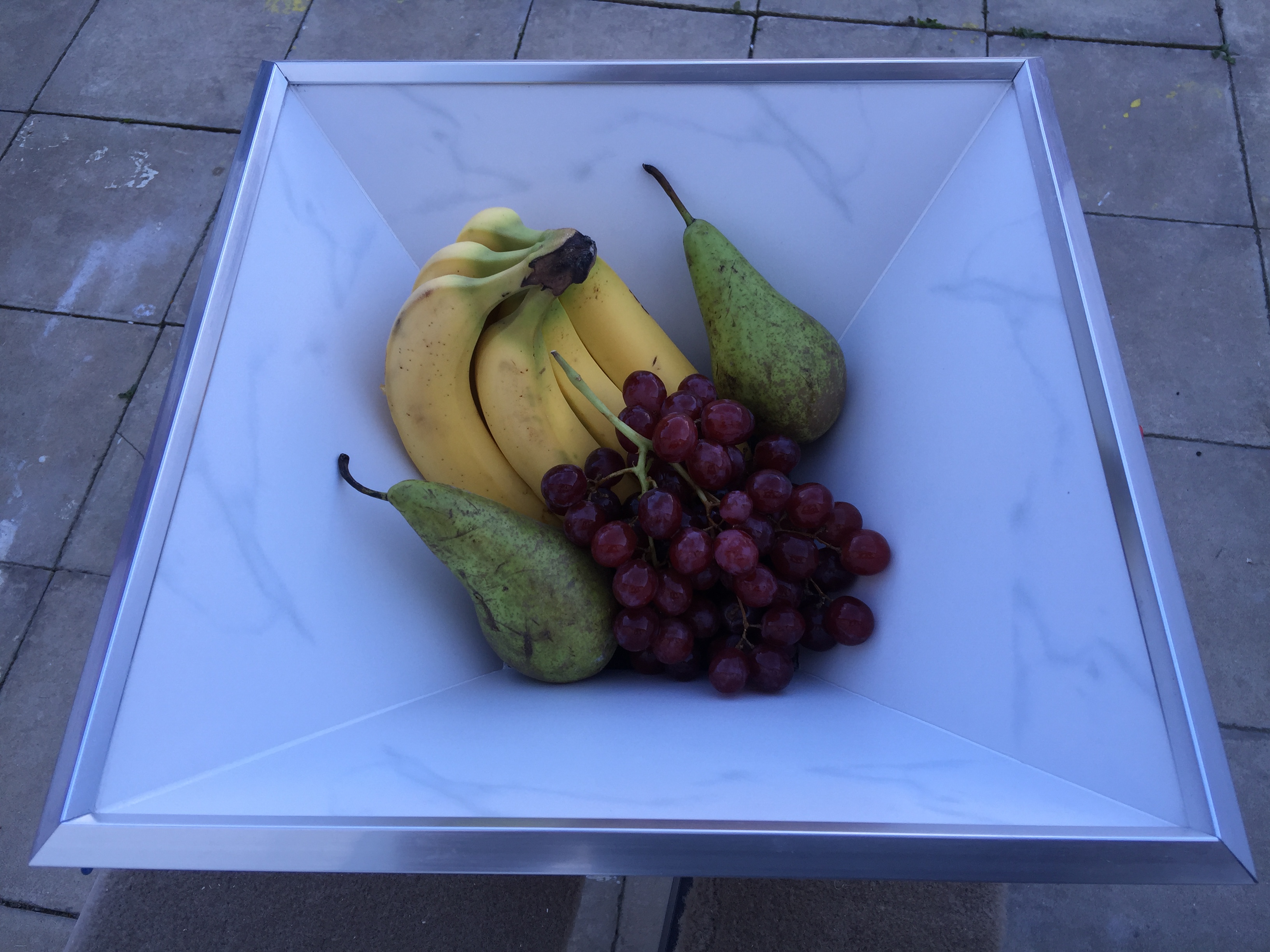

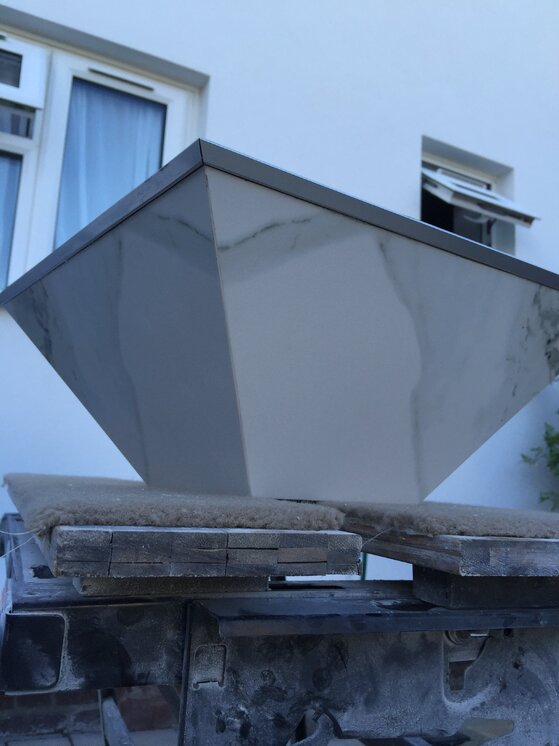

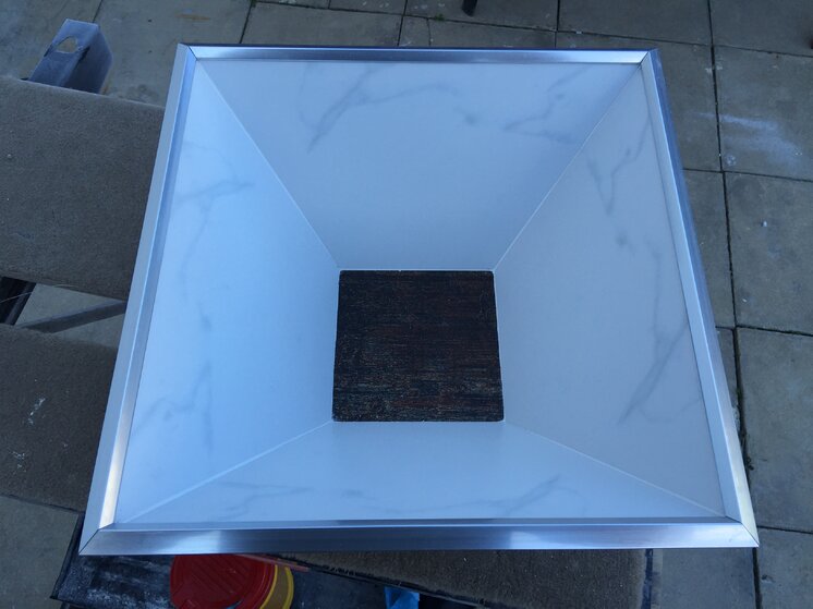

I had some spare triangle pieces spare from bookmatch job as as I can't bare to see waste......
Put this together, with the suggestion of u channel from Gary.
8 triangles back to back, with 3 mitred sides on each.
Glued with Akemi.
Hardest part was rebating the top edge by hand to accept trim as it was just a tad too tight to fit over top.
