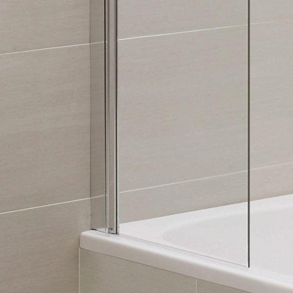

Loads of different sizes and styles of wall profiles.
Channels are mainly for the glass to sit in. Wall profiles is what they glass panels sit in.
