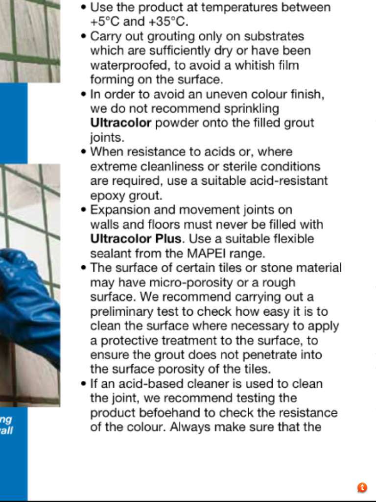

Pretty sure on some bags of grout it says along the lines of 'internal corners to be filled with Silicon'..
I've definitely seen it, but can't say which brand it was...
Mapei Ultracolour plus is one of many that do!!!
Oh, and Weber too!
Anybody care to phone their grout manufacturer to speak with their tech depth and get their opinion on it? I'm pretty sure I don't have to tell you all what the answer will be from each and every one of them!?
