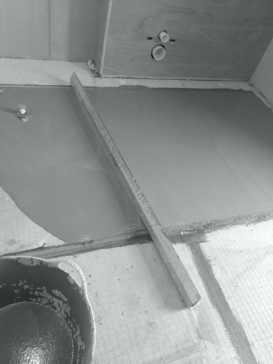

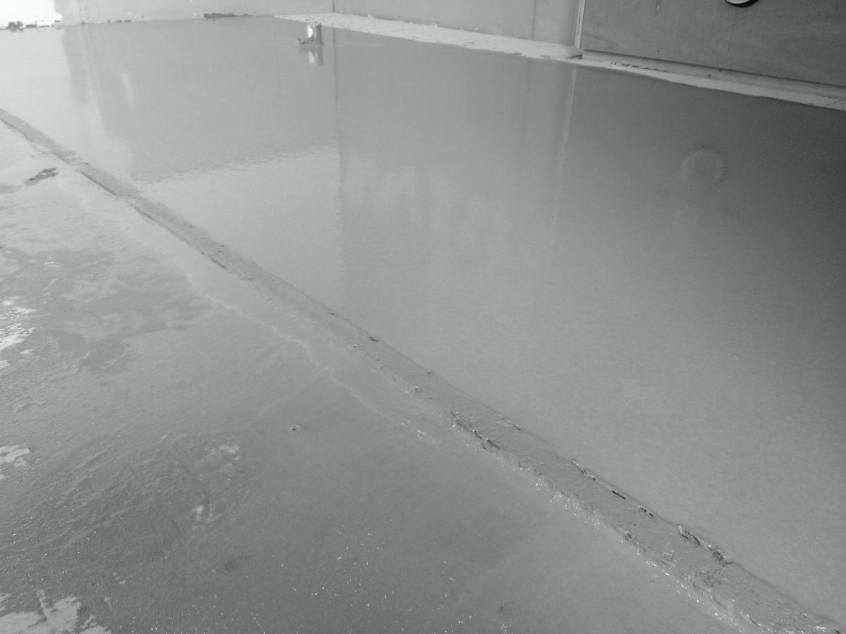

Out of interest , when you say fill with a feather edge , do you mean flood first , let set , then finish with the FE?
Sorry Diggy, I mean I fill each bay with slc then draw off with feather edge while still wet.

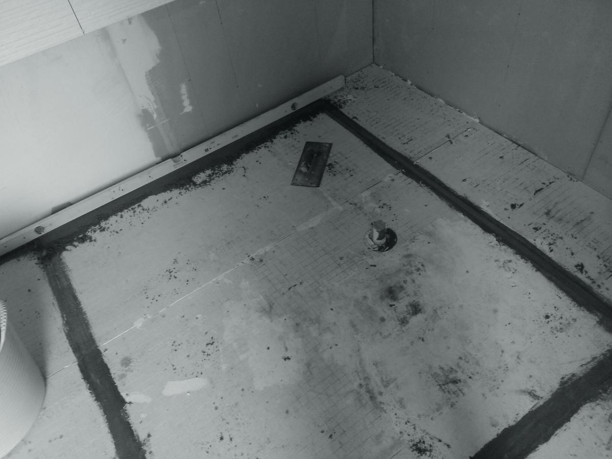

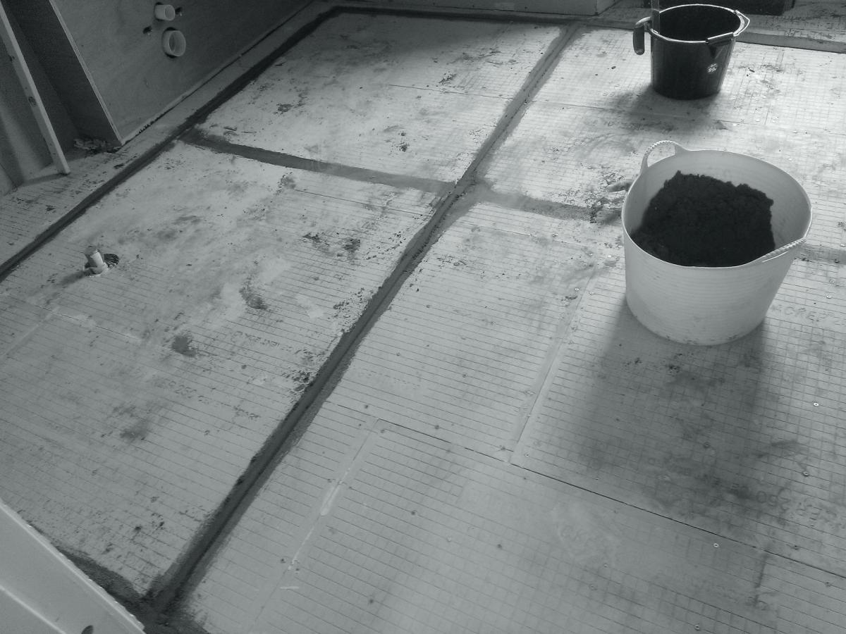

And on the note you mention...I will admit I am totally lost with what you guys are saying regards sectioning the area, also Phil I cant quite see what you are using there for runners..it looks like brass bars with solder joints, or am I missing something..when i've laid SLc..Ill admit not done a large area, i've just managed to spread as normal, pour float and work back to a doorway..I did some screeding years ago, and just dot and dabbed little mole hills with a long straight edge and worked from them..so you using the same principle ?
