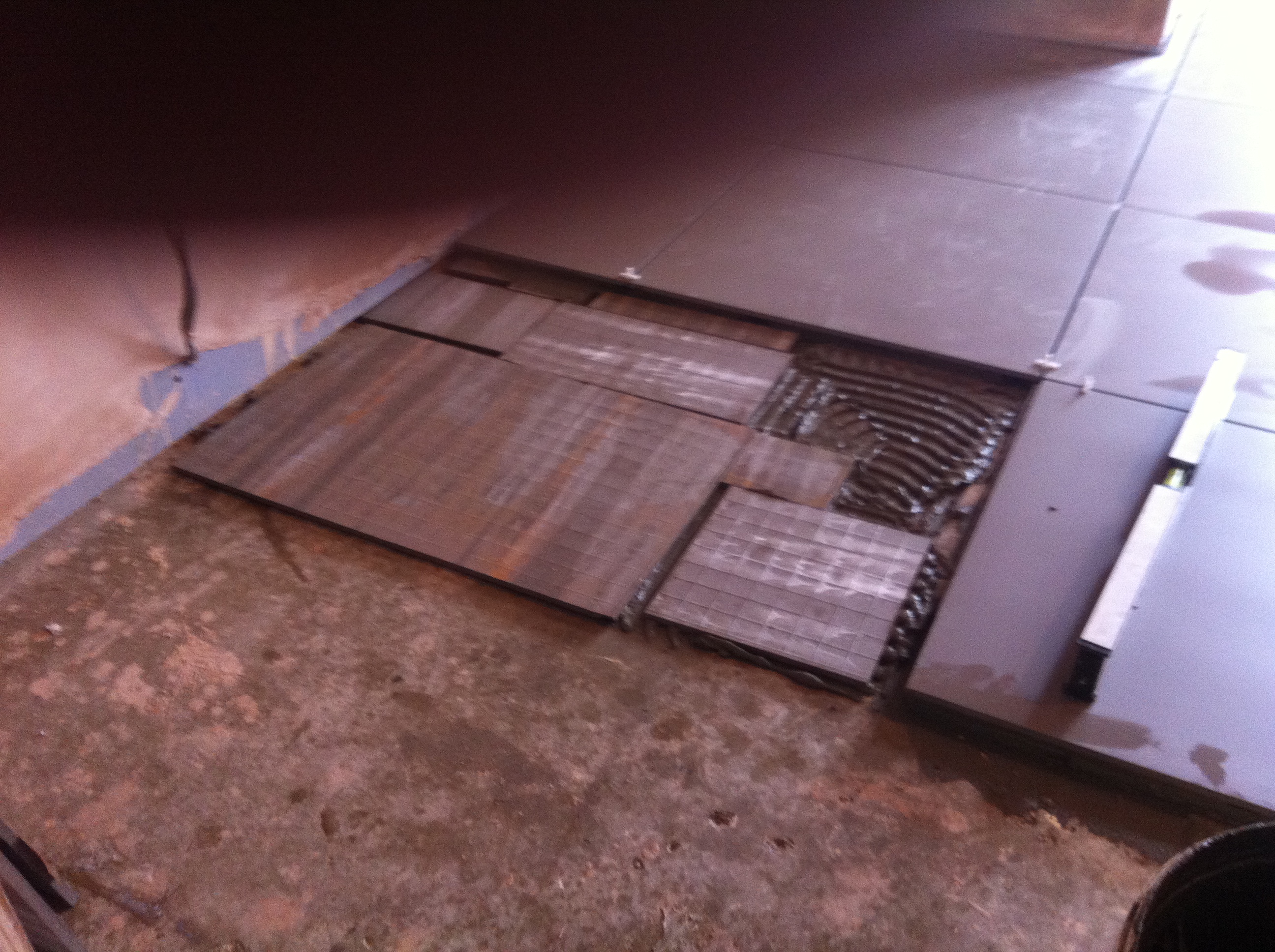

View attachment 78283 View attachment 78284 View attachment 78285

Can't see how you get full coverage in picture no. 2 looks like a dogs took loads of poo's on the floor..lol
You are Mr blobby. .Lol
I prefer the term "cow pats"
That picture was actually taken right at the moment when my addy bucket ran out, so while I was in between, thought I'd take some pics to show the builder how bad the floor actually was - believe me, more addy went in than what's on that pic, so when the tile went down, I would say at least 90% of the tile was covered.
