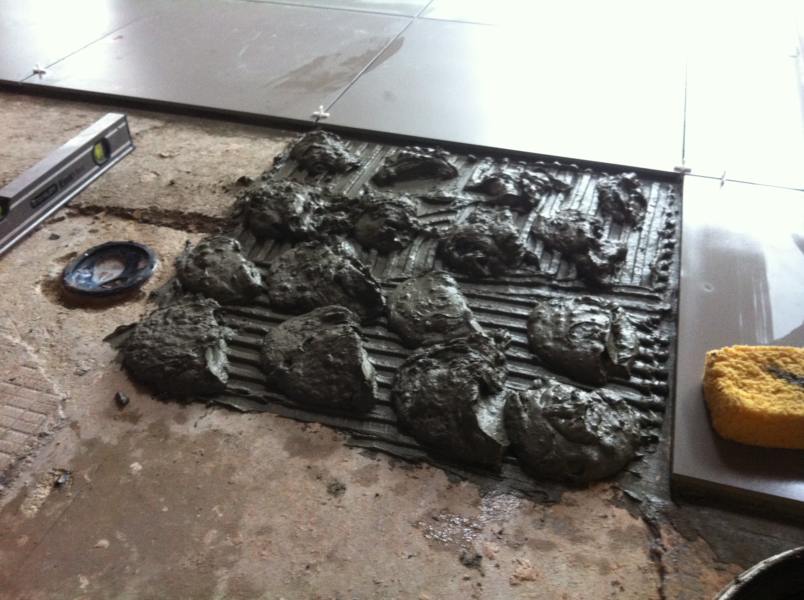

Yes Mr Blobby works well for me if done correctly, especially when you get floors like this one. High in the middle, then floor runs away as you go across.
It takes a while to master this technique though, not easy. But as long as you put enough addy down, whack the tile in place with the old rubber mallet and end up with full coverage underneath that's all that matters.

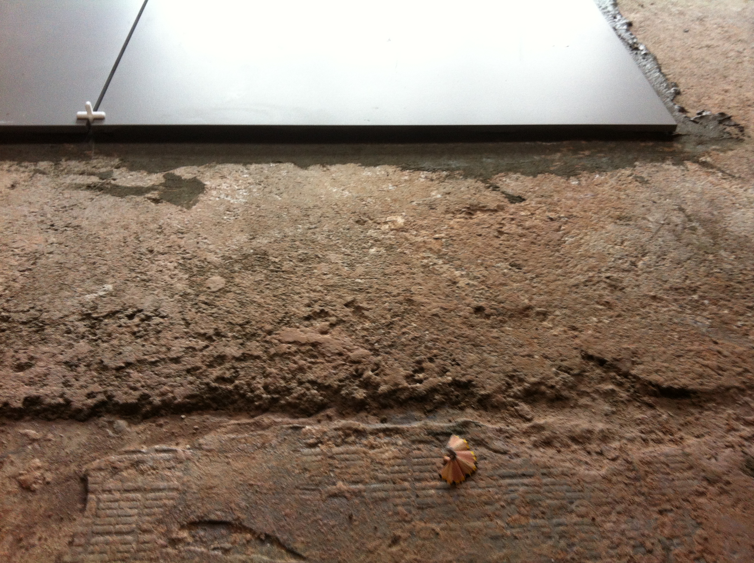

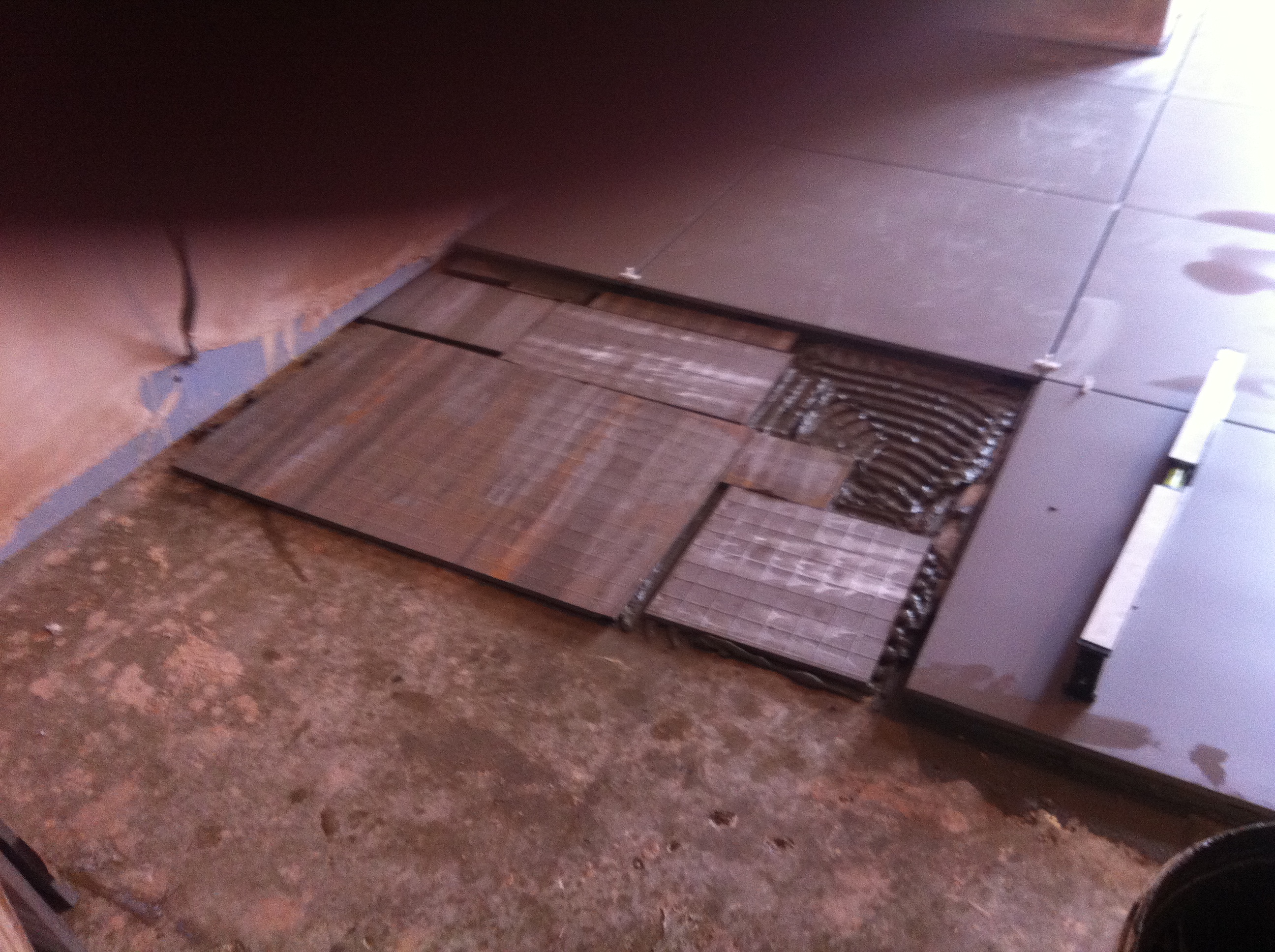

View attachment 78283 View attachment 78284 View attachment 78285

Can't see how you get full coverage in picture no. 2 looks like a dogs took loads of poo's on the floor..lol
I prefer the term "cow pats"
That picture was actually taken right at the moment when my addy bucket ran out, so while I was in between, thought I'd take some pics to show the builder how bad the floor actually was - believe me, more addy went in than what's on that pic, so when the tile went down, I would say at least 90% of the tile was covered.
