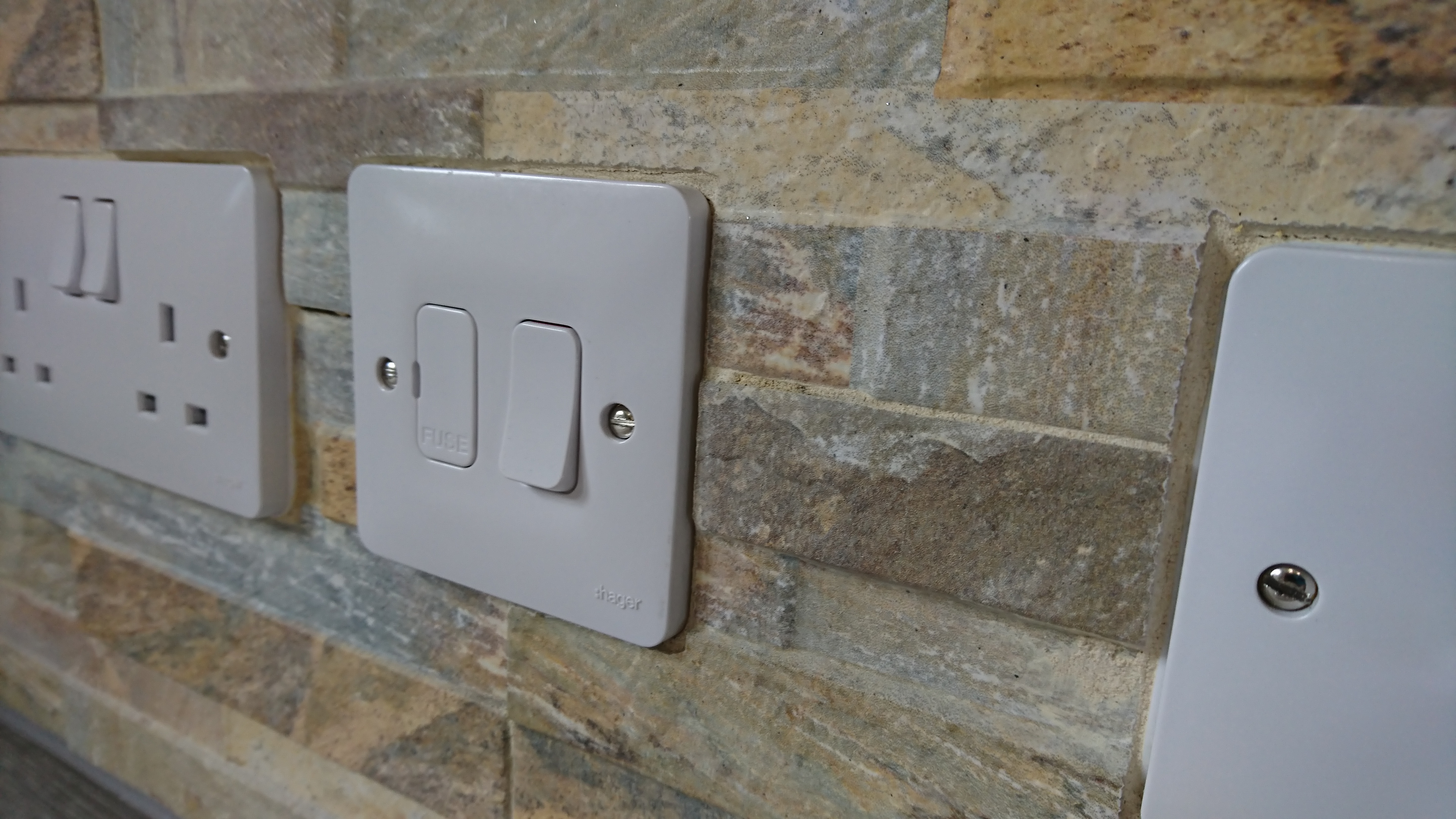

I put a spacer behind the socket/ FCU and cut the tile to that.
Like this.
dg-1984
15
288
Glasgow
Like this.
Like this.
