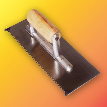

here is a carbide tipped trowel....old school full bed trowel for those that have never heard of it.......almost the same principal IMO:
I could never see how these trowels worked as they put no key onto the floor, yes you got the floors flat, but there are no teeth to bite the adhesive into the floor, quality leveling compounds seem to key themselves in.

what I ment Bugs was.........if you used SLC and spread it about with a carbide tipped trowel.....the effect would be the same....IMO.......you are "pushing/ pulling" the slc to a fixed depth....and therefore by proxy you are following the floor.......but the slc will "smooth" a bit..............I am better off with my method........of trowel, roller, screws, datums etc............what with these new 50mm latexes and all!"!!!!
