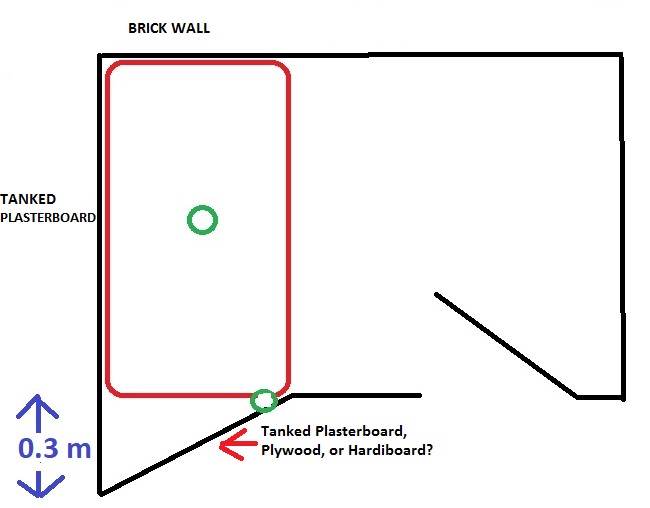

Below is a plan of the bathroom, showing the locations of the bath, and one overhead shower and one wall-mounted dis-mountable hand-shower.
As I've indicated on the figure, there is a brick wall at one end, the side wall is a stud wall which will be plasterboarded and tanked.
What about the short wall on which a hand shower is mounted (this open alcove runs floor to ceiling)? Do you suggest?
a) Tanked plywood sheet
b) Tanked Hardiboard sheet
c) Tanked plasterboard sheet, with a timber frame directly behind the hand shower
d) Other
Is the shower backing onto a stud wall or airing cupboard?
I just saw your post after I posted the above. It's backing onto a stud wall (on the landing - top of the stairs).
A structural waterproof tanking board such as wedi, schluter, marmox, orbry, jackoboard are the better choice.
By "structural", do you mean these boards have some inherent strength to them (unlike plasterboard) so objects such as hand showers can be attached to them
Yes, but to fix items to the wall you will still be better off with some structural support. You are fortunate that it's a stud wall. You can always use CLS timber inside the stud wall to provide the support you require. You will be absolutely fine using tanked plasterboard with timber supports inside the stud wall.
In short, C 😀

I found out that it is possoble to purchase Schluter Kerdi-Board locally. In case that was used, I suppose the 9mm thickness is the one to go for to adhere tiles then a hand shower to? Do you think this would still require some structural support (i.e. timber frame)?
I would still opt for timber support.
