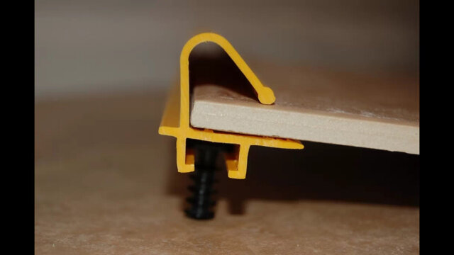

Ever get the day when you measure for a cut tile and it takes more than one try,or you have left your glasses at home and the room is dimly lit.Well help is at hand.
Tile clip pro is on its way with a patent pending but needs some feed back at this time.
If the following attachment goes right you can see what it is.
All the members of this board have my permission to make a home made version
to try it for them selves.I use perspex heated up and bent into shape.

Howether the tile clip pro is invented by ac working tiler and it comes in different sizes and thicknesses at the base so you can choose the sizo of the cut you want to make
I have just spent half an hour writing a long post and lost it all.1 more try

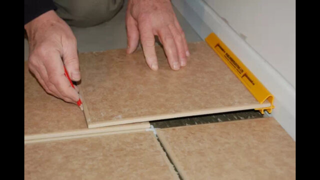

usuall methods of marking a tile to be cut is at best guess work.You press one end of a tile against the wall or skirting board or cupboard and mark that tile to whatever gap or space you need.
The tile clips have built in spacers that when slipped on the opposite side of the tile(top left corner then right hand corner)to be marked you no longer have to guess the cut.
1 2 3 cut 1 2 3 cut simples

There's no guess work when cutting a tile, if I'm using a 3mm spacer then I measure gap front & back that tiles to fit into & take 5mm of off the size,
3mm for spacer 2mm for expansion, simples.
Without wishing to be rude , and as Andy says , a decent tiler just wouldn't bother or need to tbh.
A Pencil and my tilers eye does the trick usually , or as mentioned above , a tape allowing , joint + expansion , is all that is required imho.

Thanks Stef,they will be out in the new year I will send you a set and hopefully you will give me some feed back.
Have you got a prototype? I'm struggling to work out exactly how it works.
prototypes are too crude to send out,production starts in new year will post vid on youtube as well as directions on packet.
