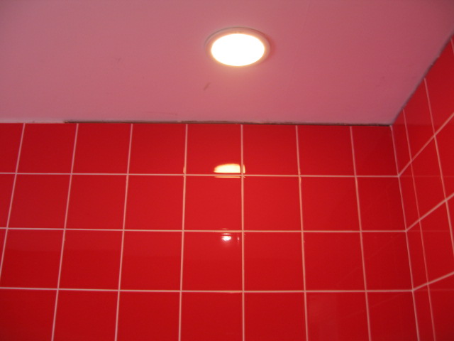

My tiler has messed up the tiling in my en-suite. As per the pictures along 3 walls there is a gap between finished tiles and ceiling. One wall is ok as this is the one (only one) he took his measurments from. The gap is probably 2-3cm at the biggest.
In addition the other picture which I am not sure if you can see clearly shows the finish around the window. Again gap left which is bigger at left hand side and tails off to right hand side of window.
Now my questions are what would be the best solutions to these 2 problems? Secondly how would you approach this with the tiler? From what I can see these are basics for a tiler and all walls/windows etc should be measured to avoid this happening.

apart from starting again you could possibly put coving round the ceiling which would tidy that up and either re face round the window with plastic like it is in the inside of window or possibly an right angle piece of either white plastic or chrome, b and q sell stuff

Its a real shame that this has happened.The main problem is that the red tiles and white grout show every detail up, he has set it out wrong, but the rest of his tiling looks nice and flat (no help here though).
Really he should have stooped when he knew he'd cocked it up and taken the tiles down.
So do you want it all retiling or make best what you have??
The above coving idea would work to sort the ceiling, you wouldn't know there was a problem if done. As for the window, no window reveals are ever totally true so tiling like that up against them without tiling an internal return was never going to work, again maybe a thin right angled piece of plastic trim would solve the problem, these only cost a few quid from B&Q so it would be worth looking at.
I think this is salvagable, unless (and it is your room afterall) you want it perfect, in which it all has to come off.
To be honest if i'd cocked a room up i wouldn't expect to be paid at all, it's better than pulling the lot down, buying new materials and wasting more days labour.
