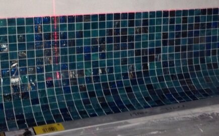

To form the basic shape use plaster coving then blend in with adhesive.Very nice that's what I was looking at trying to achieve but what would I use to form the curve off the floor ....it's in an upstairs bathroom..
Cut back of cove off so that the leading edges of cove are virtually flush with the wall and stick and support with tile adhesive.Ok...
it would need reinforcing behind as there is a void behind the cove...but I get the idea...

to be honest never tried an external corner myself, maybe miss tiler has?This is what I was initially thinking about but was concerned as how the corners are finished and if you do start to form the curve around the base of the wall how does it look for external corners to keep the flow of the shape?

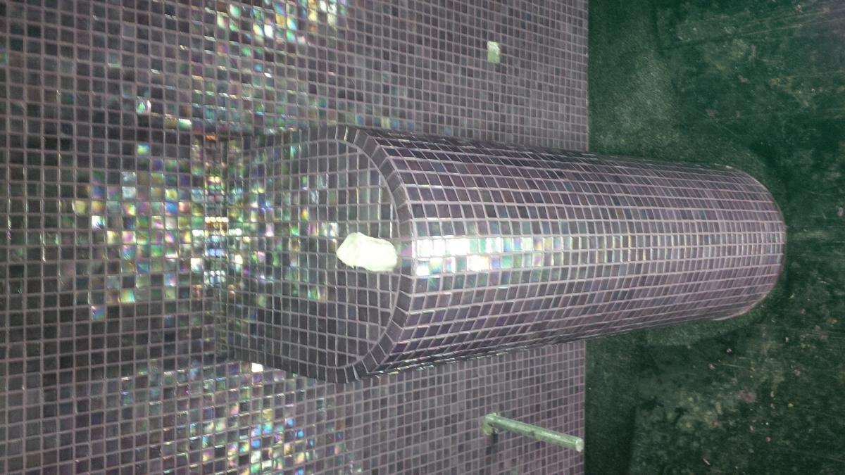

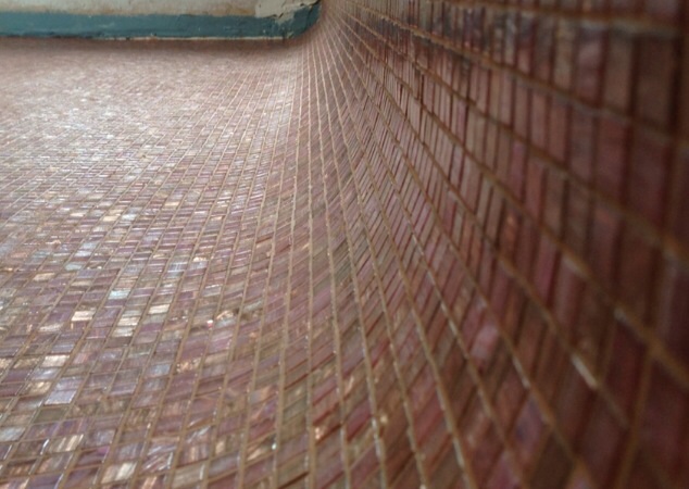

Have a look at my JOTM entry this month and it may answer a couple of your questions.
http://www.tilersforums.com/150-job-month-forum/73334-please-vote-jotm-april-2014-a.html
one question how did you finish the end of the curve where it meets the glass and upto the door did you tile it? I couldn't see in the pics.....

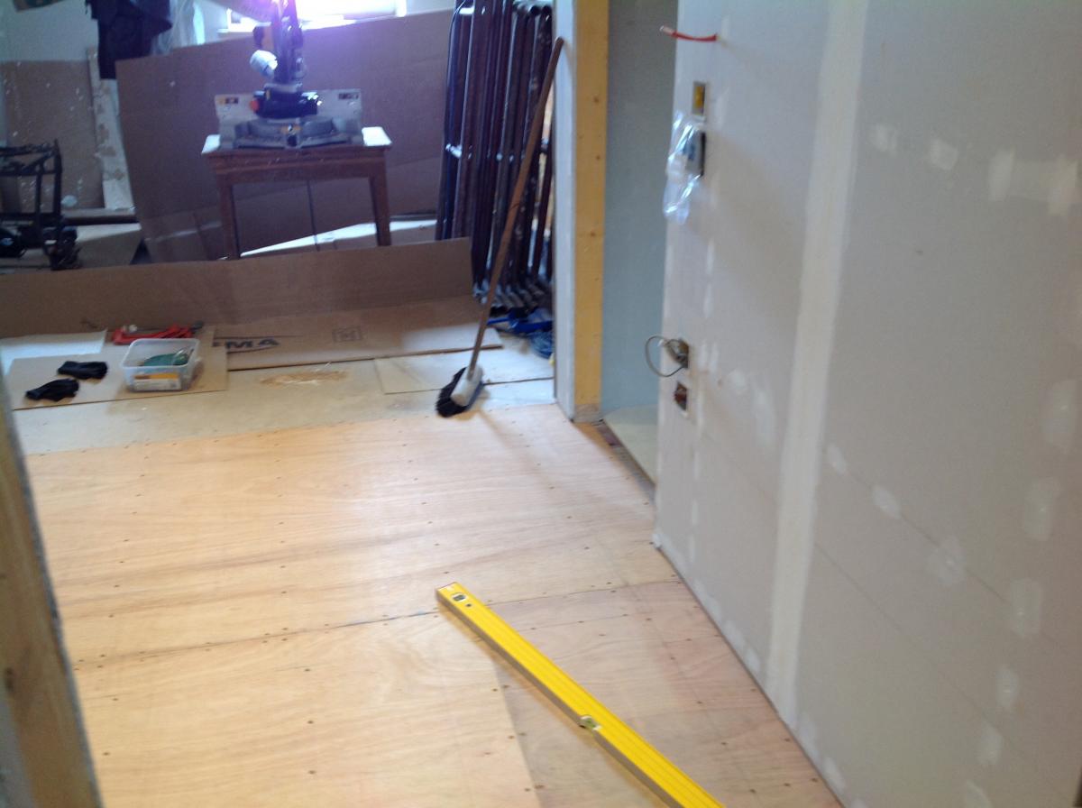

Incidentally our master bedroom has a dressing area off our ensuite which we are planning to tile the floor in these areas the same do you recommend a tile break at the door threshold or would you tile right through as this is what the wife is asking for....
The floor is 25mm ply with 6mm tile backer board and will have electric UFH mats in both areas.
personally for me, I wouldn't. I would probably try and get a grout line as close to threshold as I could tho. And as long as all the floors are made up of the same materials with no difference in expansion and contraction rates. I would think it'll be fine. I'd put u/floor heating down SLC over entire area add Ditra over that and tile. As memory serves, Schluter recommend putting their product as close to the finished surface as possible. There may be other thoughts on here, but that's the route I would take.
