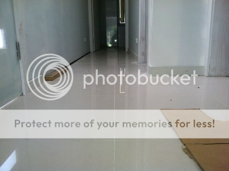

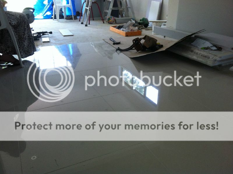

Ok got some pics for ya
This is the hallway leading to the rooms, main entrance is on the left
This is from the entrance looking toward the back where the lounge will be (stuff that has to be screeded is the section that is lower)
