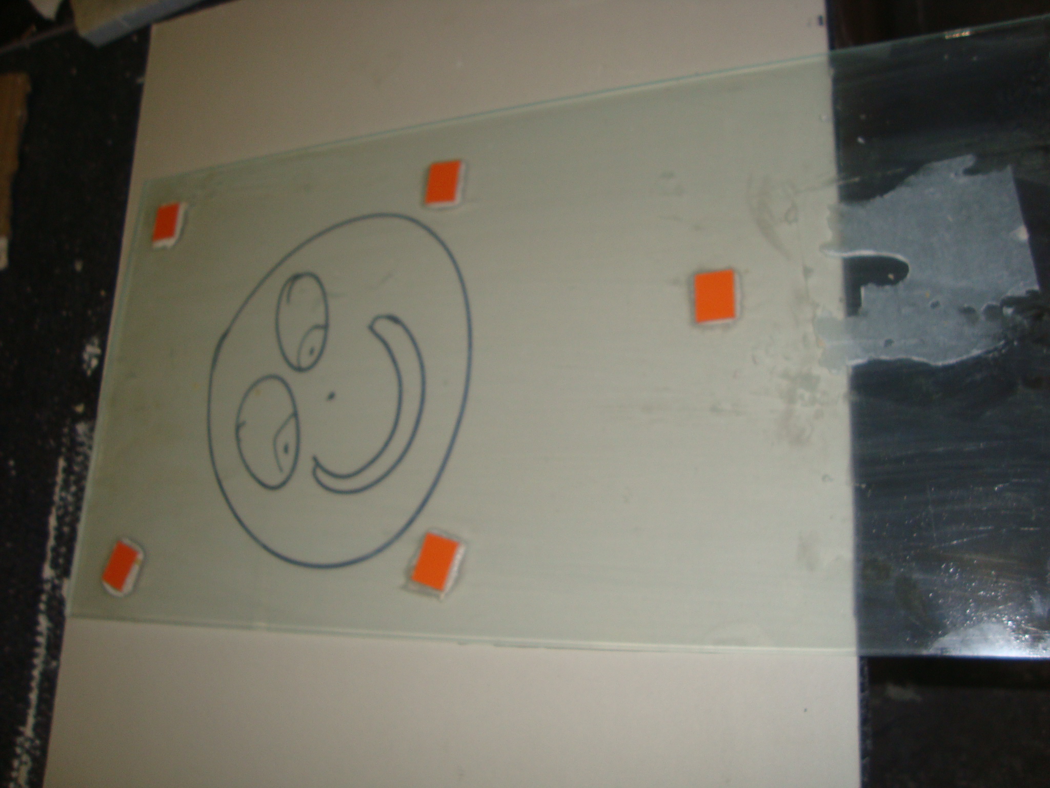

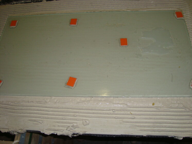

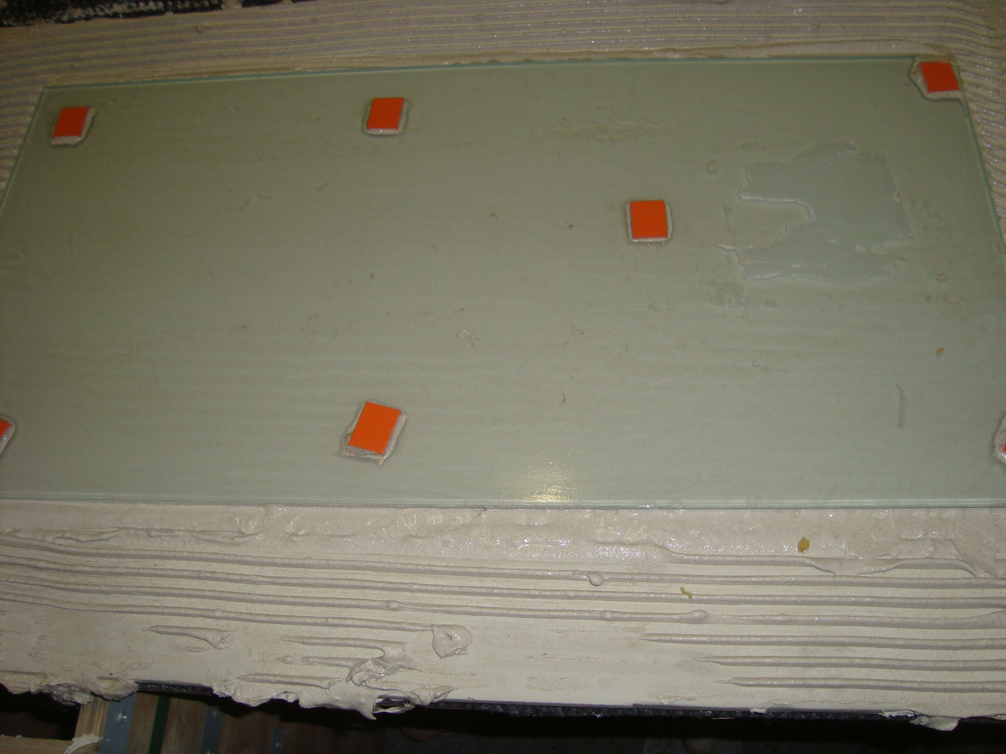

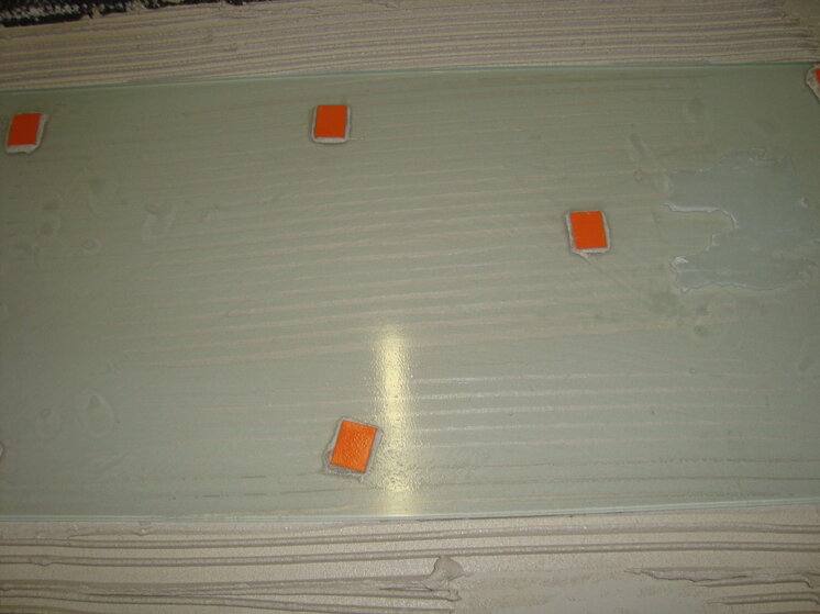

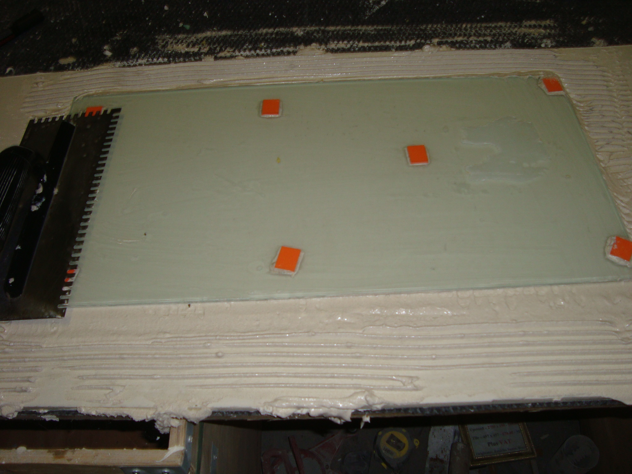

well my tip would be every tiler should add to there tool kit a peice of glass to there tool kit 600x300 x6 how many times do you turn up on site and the client has bought the adhesive you need to know how this works .i will show you why tomorrow with a few pics
here are a few pictures of using the glass with the same trowel but every trowel will show
different results just like adhesives
pic 1 smiley face
pic 2 adhesive a normal knock up for floor covarage about 85%
pic 3 adhesive a little cup more water covarage about 96%
pic 4 thin back butter tile same adhesive as 3 100% covarage
its a simple 5 minute test on any adhesive might save you a lot of trouble
pic 1 smiley face

great Idea mate anything over300x300 I skim the back of them and your demo backs that up!!!
