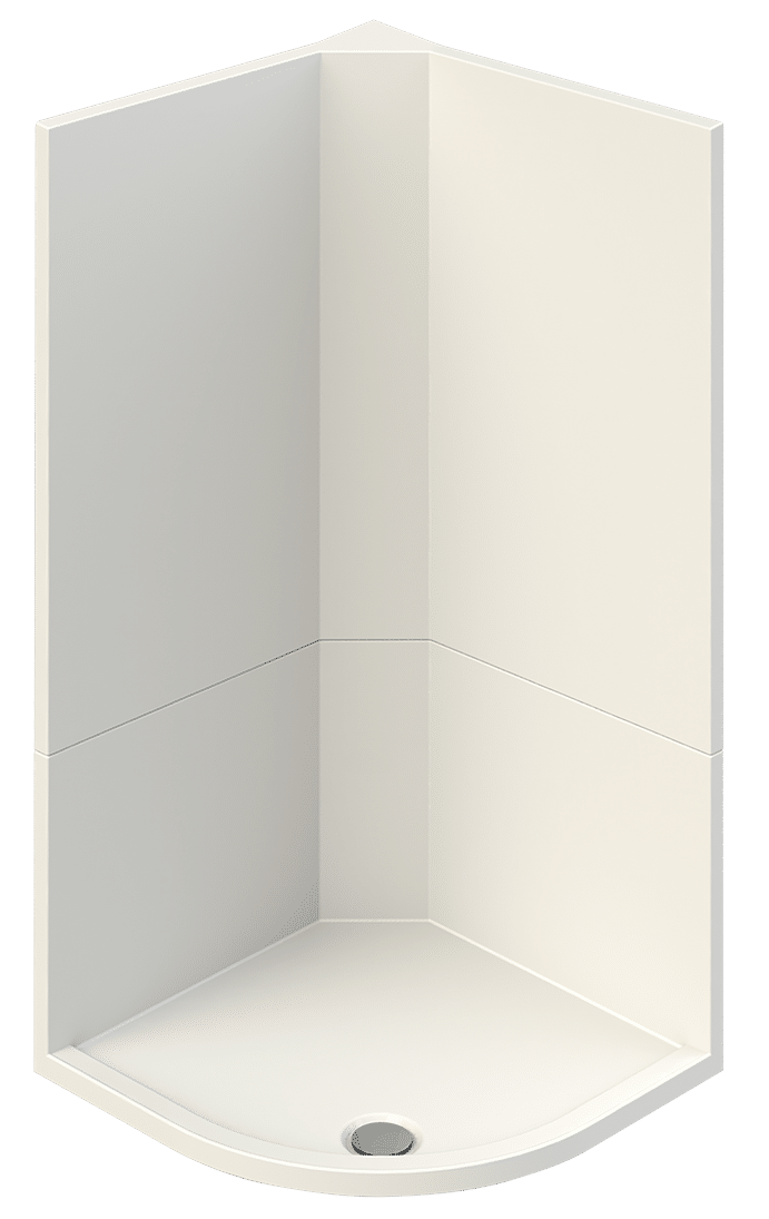

But I have a shower pod and with the size of bathroom it is it’s just not possible to remove, in fact with the pipe work for sink I’d say it’s impossible to remove shower which means it’s still chipboard under shower and plasterboard directly behind shower, so I find it hard to justify tanking
This is my shower, so you can imagine plasterboard behind it and chipboard under,
But for £50, if anyone can give good logic still to do it then I’d be open to it
Definitely no need to tank behind a shower pod.
