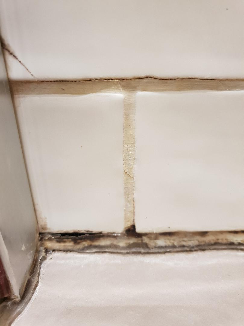

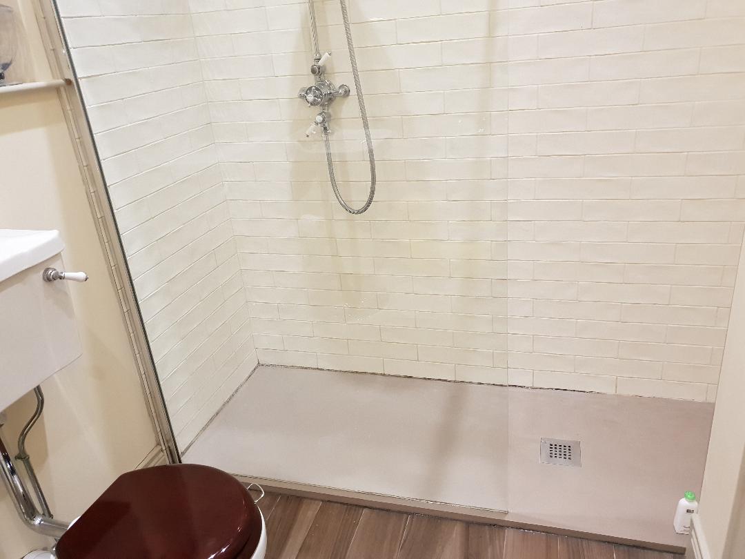

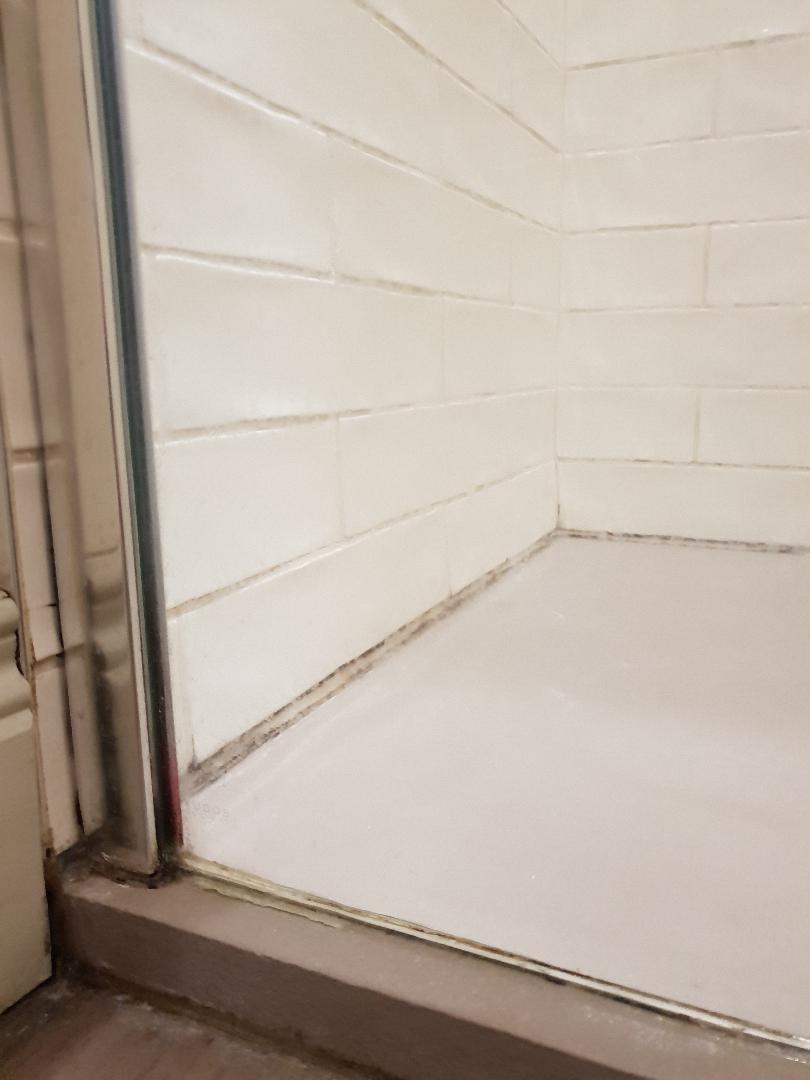

Hi there, we fitted a large Fiora shower tray into our upstairs bathroom a few years ago when we got the house refurbished. (pics attached) Problem is the weight of the tray has caused it sink into the wooden floor beneath, creating a 1mm gap between grout and tray and leaking a lot of water into the room below...
We had our tiler out to take a look and he is recommending a Silicon fix with a plastic trim added to protect the area...
He has done excellent tiling work for us, but we are just a bit worried as we need a fix that stops the leak completely - for good!
These are the products he has recommended...

Looking at the pictures again and it looks like it's dropped more than 1mm, it's been leaking a long time and has been "repaired" before by the look of the Silicon.
Do you have any pictures of the room stripped out?
Looking at the pictures, you have a cracked tile, a cracked grout joint and a tray that has dropped.
