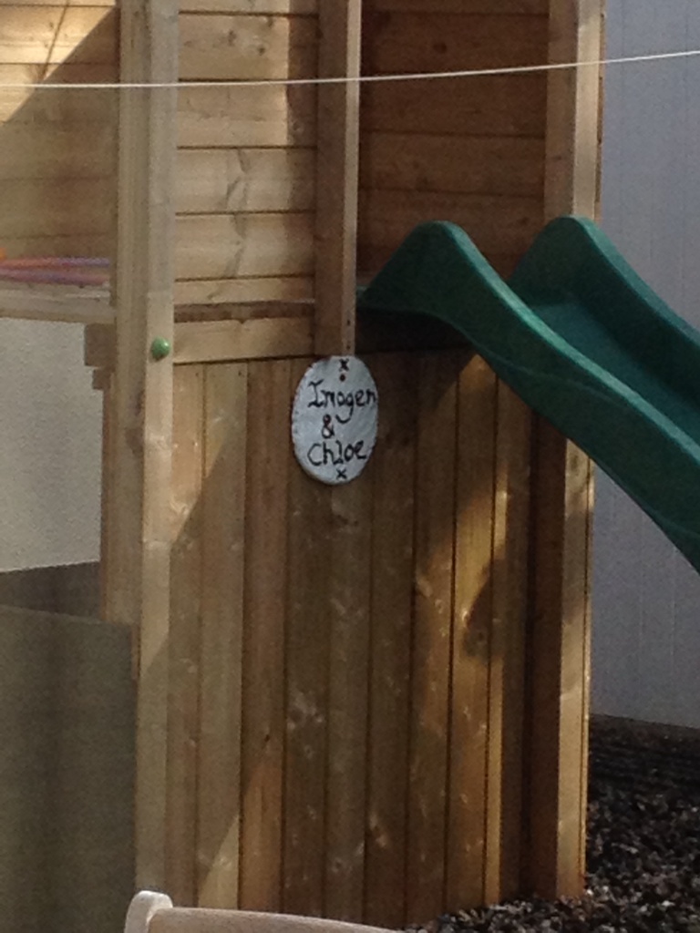

Funny, I've been thinking of doing something similar recently. I've always made little "plaques" out of left over grout for my customers or do them on site to take home for my daughters! A bit of fun, but they love it Customers with young children love making handprint plaques!
Here is one I did recently and fixed to my daughters play house. I painted it in masonry paint as the mapei cement grey grout was a touch drab! I just use a tile spacer or rubi wedge to scribe the letters out.
I'm often making little people and characters out of left over adhesive too. I've made a few shed doorstops out of left over addy which resembled a hedgehog.
