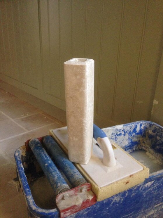

I have a few Stef, Montolit Master Brooklyn, De'Walt, Norton clipper but for mitering I use a battered Vitrex, and that's all I use it for, just find I get the best results with that saw.
Have you got any other photos of anything you have made out of stone?
Or has anybody else made anything?
Rainer will jump onto this if he sees it, he is an absolute master.
The methods not that difficult, cut four pieces of stone exactly the same width and length (the lengths not to important as you can always trim the vase at he end) put internal mitres on both the long sides and the bottom of each piece.
Mix your resins to match the stone, and glue the four pieces together at right angles to make a the body of the vase.
Using this as a template, place on a piece of stone and draw around to give you the size of your base, cut this piece and put an internal miter on every side, mix your resins and stick to the body of the vase.
You now have your vase, all you have to do now is polish up the mitres, chamfer the top etc, the finished result will depend on how good you are with a flex.
Here's a photo of an external corner in one of my bathrooms, if someone can flip the picture, much appreciated.
I have the Makita polishing kit from ATS, but I'm a long way from good with it (hence all the off-cuts in the garage lol). I use the Dewalt for stonework, but I've yet to figure out how to get a useable mitre with it!?! Because of the arm, the only way I can see of doing the mitres, is from the back, which just blows the front edge out!?! I guess I've either got to find another cutter for this, or just learn to do it free-hand, with a grinder..
