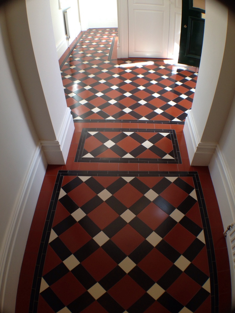

Here are a few more pics.
Just realised there are 2 tiles in the path that are sticking out by 2-3mm!
He did mentioned some tiles are uneven so naturally not all will be compeltley flush but 2-3mm is allot!
20160512_222931.jpg 20160512_222924.jpg 20160512_222920.jpg 20160512_222900.jpg
I have just taken more pics at the best angles possible so you can see what the tiler meant by uneven tiles. Should I expect it fully flush or is it very difficult to get them completely flush?
20160512_223906.jpg 20160512_223904.jpg 20160512_223838.jpg 20160512_223806.jpg 20160512_223730.jpg 20160512_223726.jpg 20160512_223722.jpg
The tiles are 100% NOT uneven. He clearly has no experience with geometrics and has no right to describe himself as a tiler. I've seen better from handymen and builders.
Sorry but that is a terrible mess of a job.
After all your previous posts trying to prepare for a good job it must be disappointing to be in this situation.
I would assume you checked his portfolio prior to contracting this 'tiler' but this is work well outside his skill set. Basic mistakes are evident in the setting out, and the border is a complete mess.
Not sure if anything can be salvaged from where it is at present, but it's never going to look a professional job.
And it would have been so easy to pull a mix of Ardex K301 down the path with a level...bloody shame 🙁
