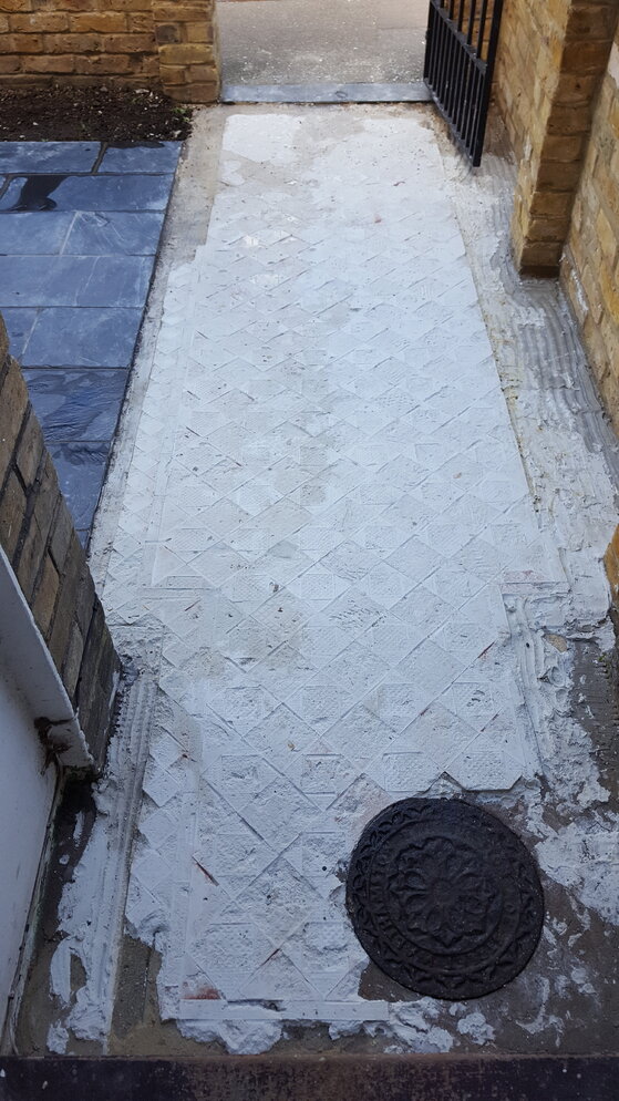

O my god,,this is what the base prep needs to look like before dry laying/ tiling commences.
The tiler may be trying his best, but you have spent allot of money on those tiles..These jobs should not be taken lightly.
Once again.. Preparation is key.. Path should have been pulled off first...
May be able to take up the lippy ones and rectify....to make it look better.
Victorian/ Edwardian pathways are always tricky and really should be left to those who can.
Tell your Tiler your not happy and make him rectify.

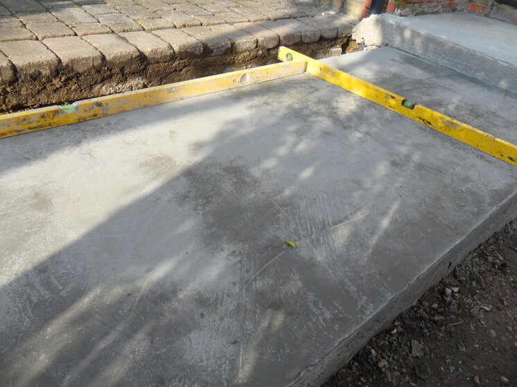

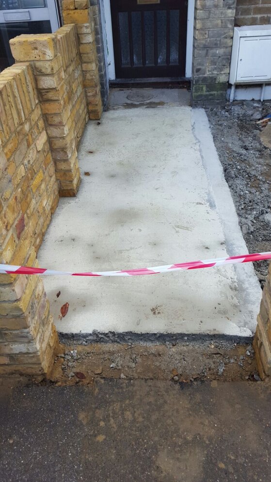

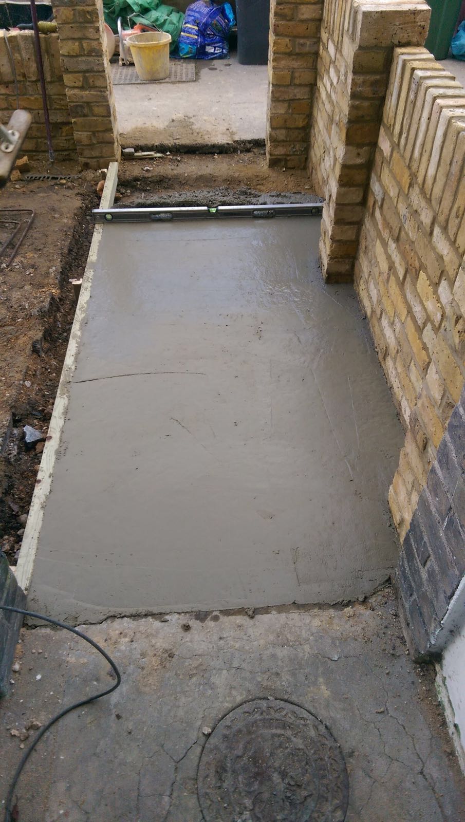

Attached are the pictures of the base as it is now and what is was like prior to when the tiler had touched it...
20160515_135741.jpg IMG-20160515-WA0001.jpg IMG-20160515-WA0002.jpg 20160515_130646.jpg
I think you have got a very satisfactory result concidering the cirxumstances.
The person who comes to do the job properly will probably remove any loose adhesive then level it all off to create a good base to tile on.
Get some one reputable in and put it down to experience
