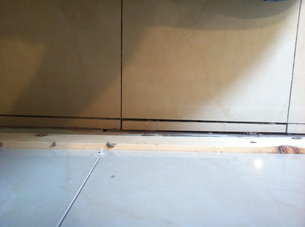

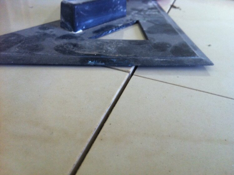

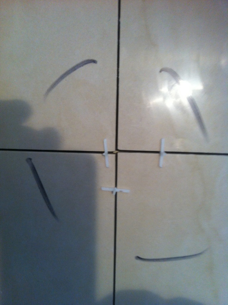

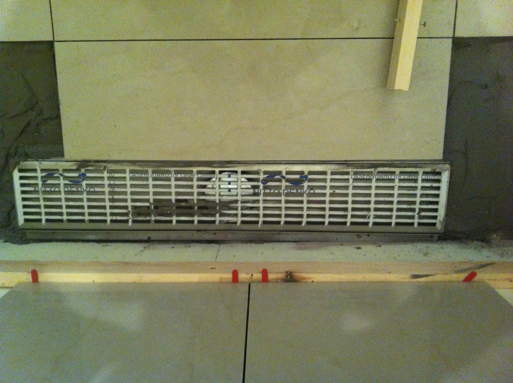

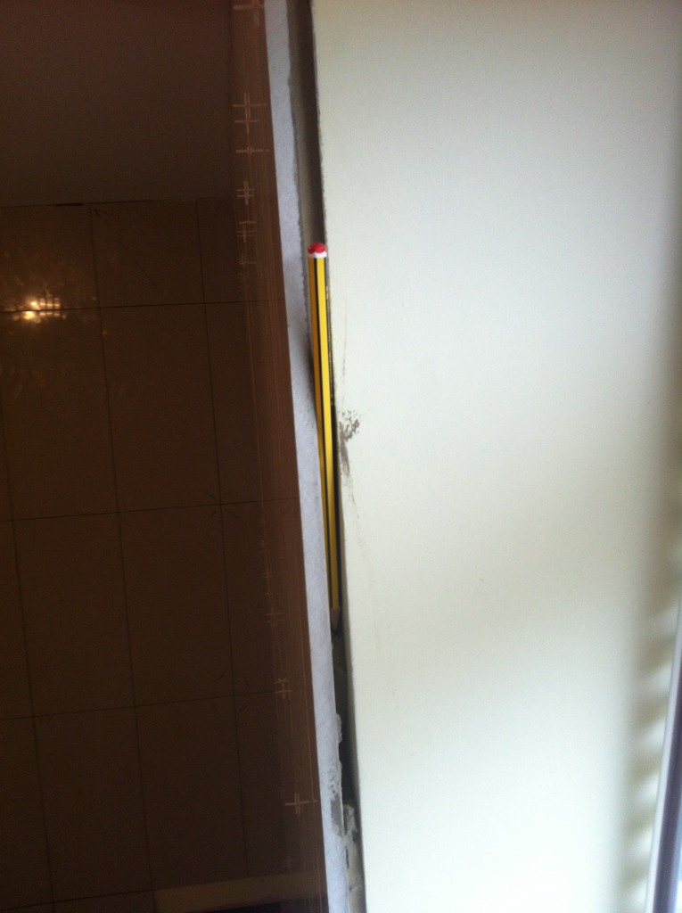

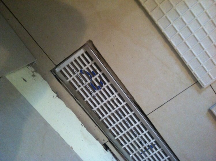

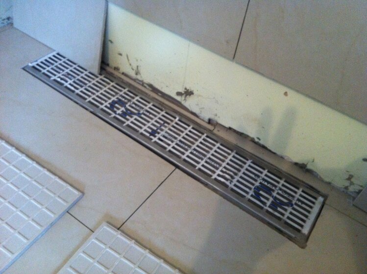

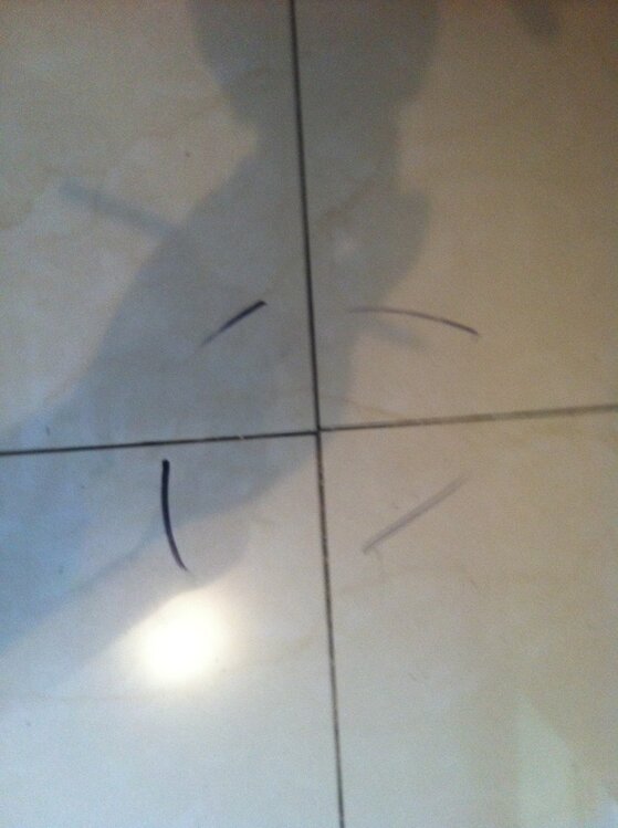

well i have been out and it is megga rough... joints are 1mm and all over th eplace and more lippage than mick jagger.
2 wetrooms on to gyvlon and NO tanking what so ever.. tiles are all dot and dabbed and and big gaps to ceiling cuts and wonky corners and lippage..
bare with me as i post the pics from my mobile..
2 ticks..
DHTiling

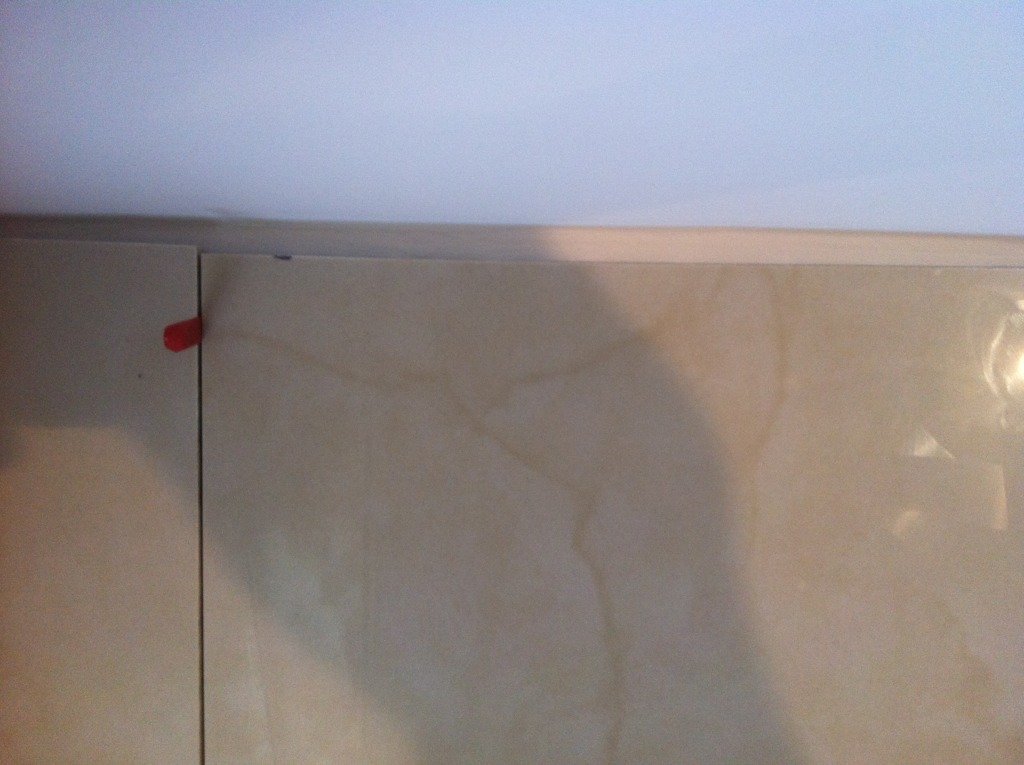

As you can see in first few pjcs , cuts to the ceiling are appalling.
This is around 120 Mtrs floor and possibly 40 ish walls.
DHTiling
I can't understand how anyone can turn out work like that and think its acceptable. What a turd! Feel sorry for the customer and I'd shoot the builder too.
