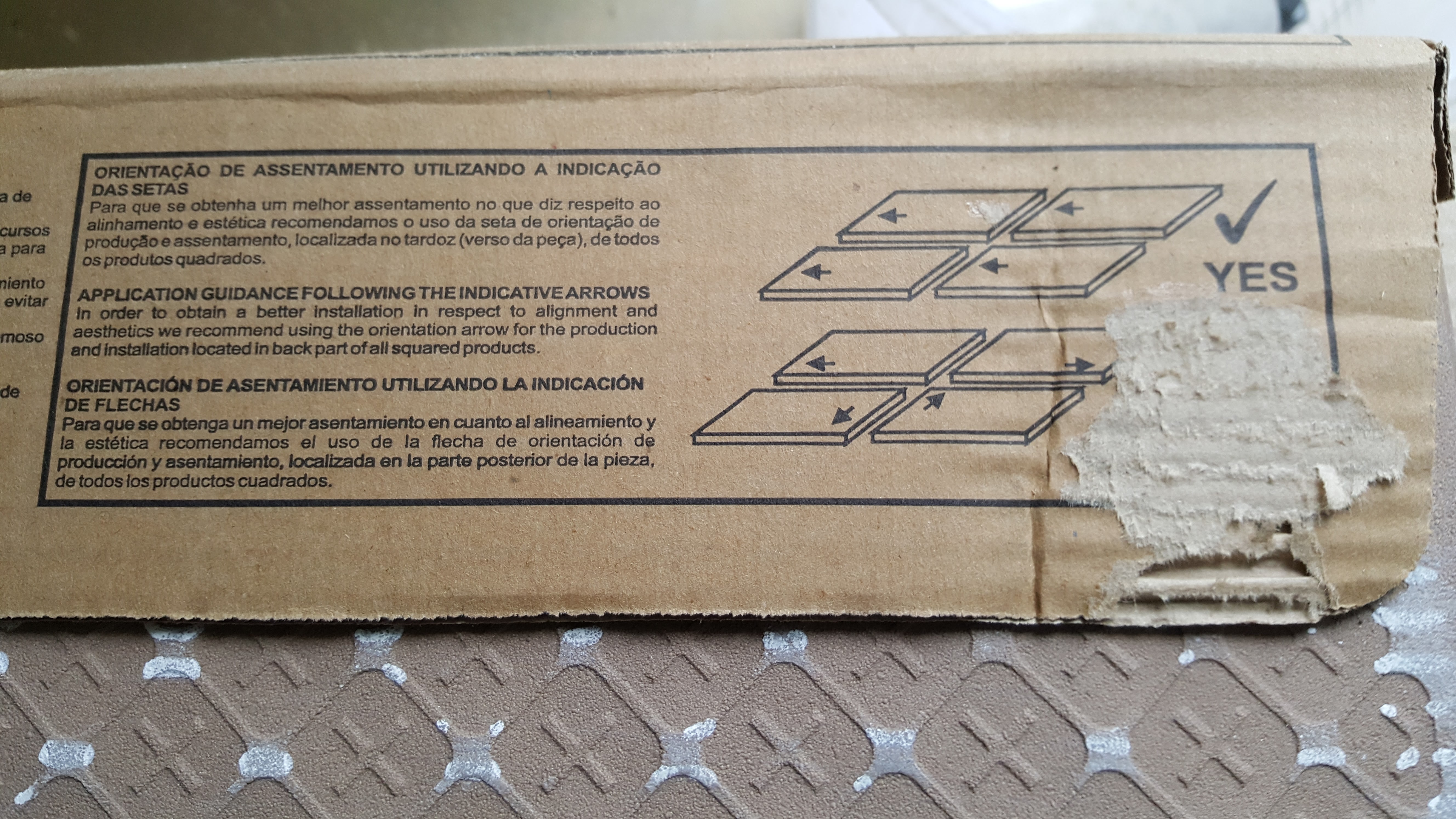

the arrow .... puff ....
the arrow only serves if you have calibration problems.
if one side does not have the same size as the other.
when you make the buttering, goodbye arrow ....
one day I was laying 150x75cm, and the sales representative
of the brand has come to look at the tiler.
he told me to follow the arrows ...
I replied: if you do not go away, I'll put the arrow in your a.s ...
he escaped immediately.
I did not understand the reason for his escape ...

That’s exactly what in do. They are usually all the same direction in the box. Open a box, lean it against wall, flick through and put small pencil mark on face.
Got an idea, hold them all together and put one line of pencil down the whole stack edge in one go so it wont even be seen once its down.
Now to go through the 3 boxes of loose tiles I have opened to plan my set out. !
LM
And I suppose your good at the ball under the three cups as well
Well if remembering what way a tile is pointing is giving you trouble there is a number you can call and certian diet changes you can make to help you out.
Remembering what way I hold a tile while I back butter it is no claim to fame o_O
