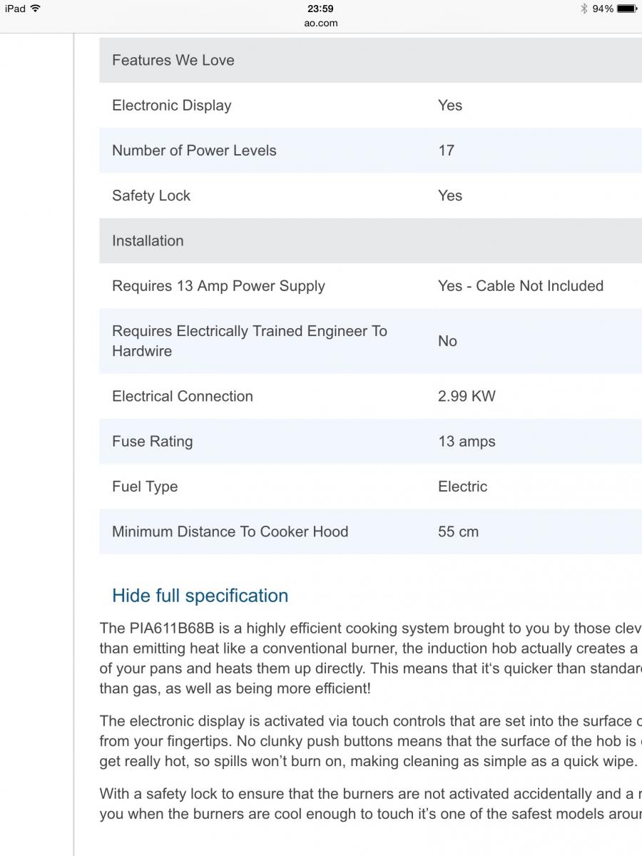

What I'm talking about is a PLUG IN INDUCTION HOB rated @13amps. They are out there.

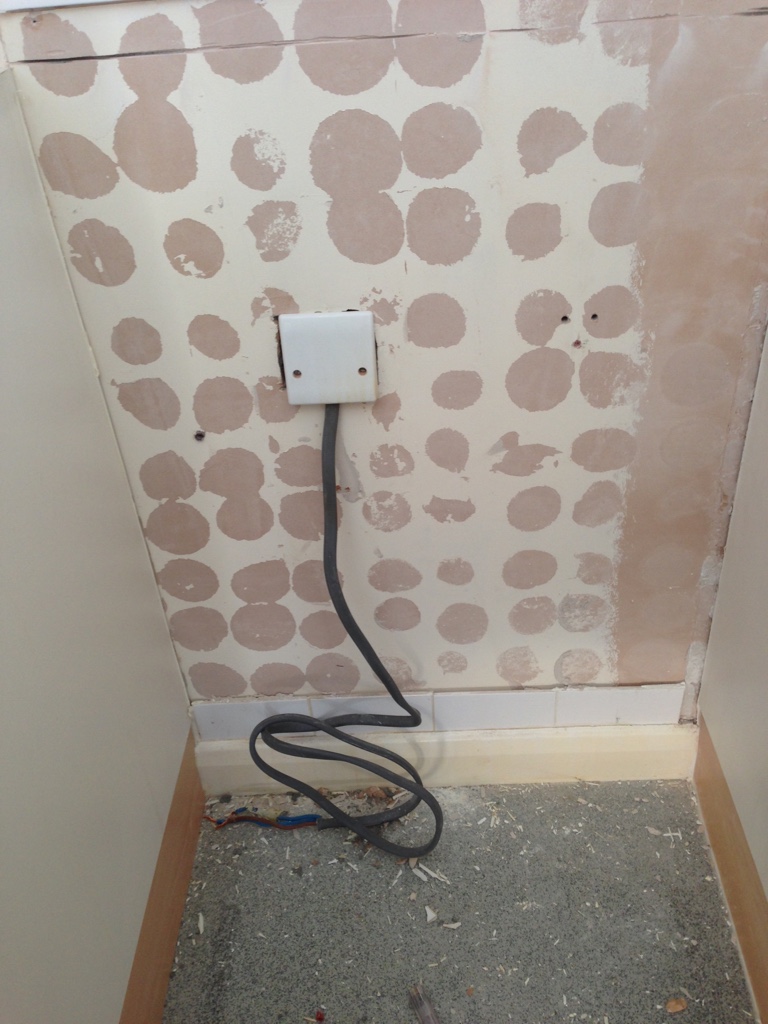

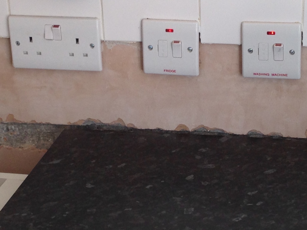

But that's the good bit! When I had to put in a new piece of worktop to house the Hob I did my best to remove the old one without damaging the tiles, such as they are, because we're not due to replace the kitchen till the end of this year. We've only been here two yrs and the kitchen and bathroom will be last on list cos of the expense. So when cooker gave up I was forced to put in a new piece of hideous worktop too! Grrrrrr!
Leave tiling intact? Haha some chance!!!!
Primer........ I see no primer! ........only dusty plaster!
And those behind the cooker........ I pulled them off with my finger nails! Haha still that's hidden for now behind the new oven housing! [emoji322]
