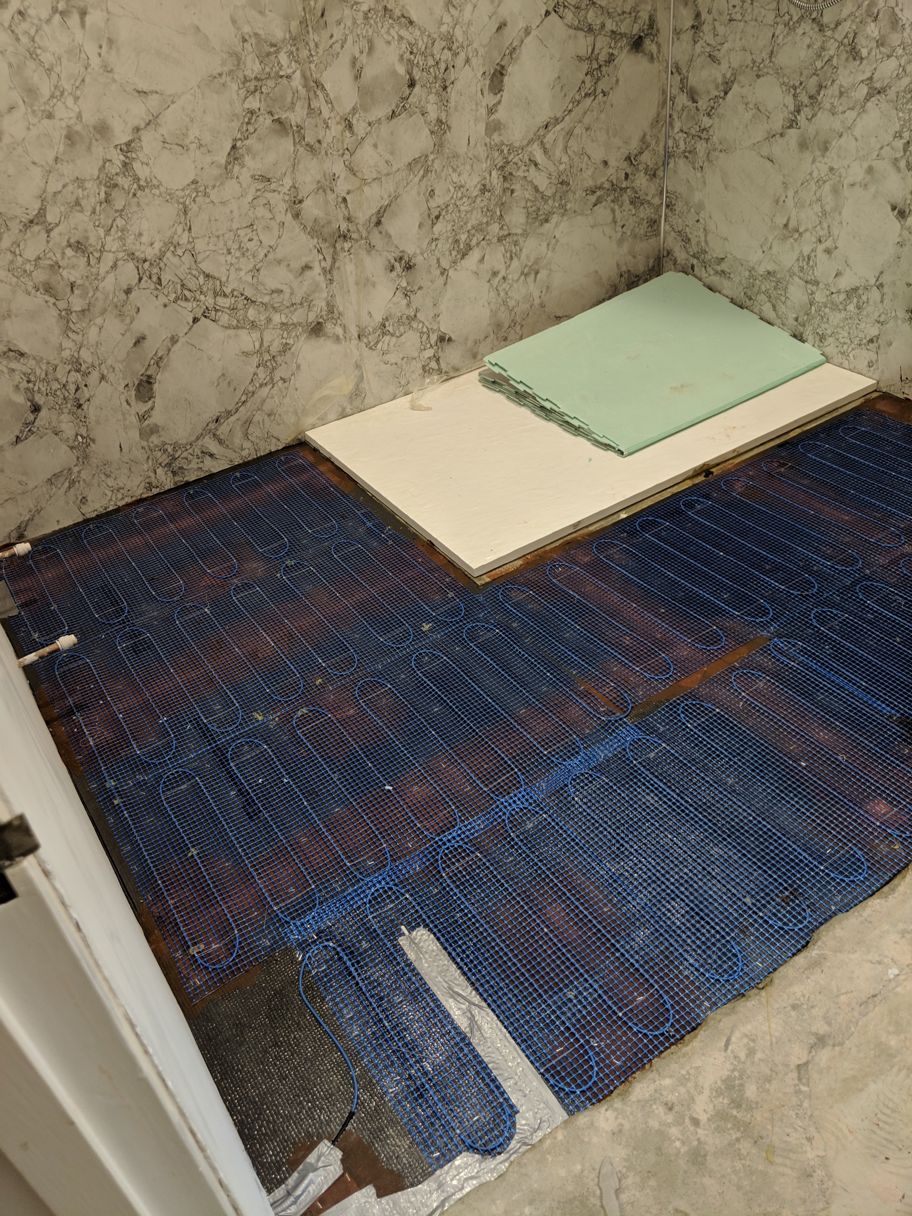

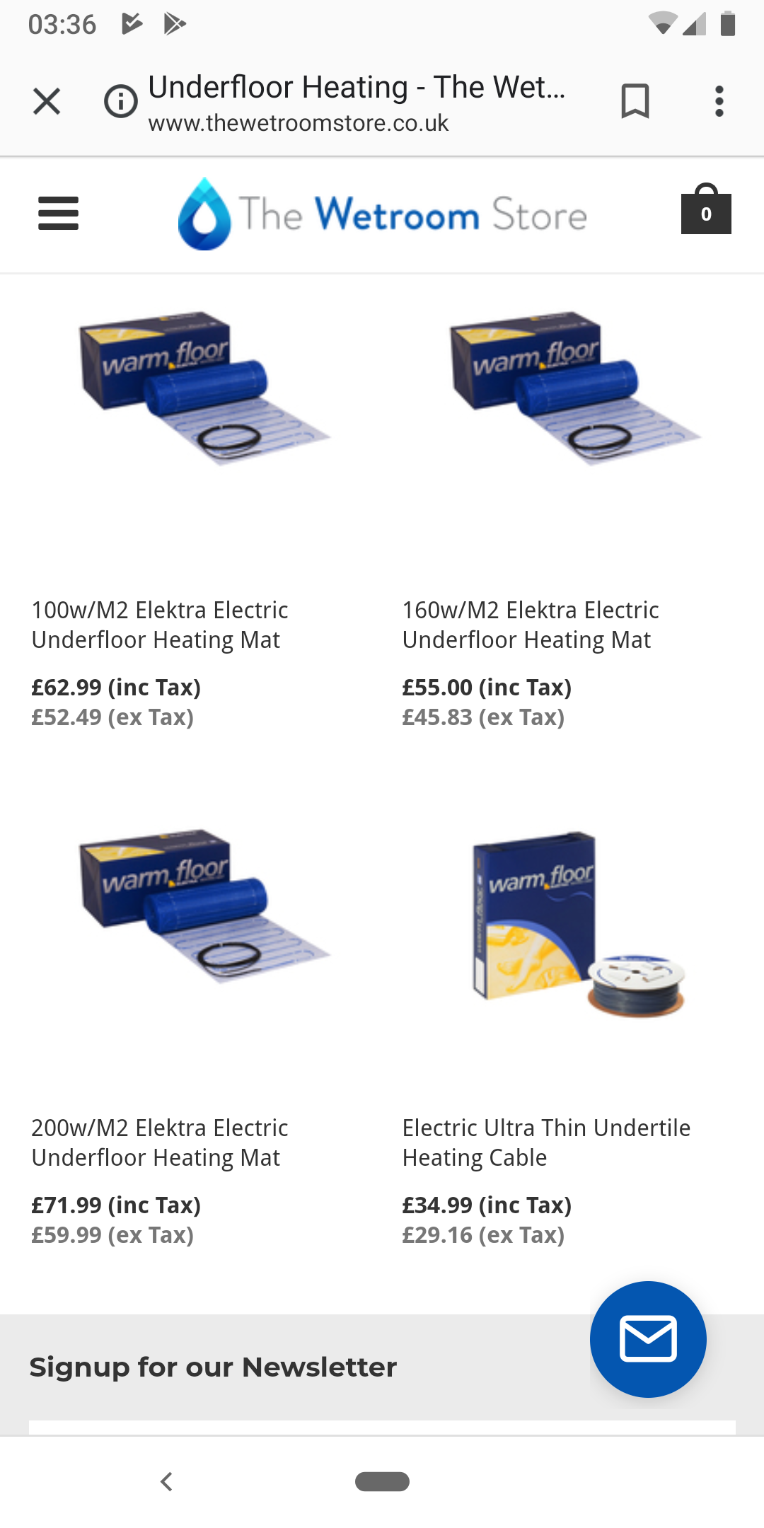

Check out our sponsor the wetroom store below used one of their kits this week and decent quality they do a loose wire system , mats do float in SLC stainless stapels fired into the insulation board and may mesh hold it in place obviously keep well away from the wire .kop
