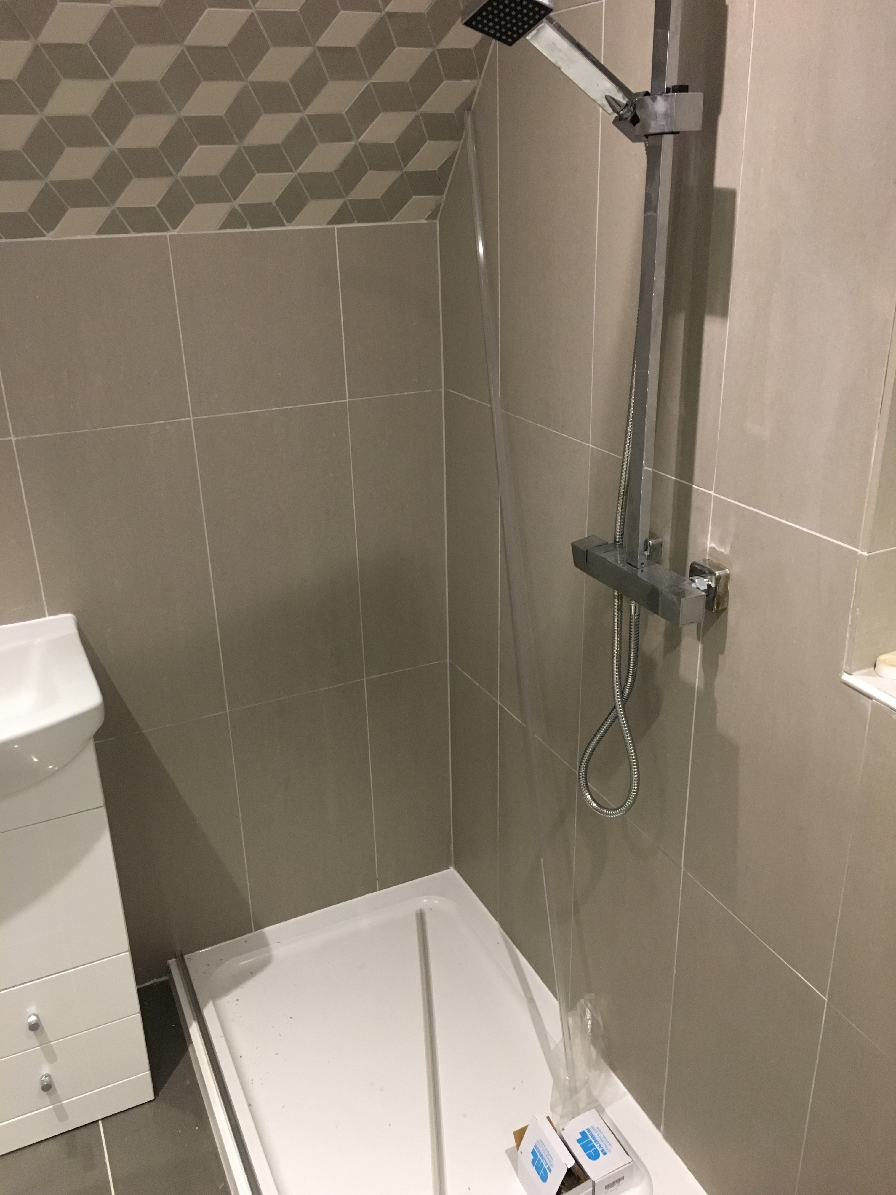

Thanks for taking the time to look at this post. I've used this forum many times in the past, but never posted. Hopefully this is in the right place!

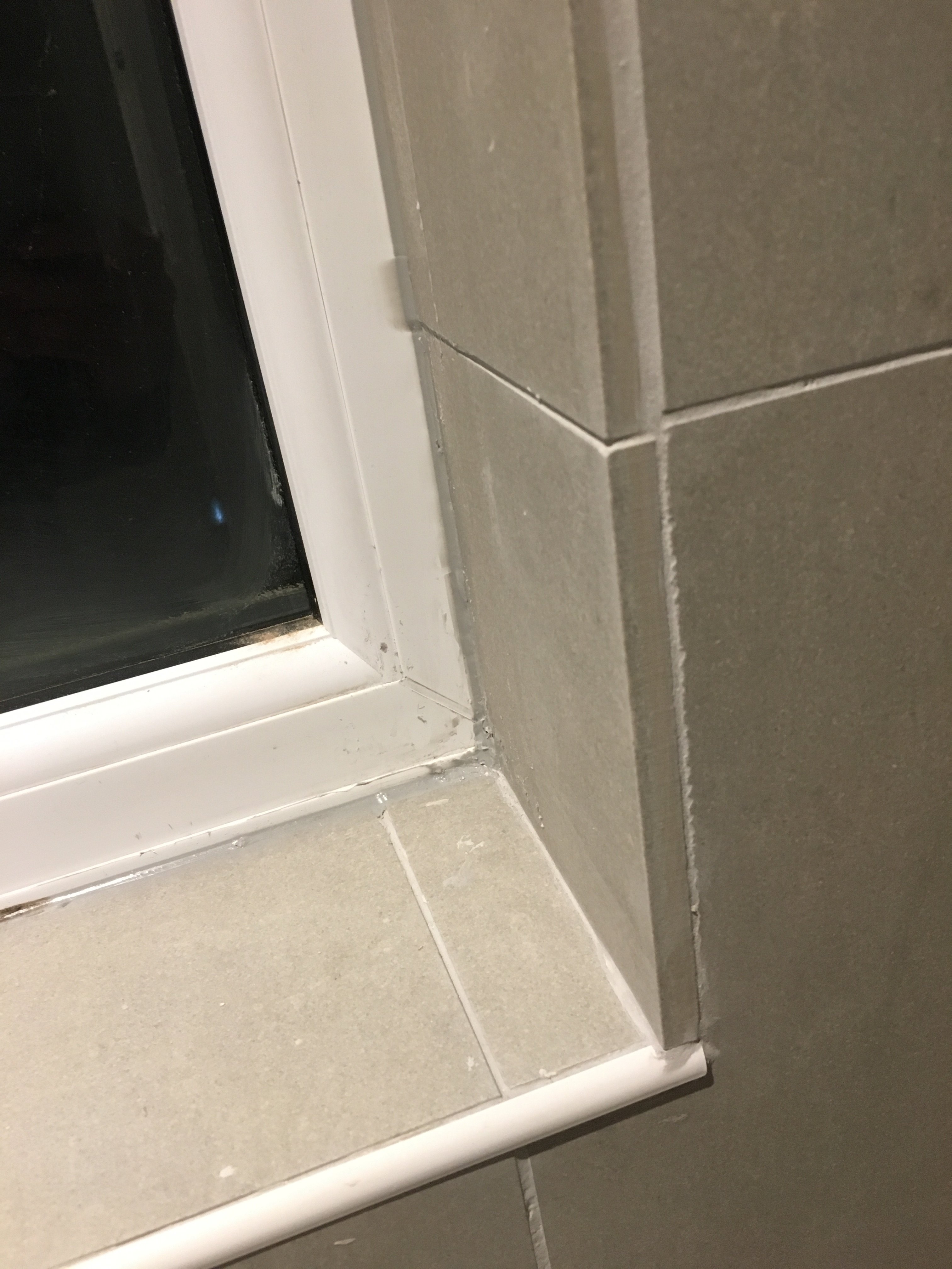

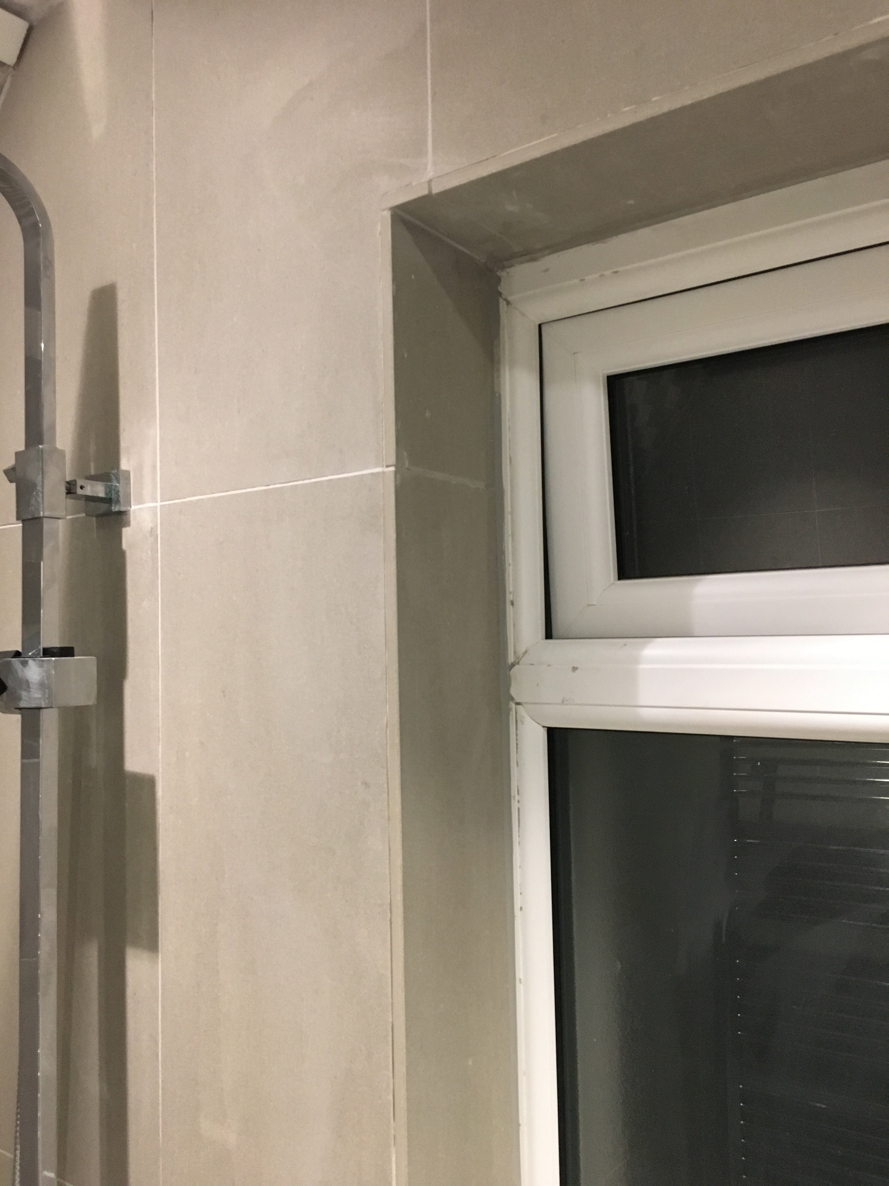

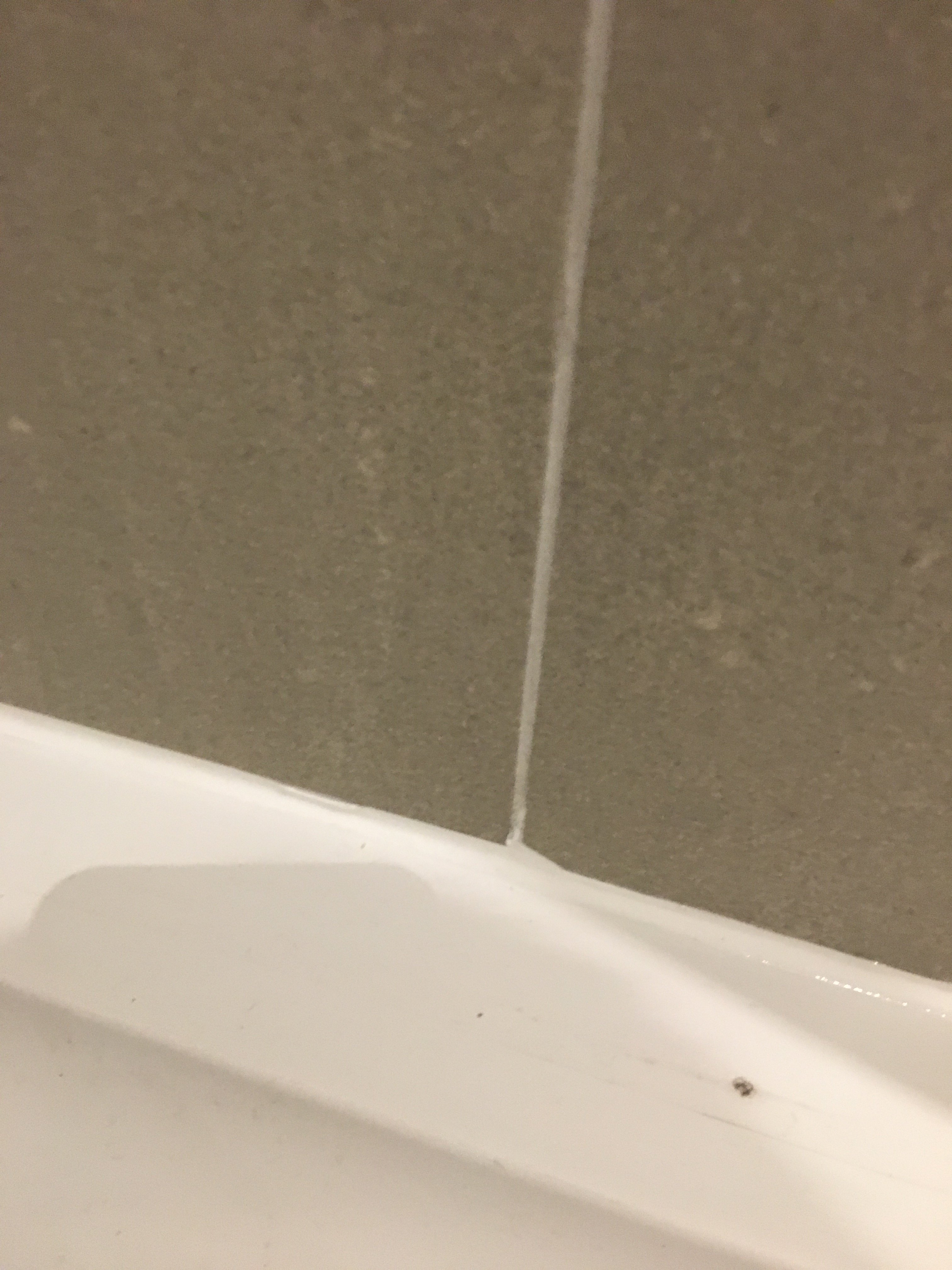

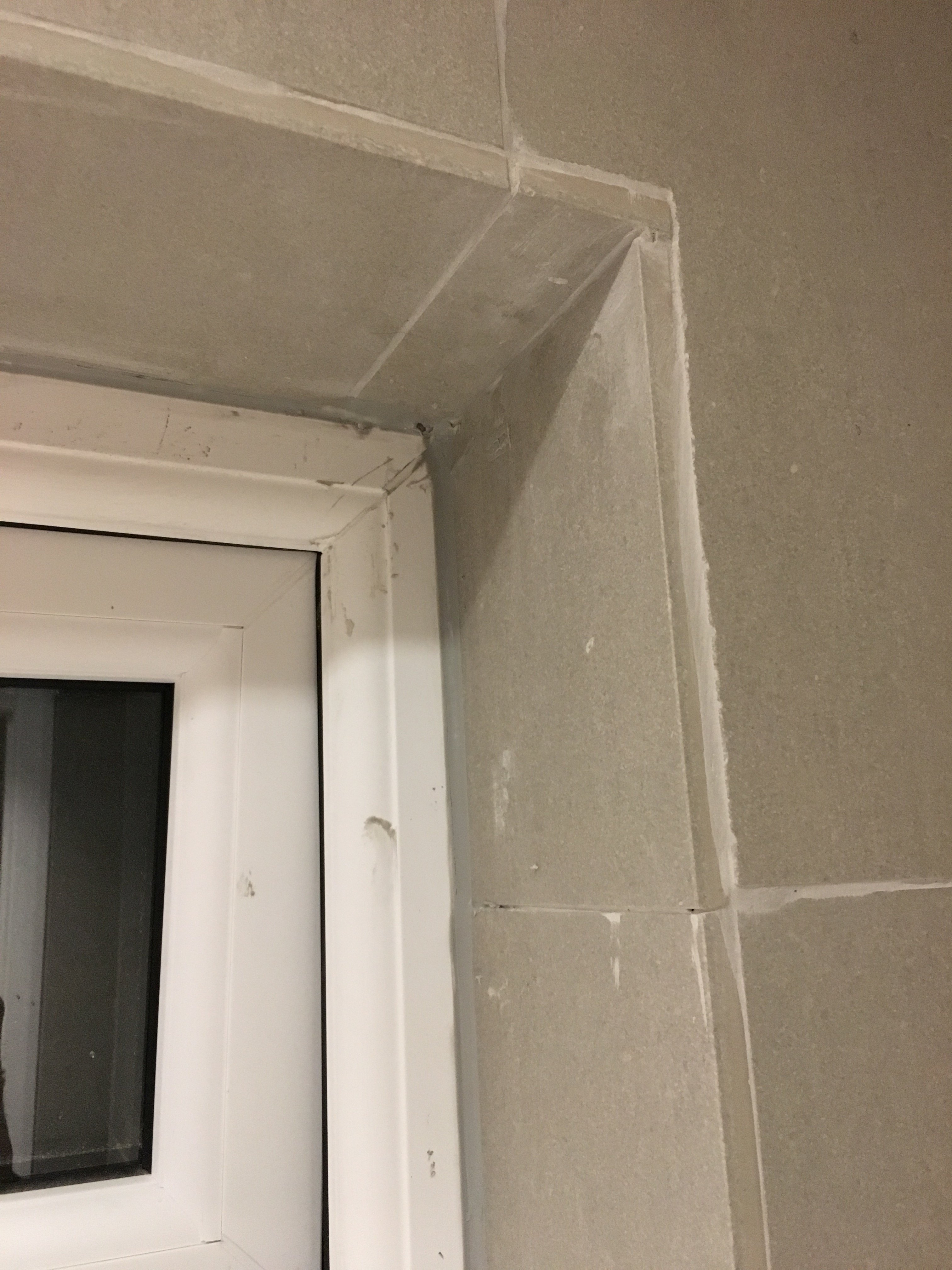

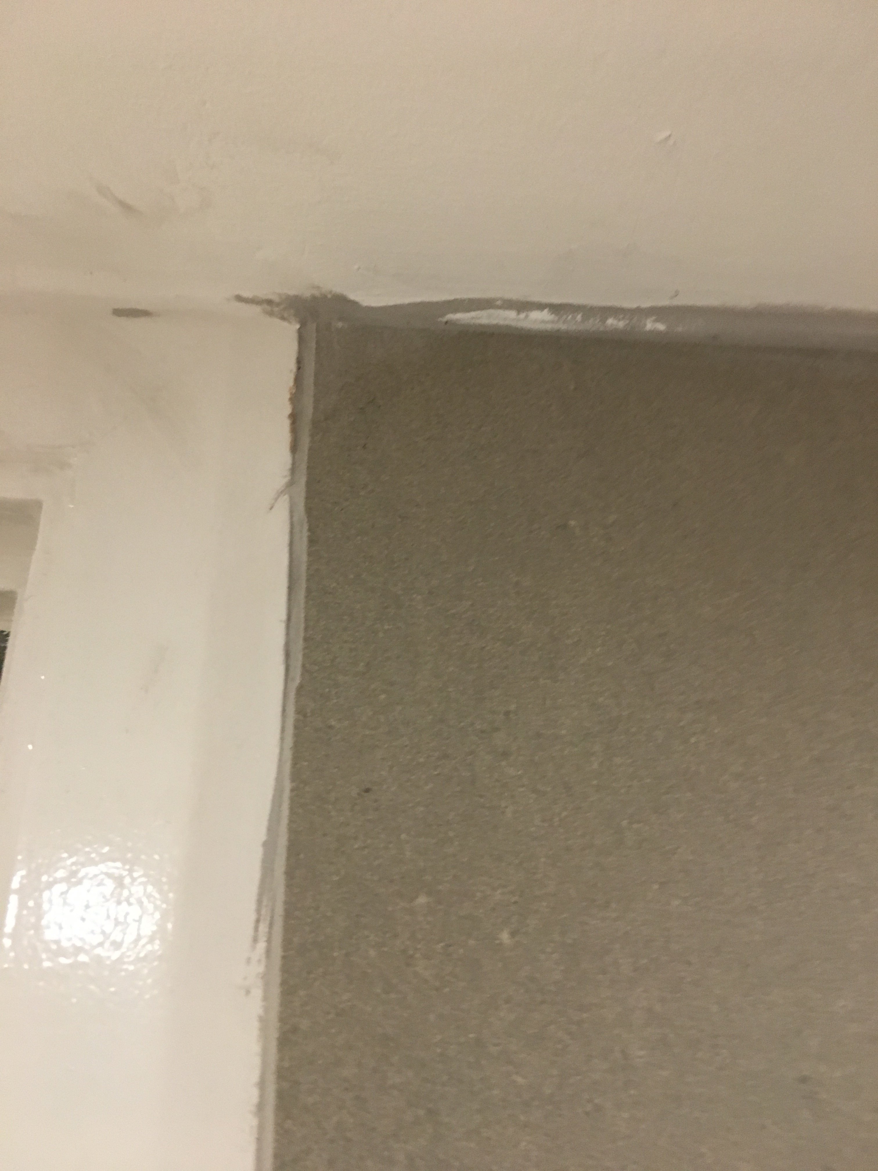

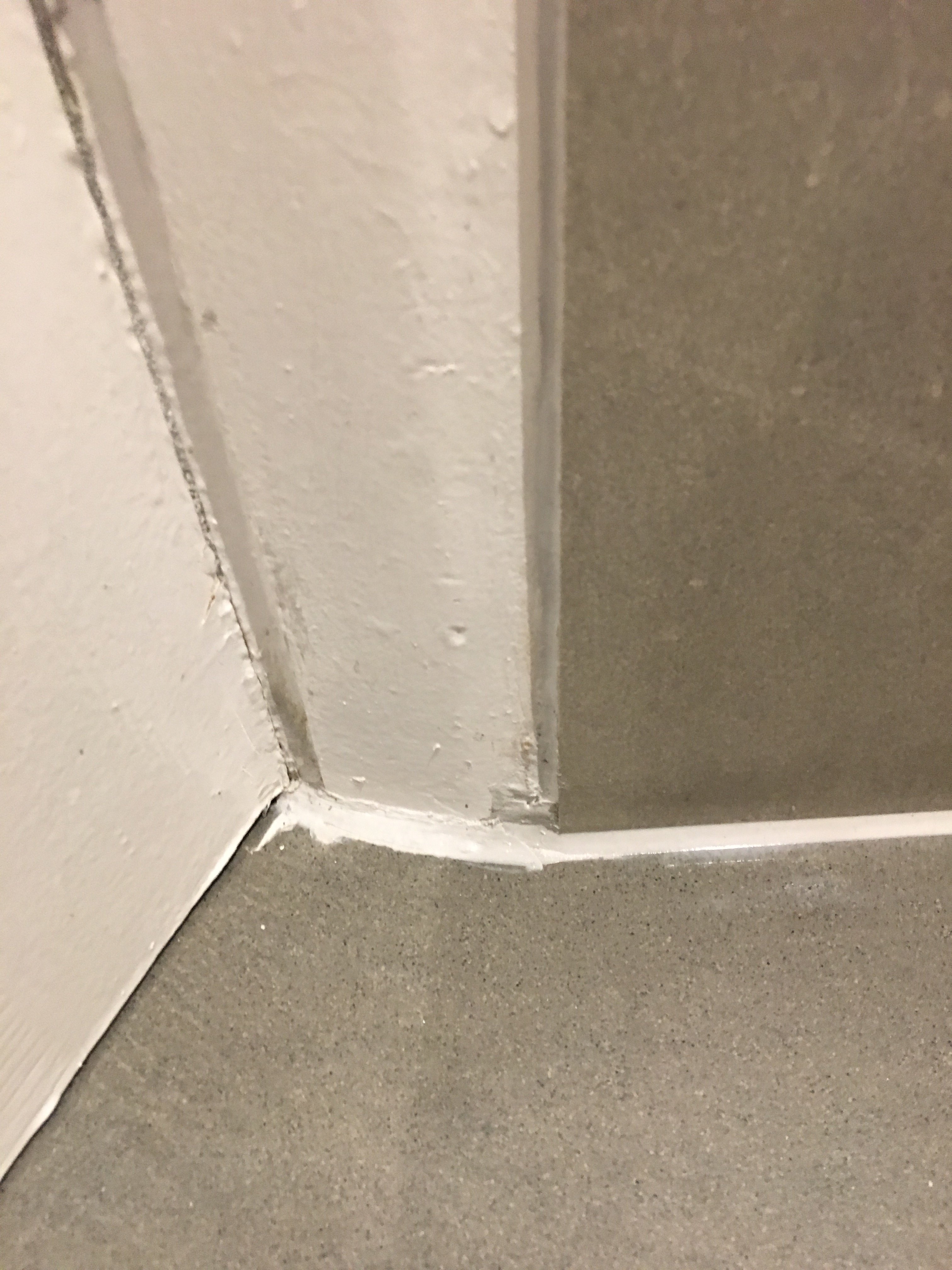

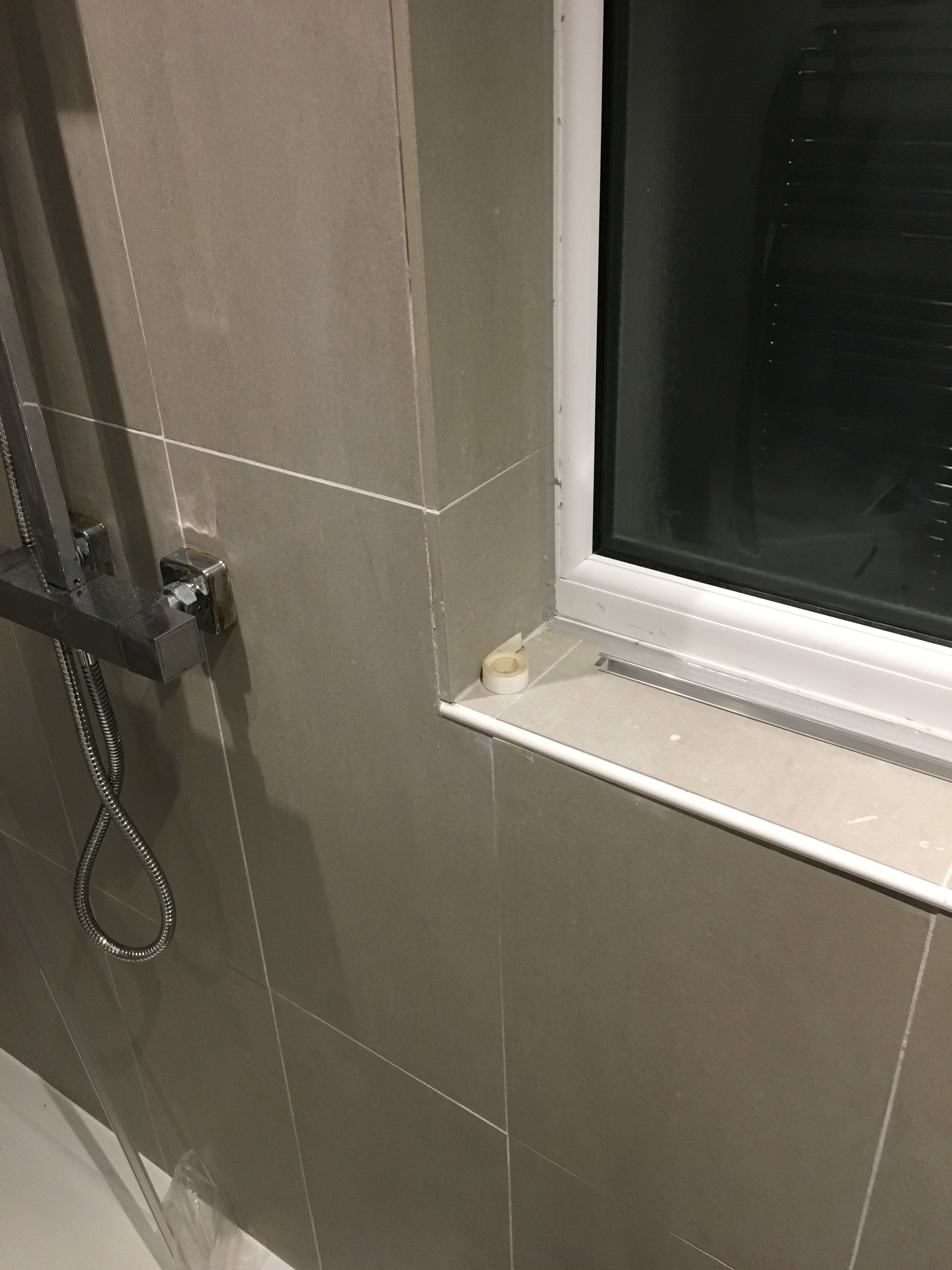

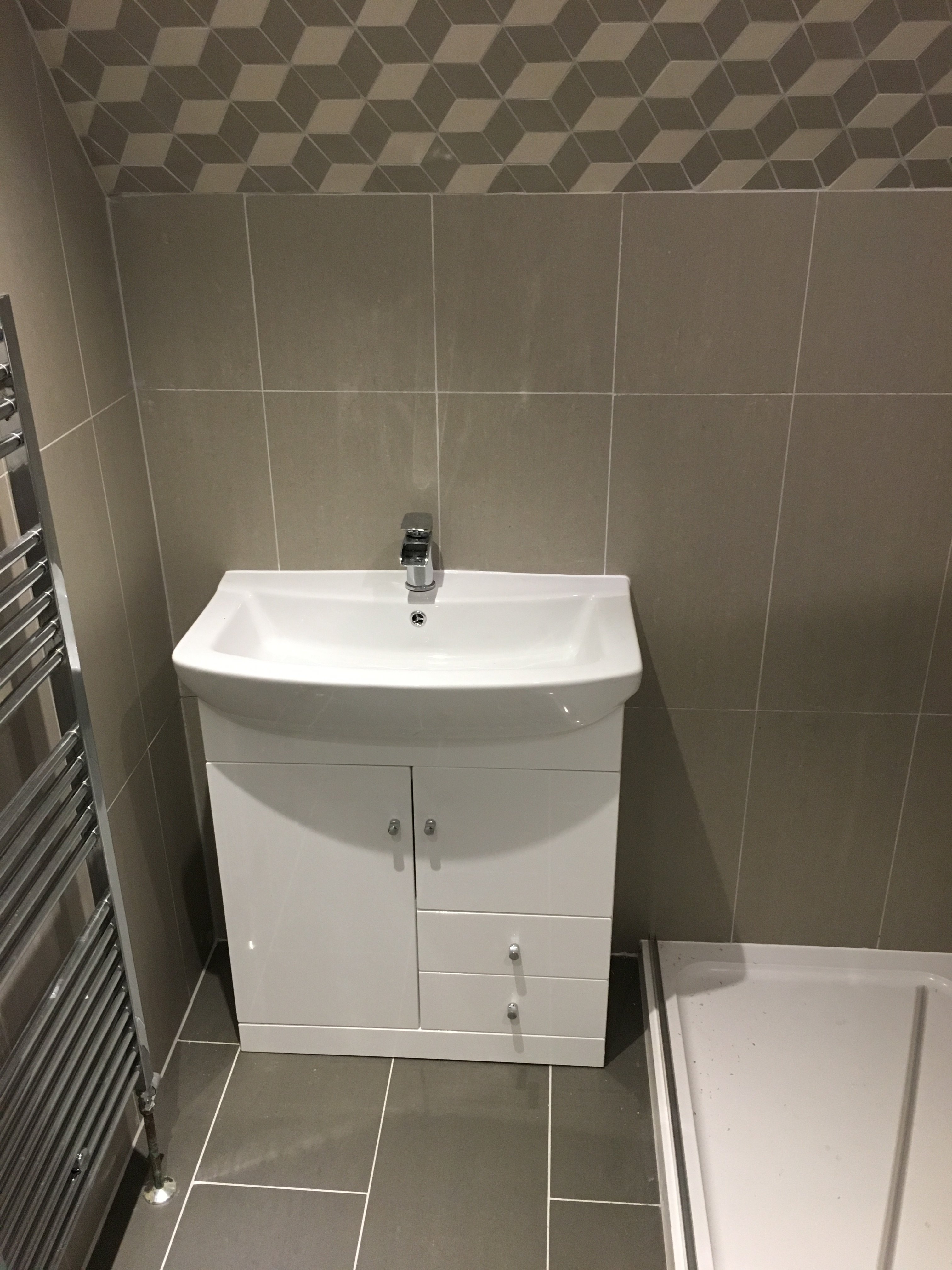

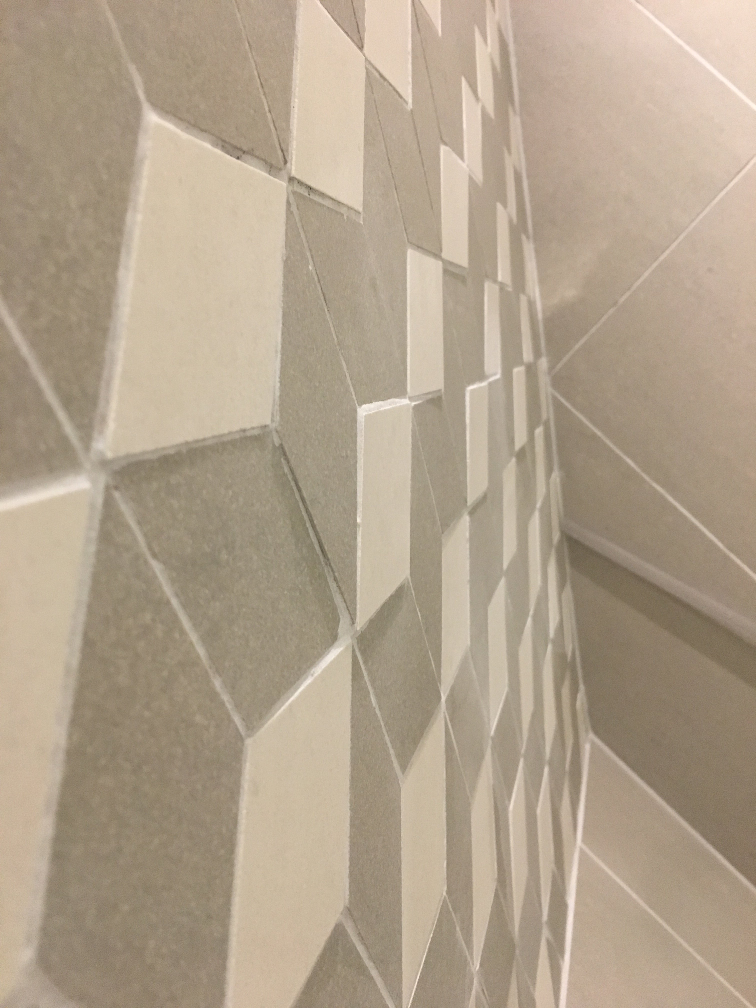

The reason for this first post... Complete disappointment at how badly my parents bathroom fitout has been finished.
I'm absolutely gutted for my parents as this is the first time they've ever spent any amount of money like this to have a job properly done and I don't think they'll ever do it again.
The job was meant to take 2 weeks and it's now been 4 weeks and it's still not finished. Apparently they've said they'll put right anything my parents are unhappy about, but I can't see how that's possible without ripping it all out and starting again - with someone that can actually tile.
Any advice as to what they should do would be greatly appreciated. Do you agree that this is a bad job? Do you think it would be unreasonable for them to withhold payment or ask for it to be ripped out. I'd be reluctant to use the same people again.
Q
Qwerty

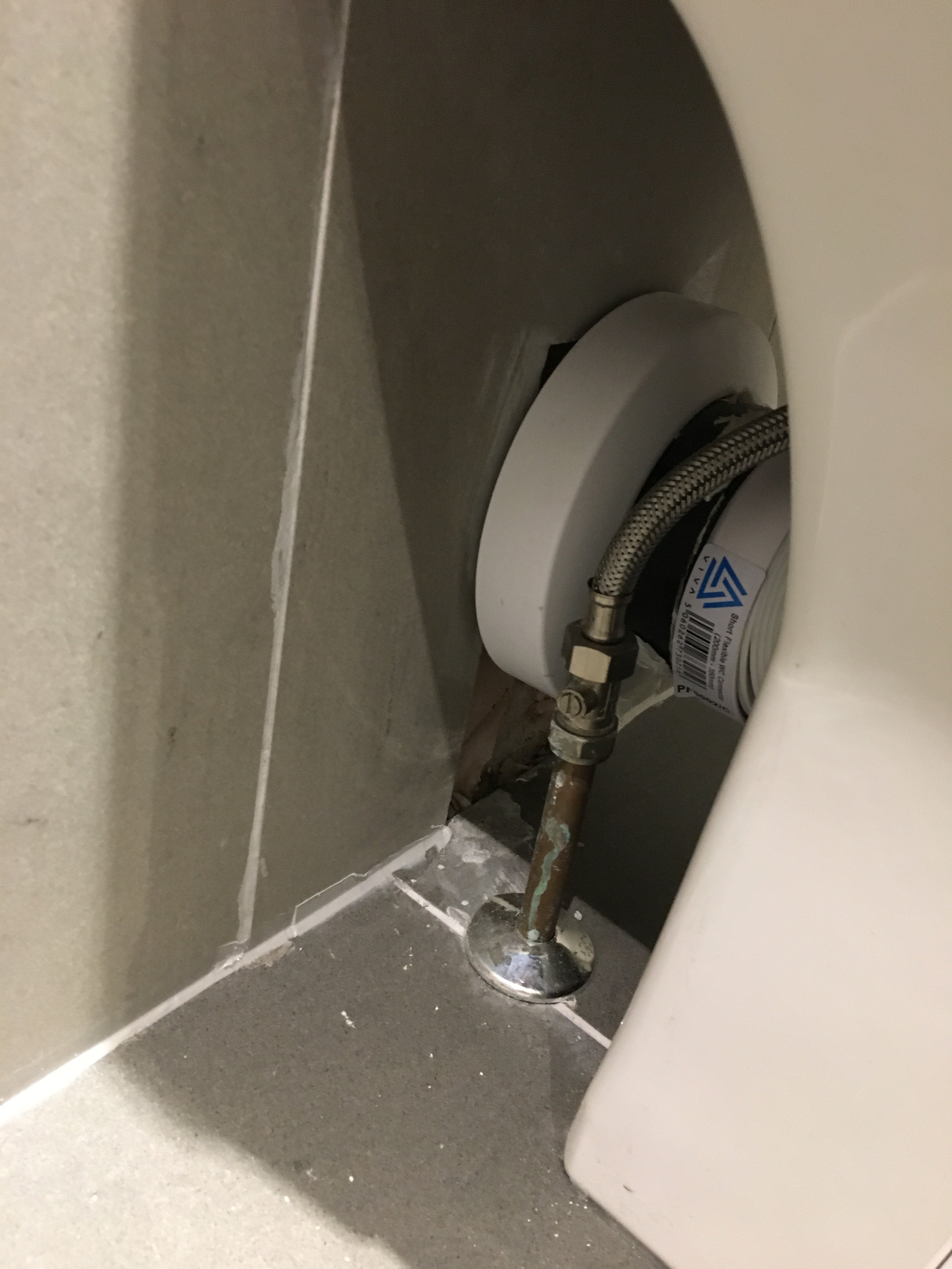

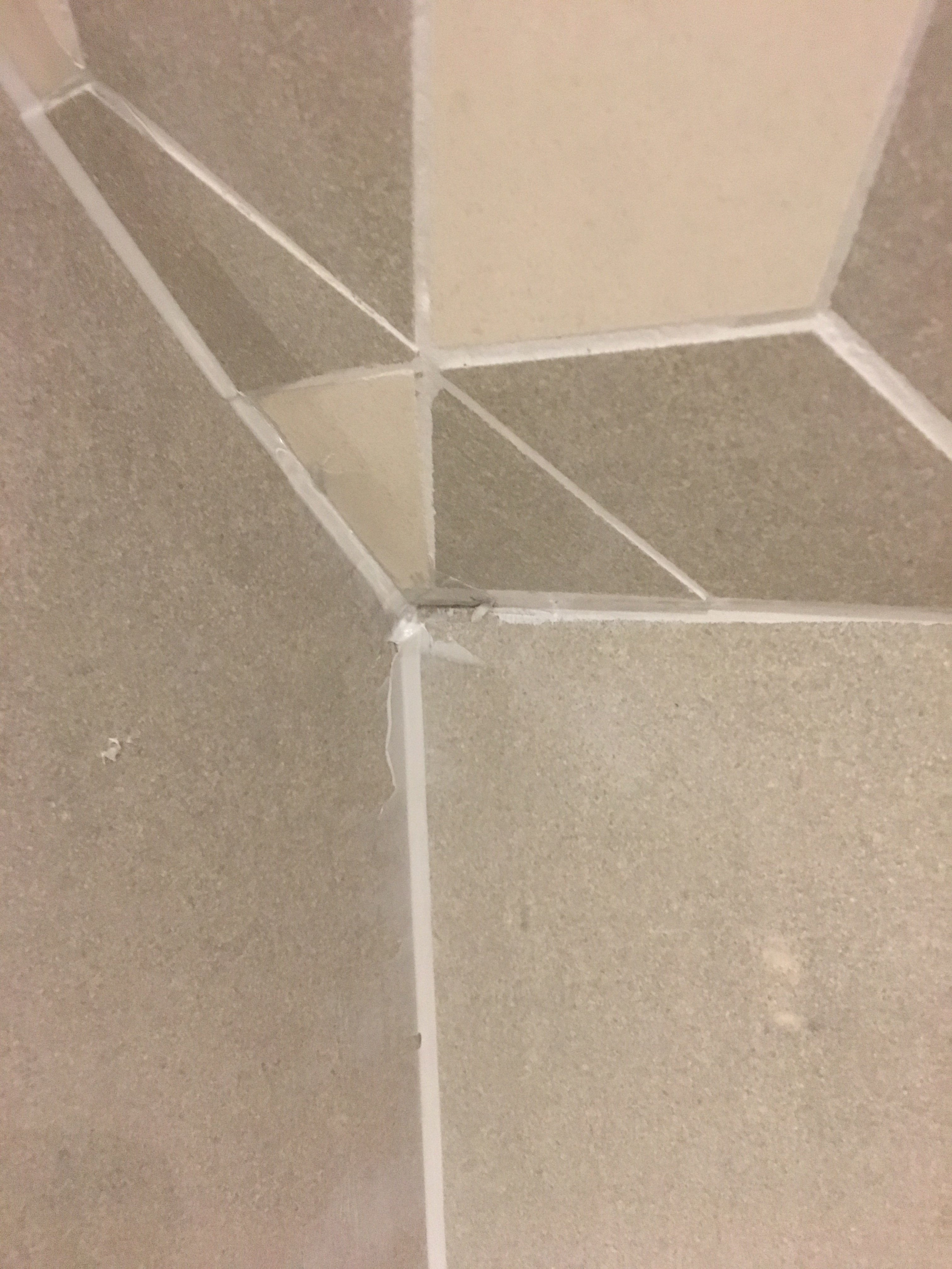

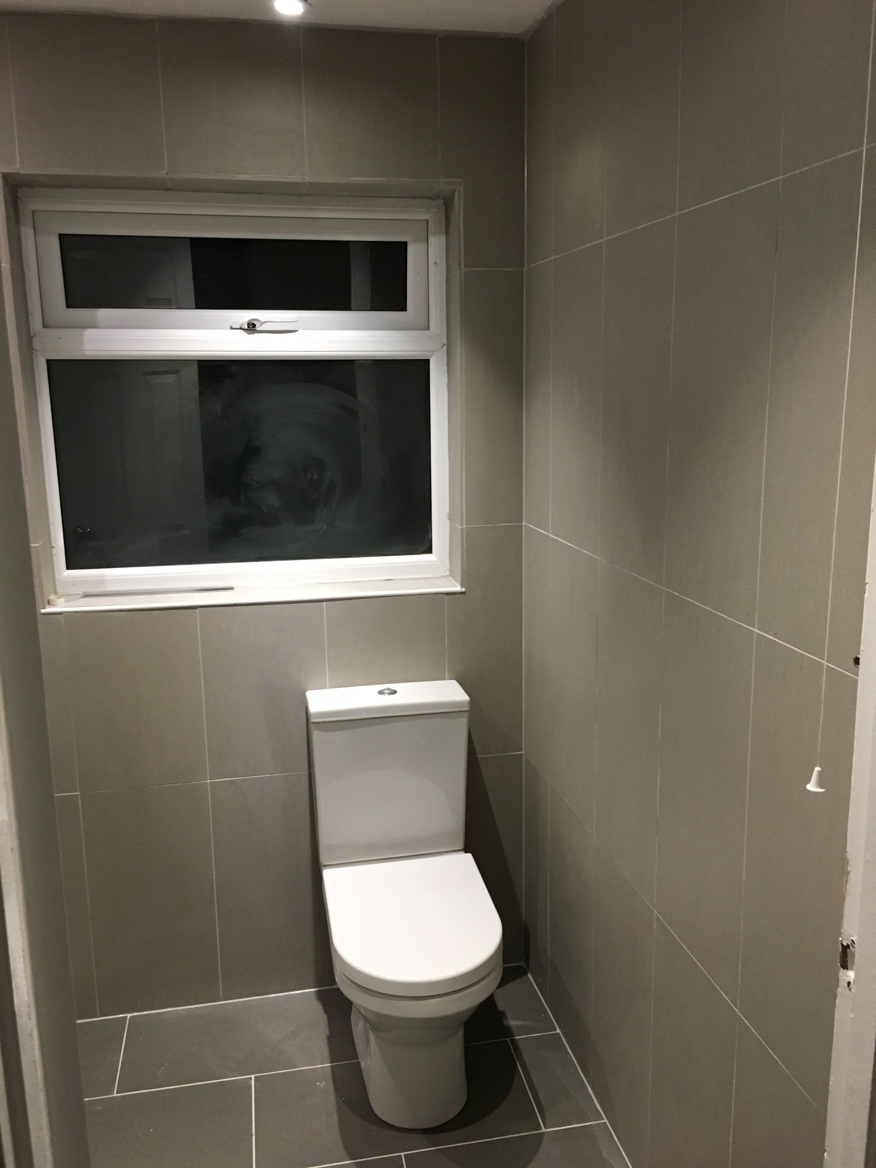

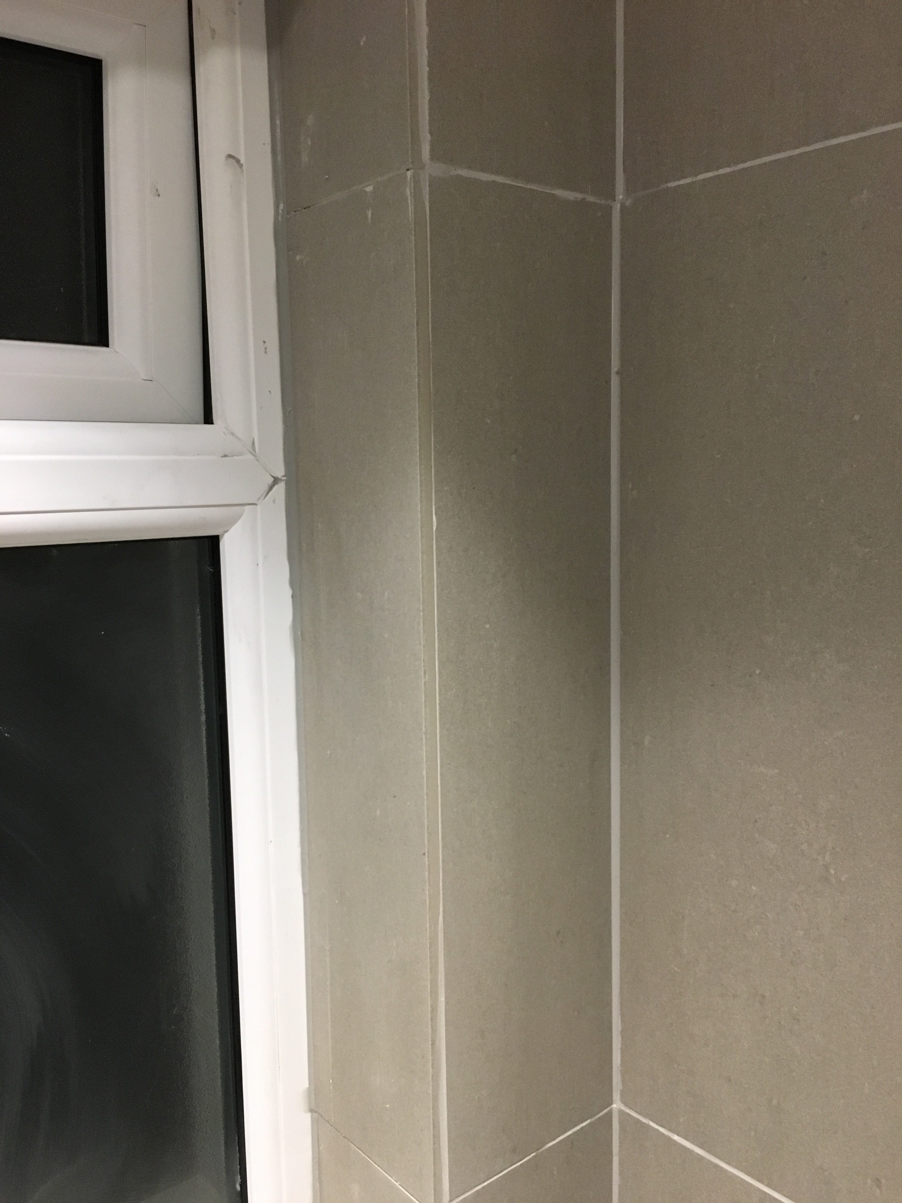

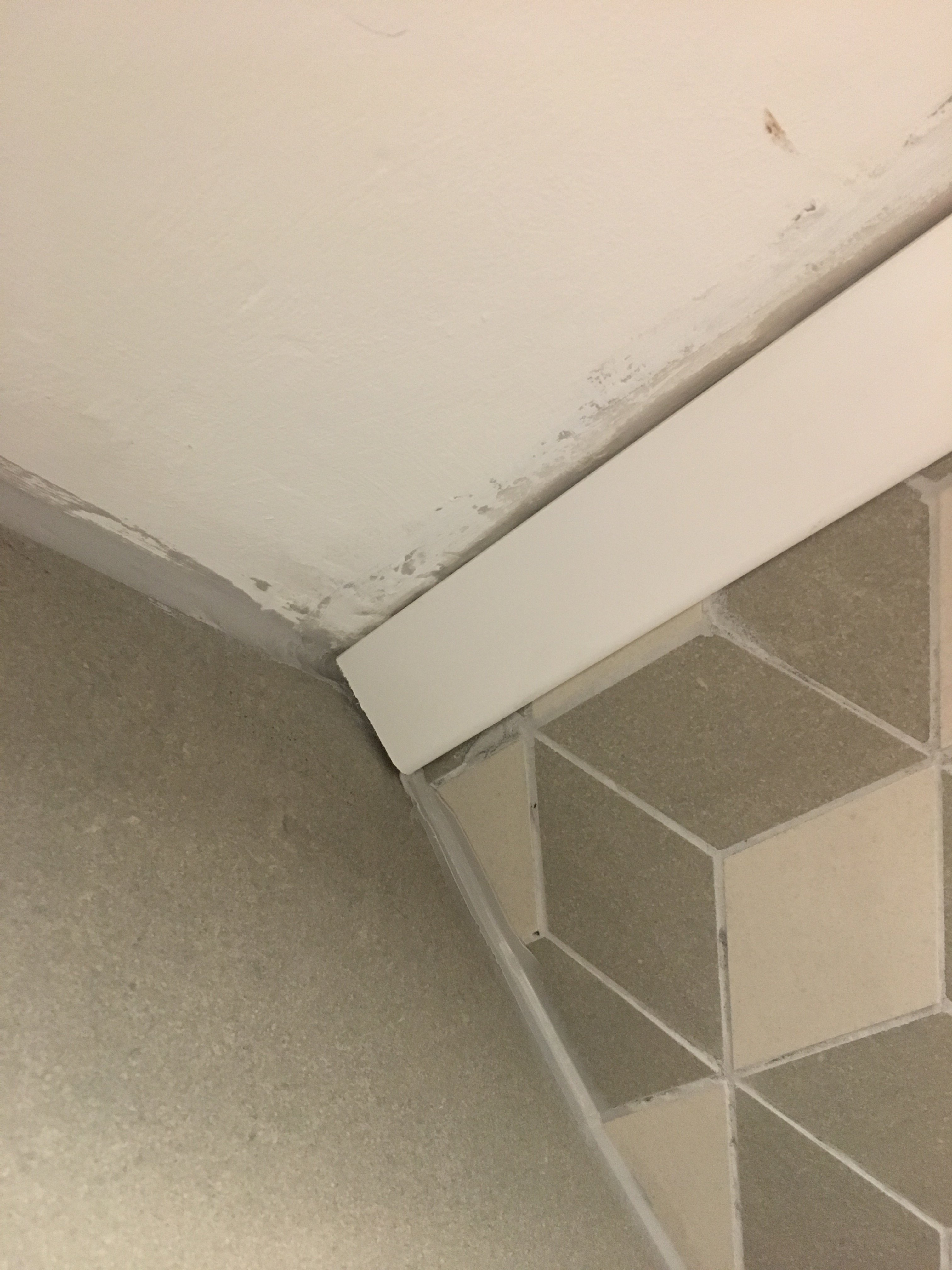

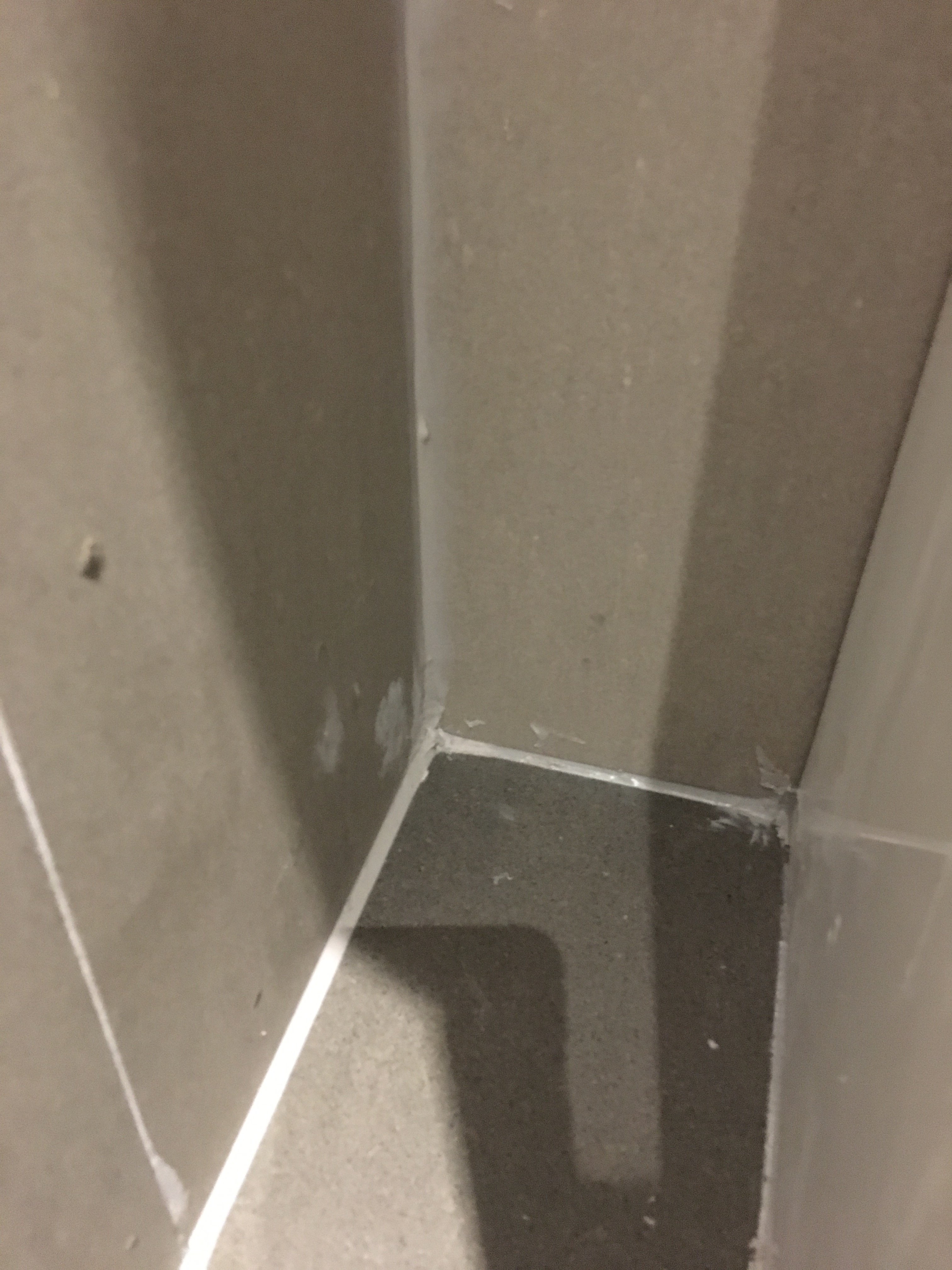

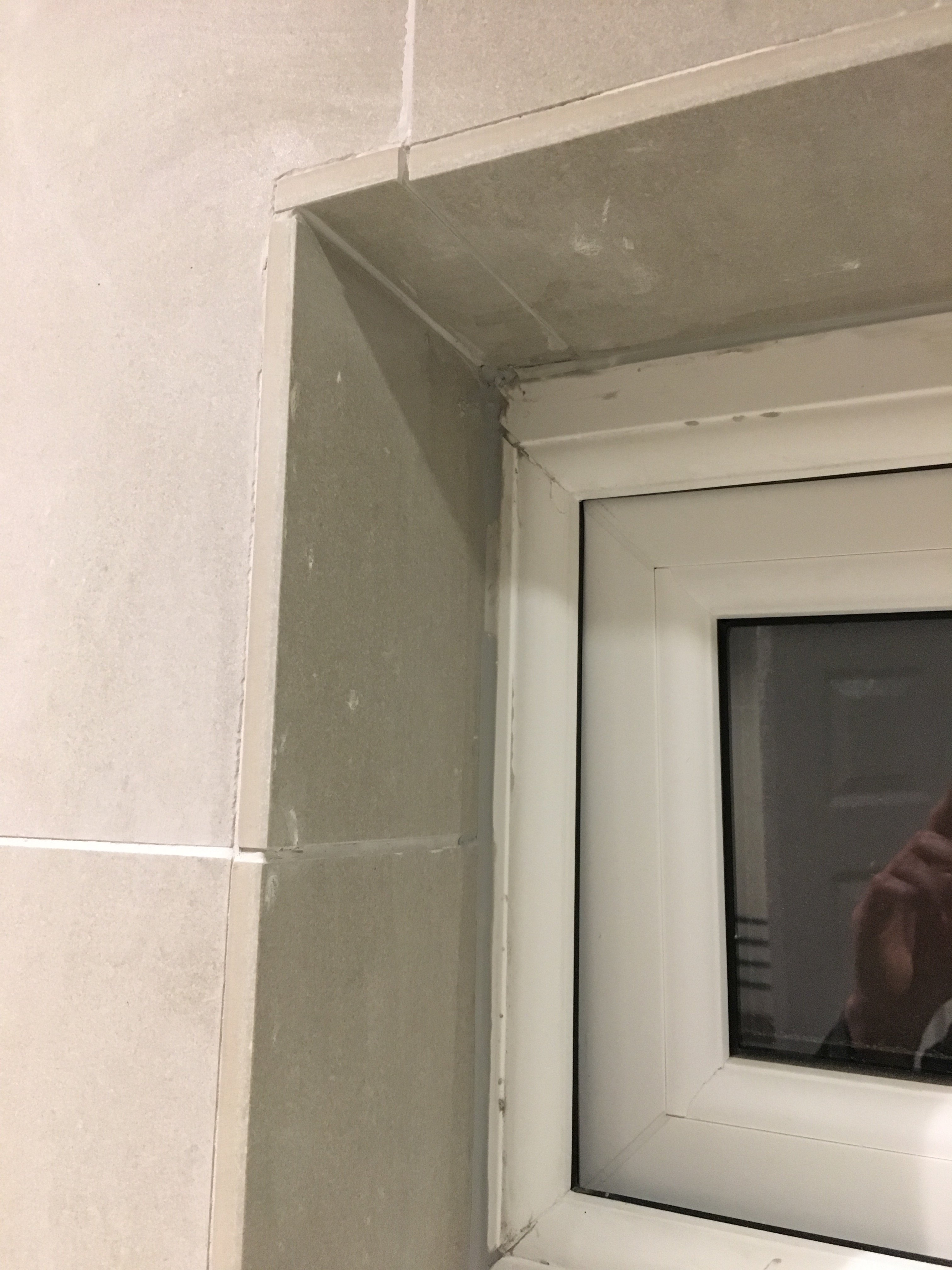

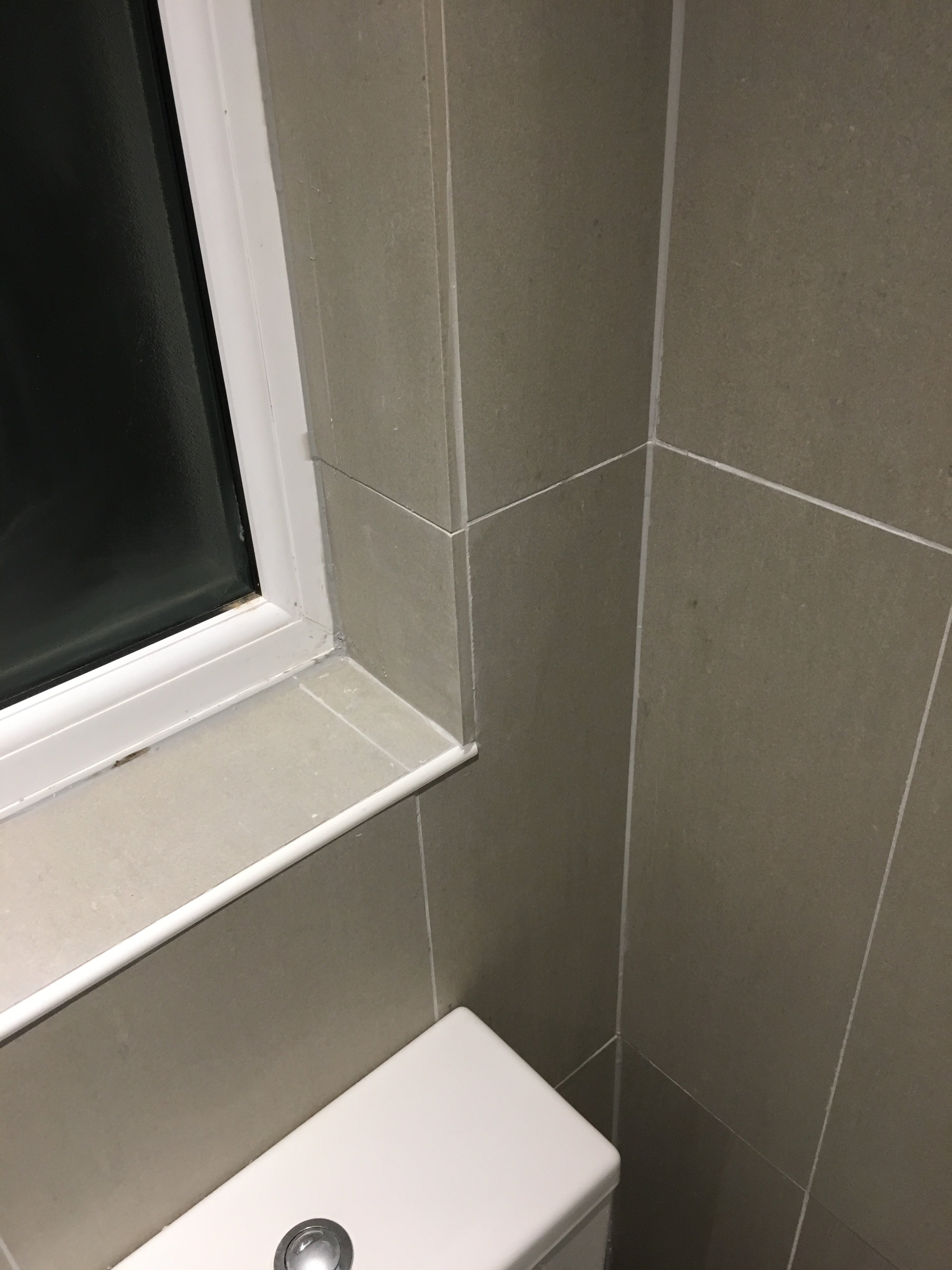

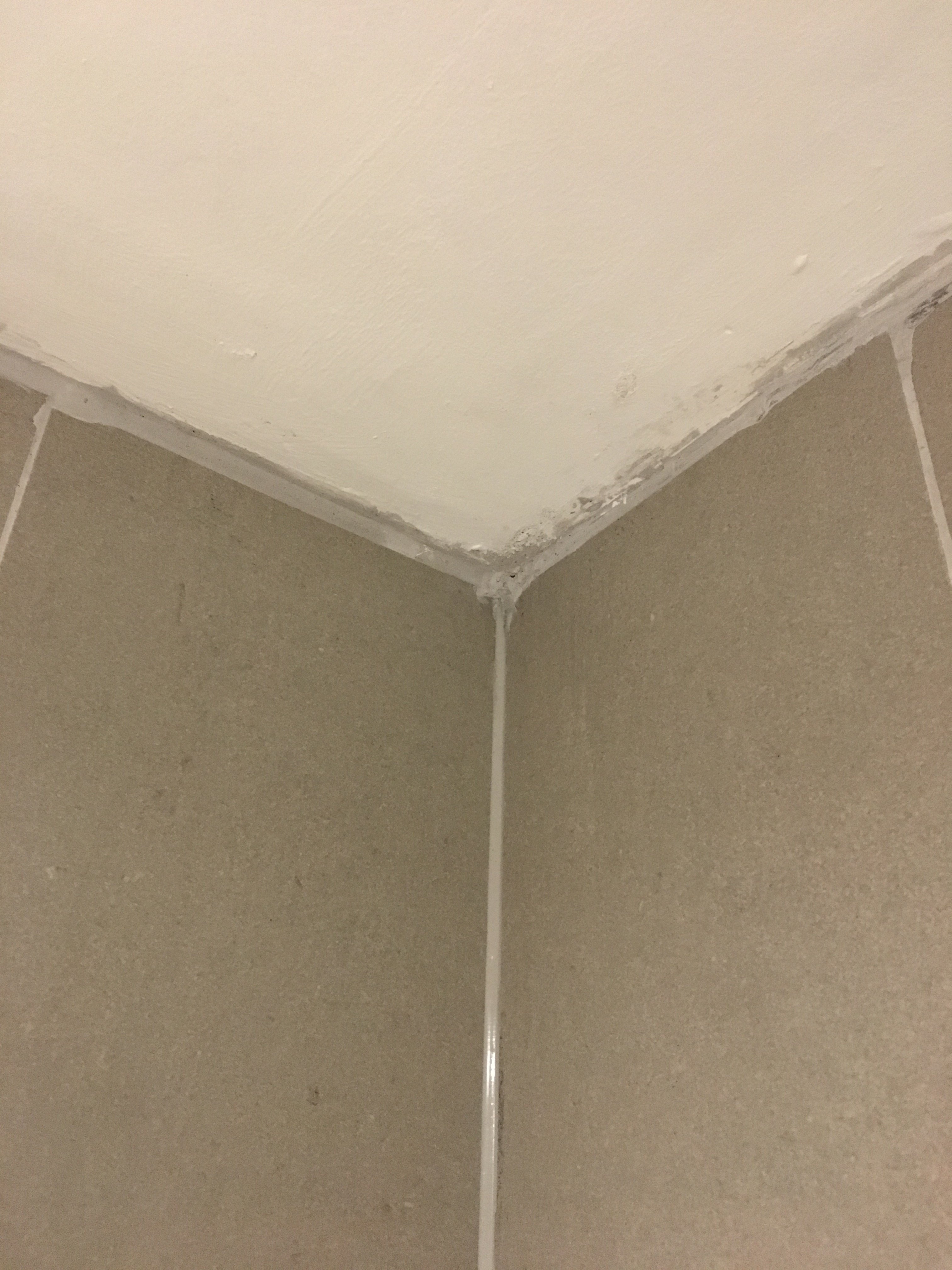

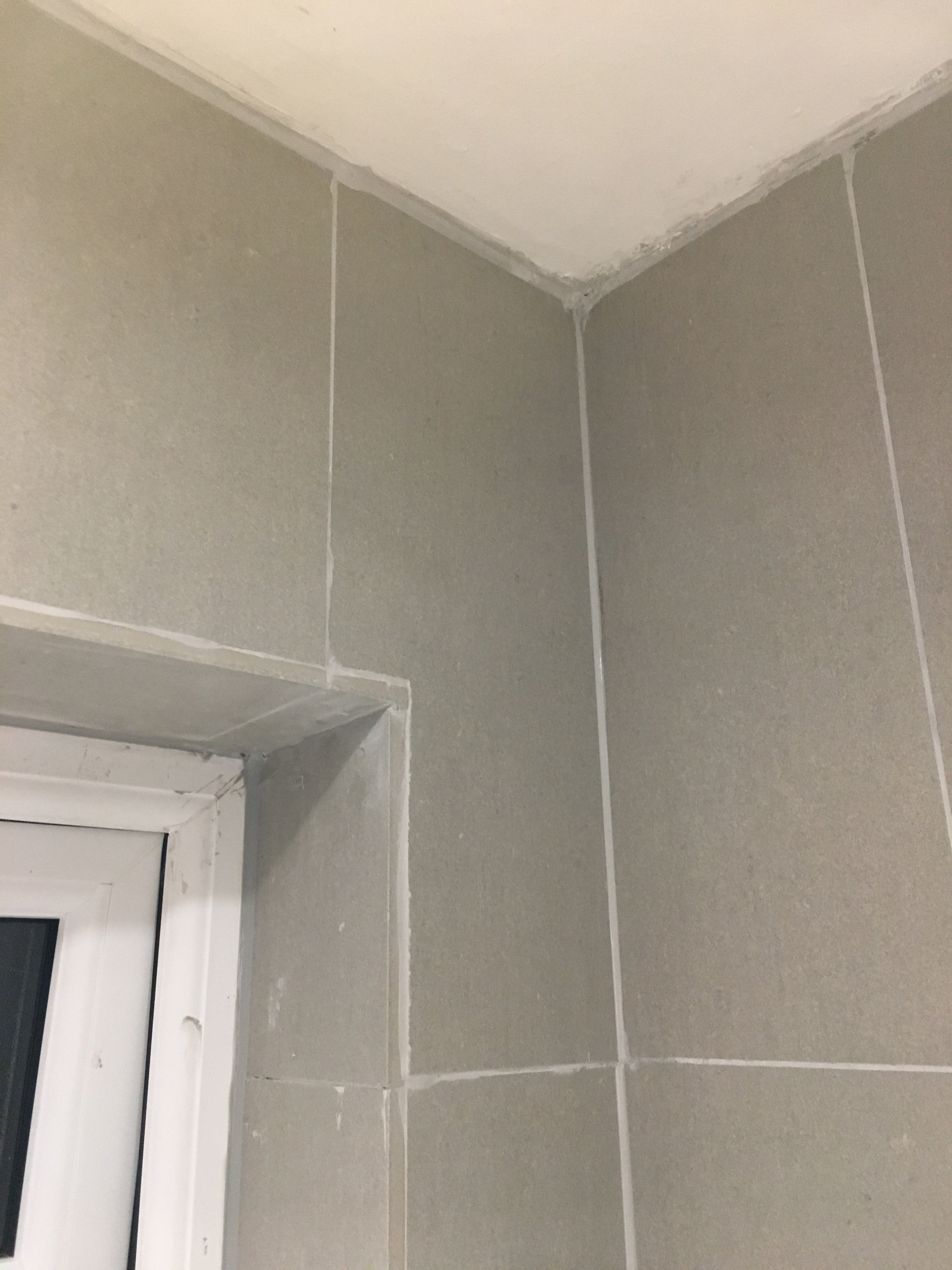

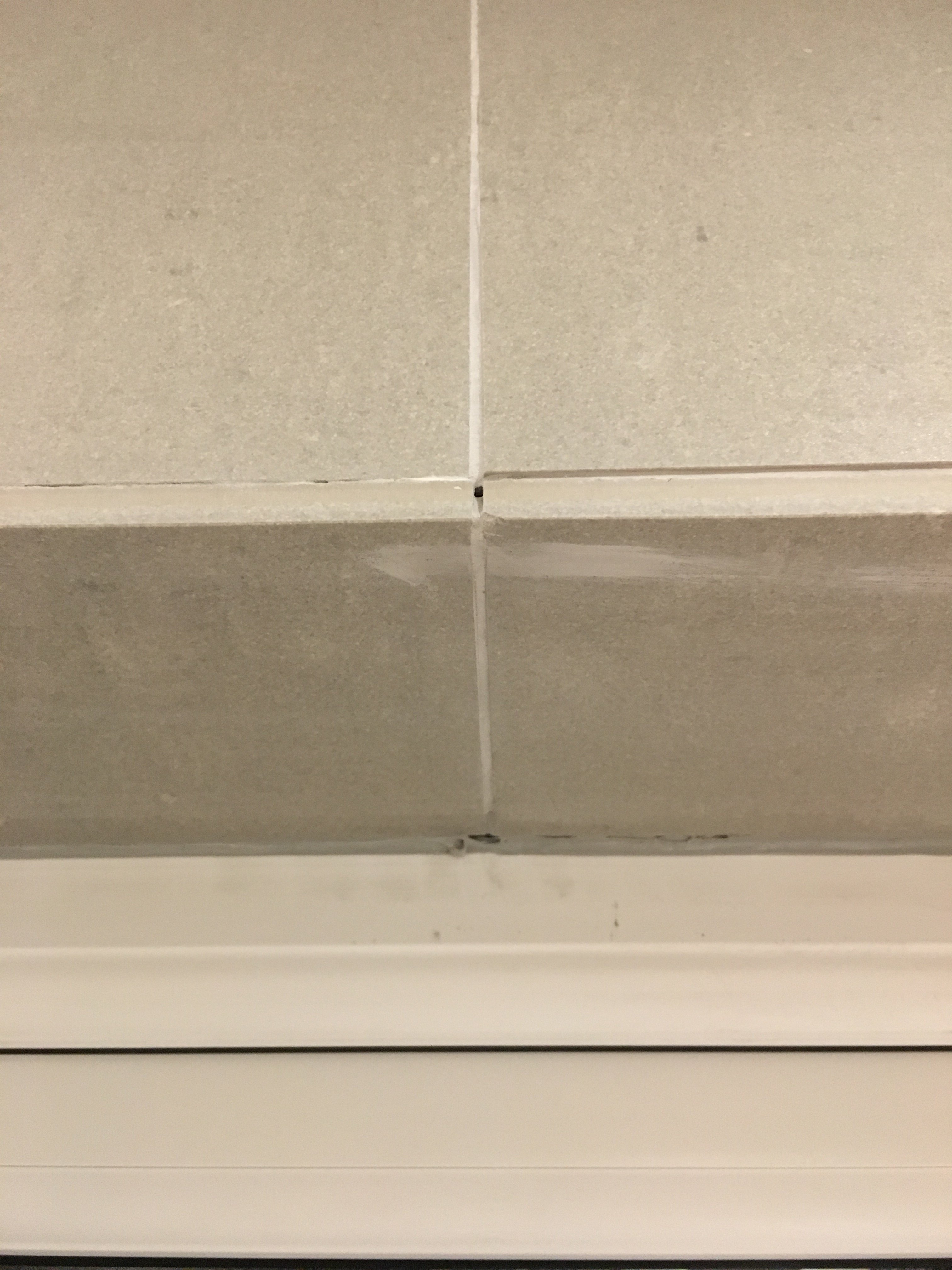

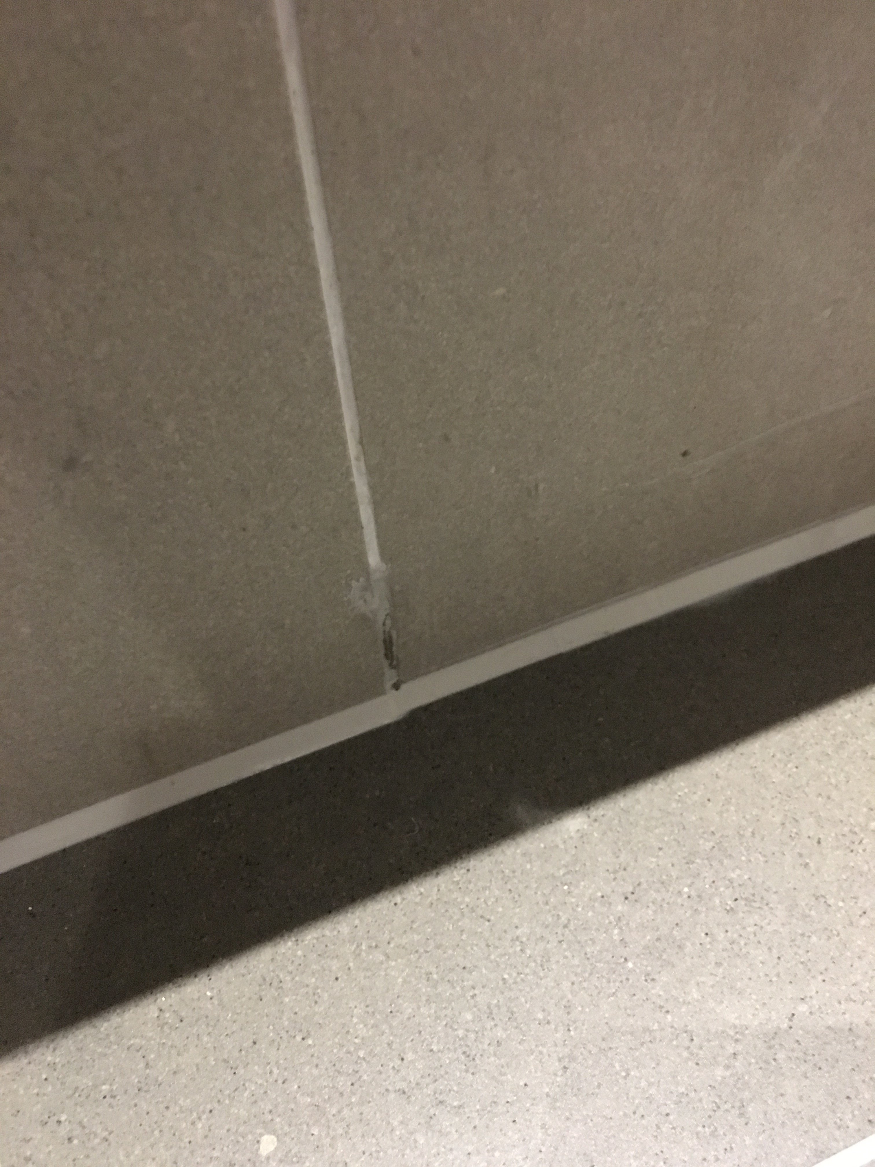

Robbie, it's really good of you to come on here and ask us for our opinion. On the whole, the standard of finish can sometimes be a subjective matter. Homeowner standards, materials, pre completed prep, time constraints and budget can have an impact on the final result. But the standard of workmanship seen in your photos is nothing short of appalling if it was a professional tiler. If it was say for example a carpet fitter who said he could do it, and this was the end result- then no, it's not appalling, bad but not the worst. To be honest, no amount of remedial work will make it look professional. It will make it less ugly, but not a first class job. Most of us on here would actually have to try hard to do a job that bad.
The thing is, if the finished article is that bad, just what on earth is going on underneath with all of the prep (or maybe in this case none of the prep). Plumbing could leak, tiles could fall off etc etc.
As for where you go from here....... has any money changed hands, who has paid for materials, what terms were agreed?
I wouldn't advise they let them loose on it again, but legally they have to be given the chance to rectify any issues. Speak to your local trading standards officers via your council. They are very helpful and will be more than willing to guide you on the legal standing on it all. Failing that, citizens advice bureau.
I wish you all the very best with it all

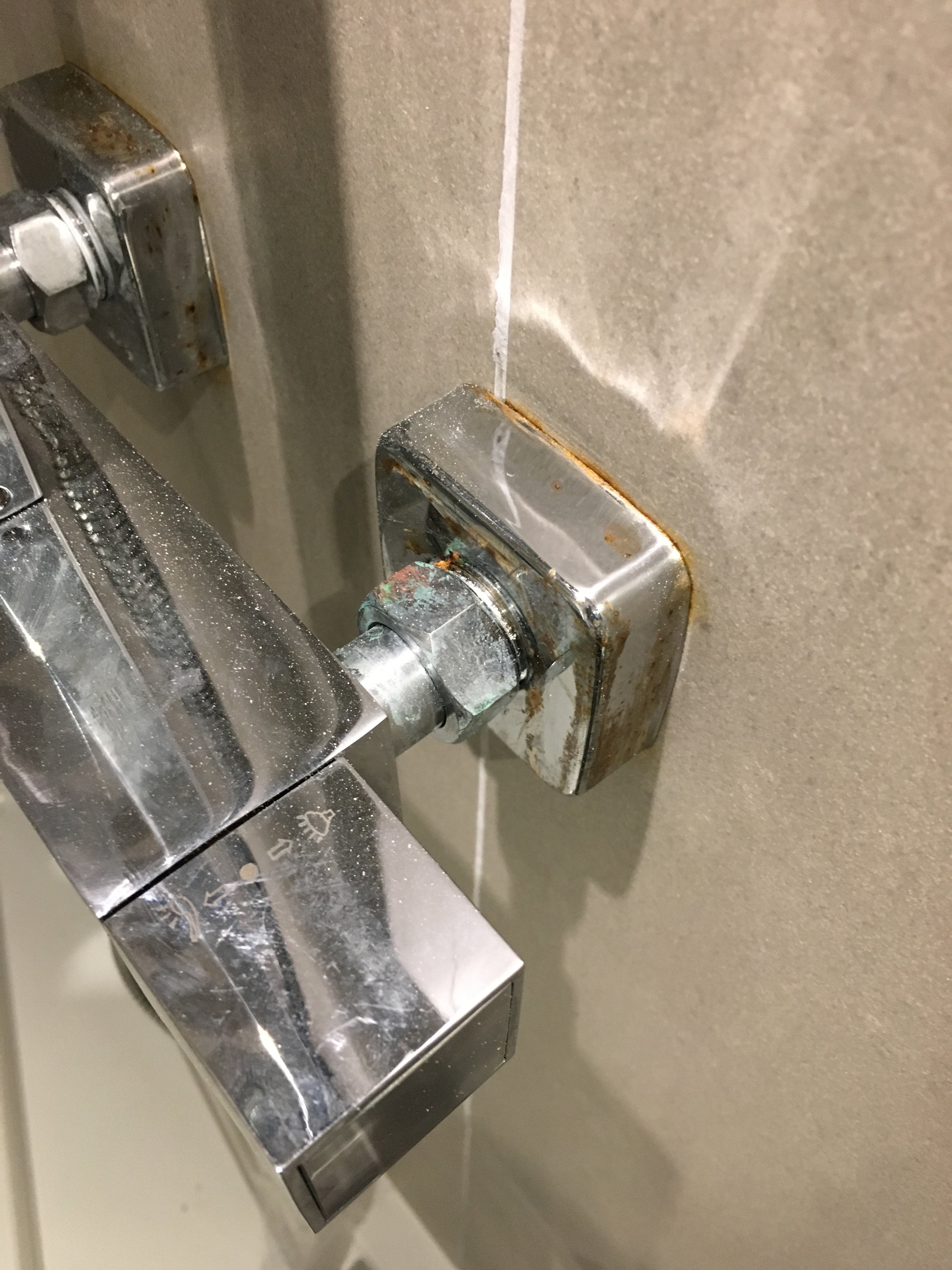

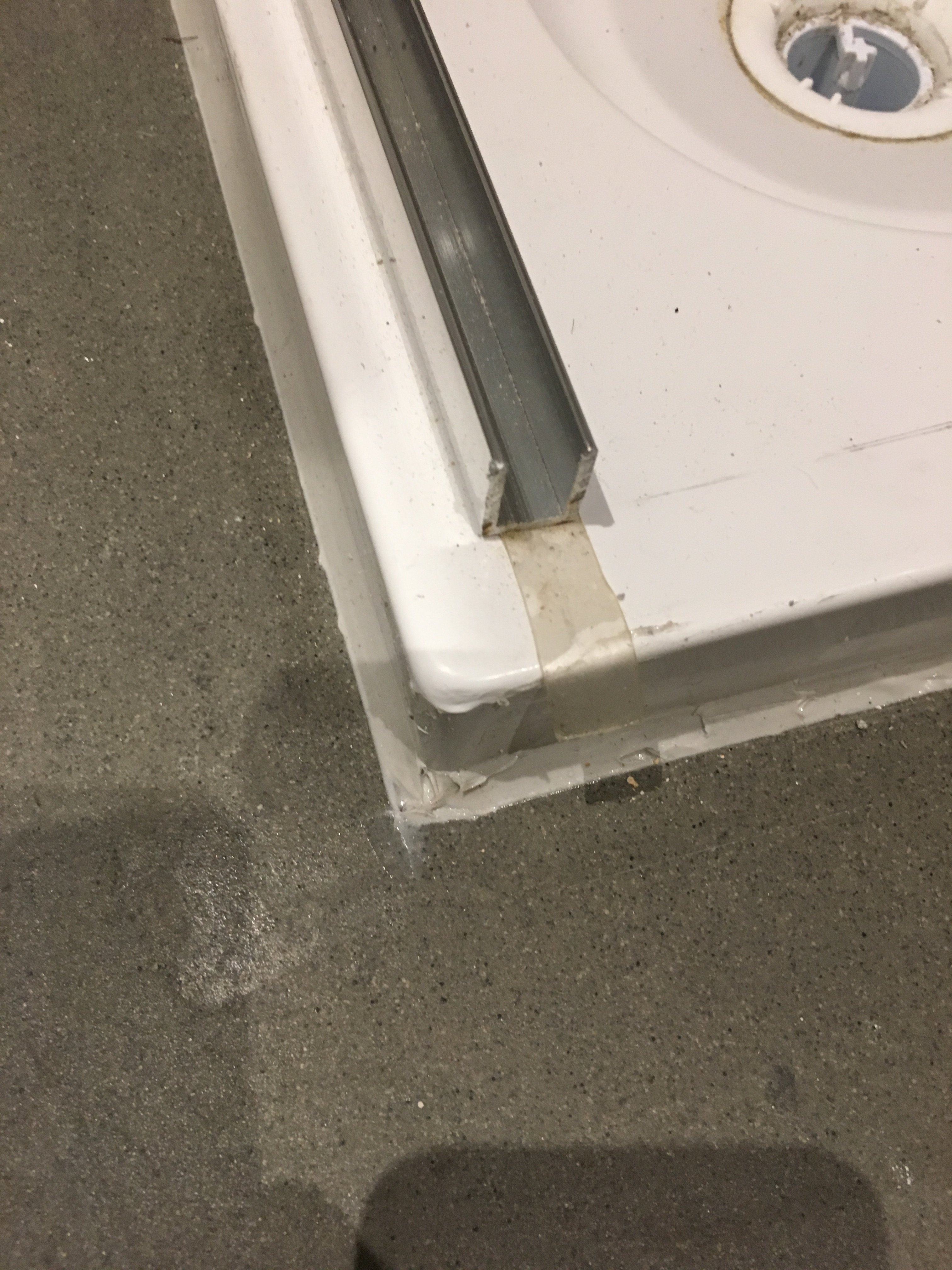

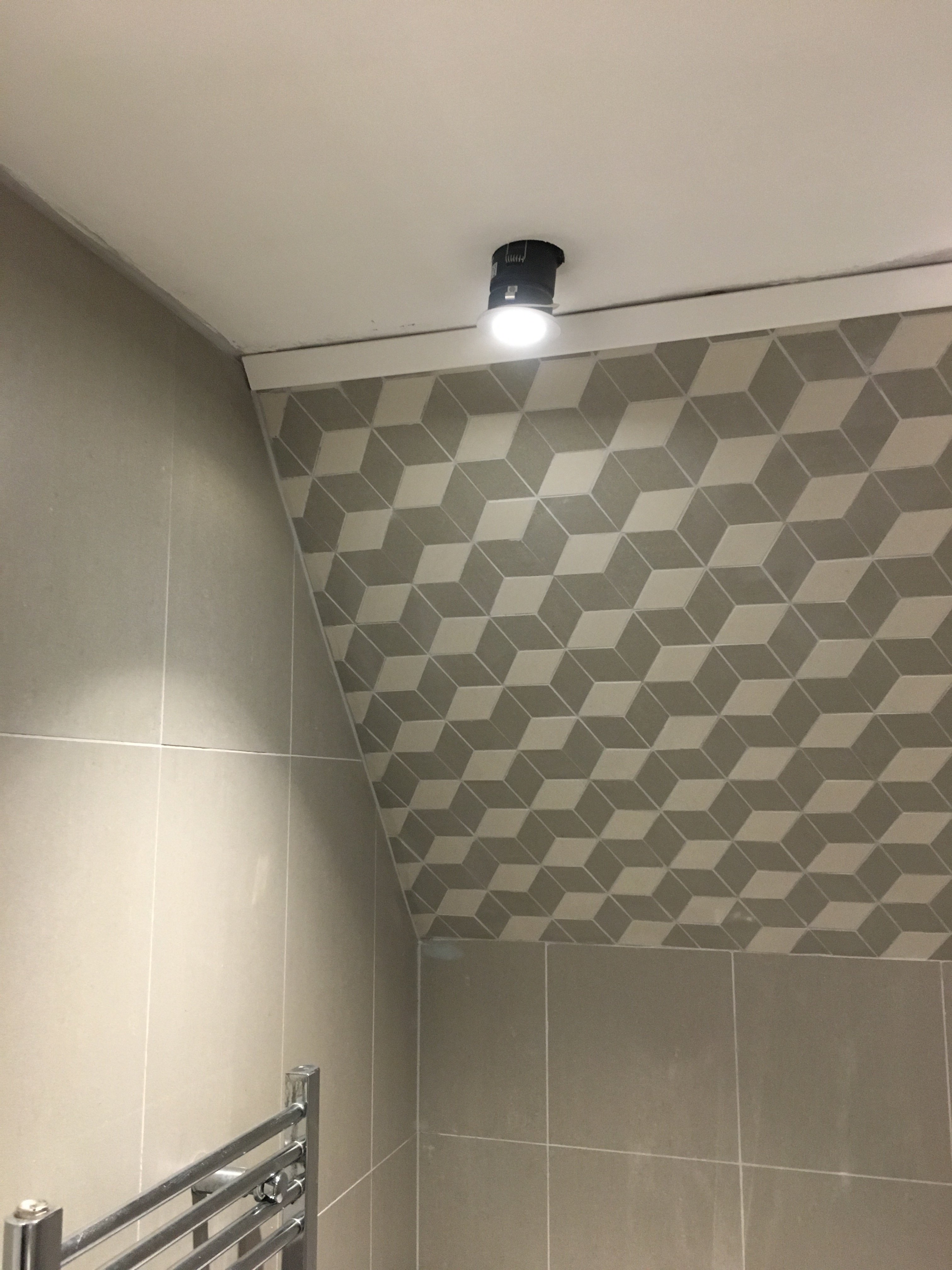

Also is that a new shower as suspect shower is old as you can see the chrome has worn off and now see the brass?
It's meant to be all be new, but as you've suggested I think it's been used previously - I'm sure I could see some limescale around the shower head. Each time I've visited I've noticed something else - just so many issues, the only way I can see this being rectified is by stripping the whole thing out. If I told you how much this has cost them I think you'd be shocked!

No point being all flowery and fair about it. It's absolutely 100% terrible. If you've not paid the morons then don't. If i was asked to fix that up, the only way I'd entertain the idea is a complete rip out and re-fit.
It is honestly achingly, toe-curlingly, cringe-inducingly bad.

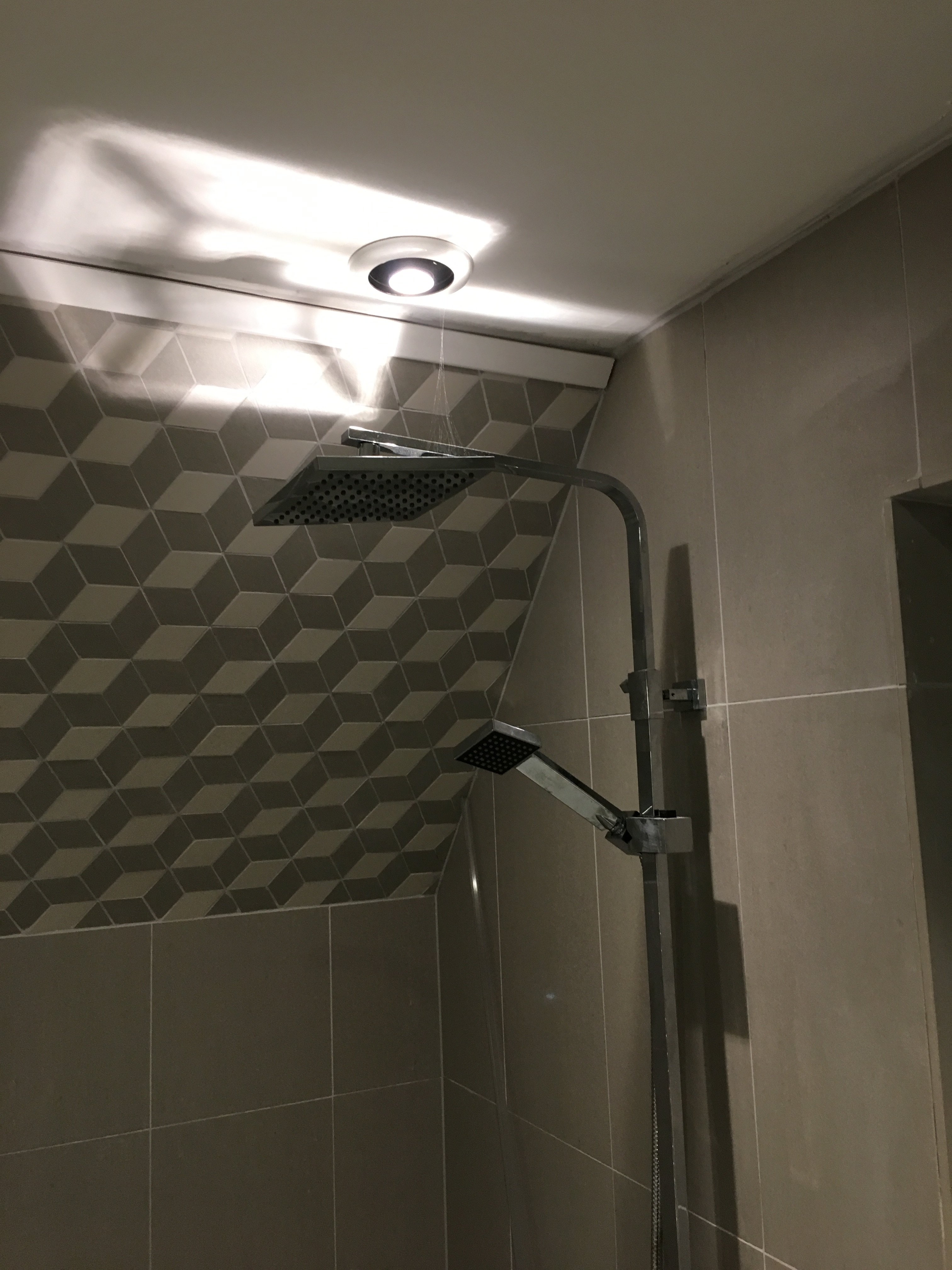

This is a Halloween horror show, inclusive of in-situ spiders web, spot to shower head @#17.

This is a shocker! I’d be worried about standing under that skeiling. To leave a job as bad as that I’d be seriously concerned about the preparation to the surfaces. I feel sorry for you and your parents. That outfit need to be named and shamed and sued imo.

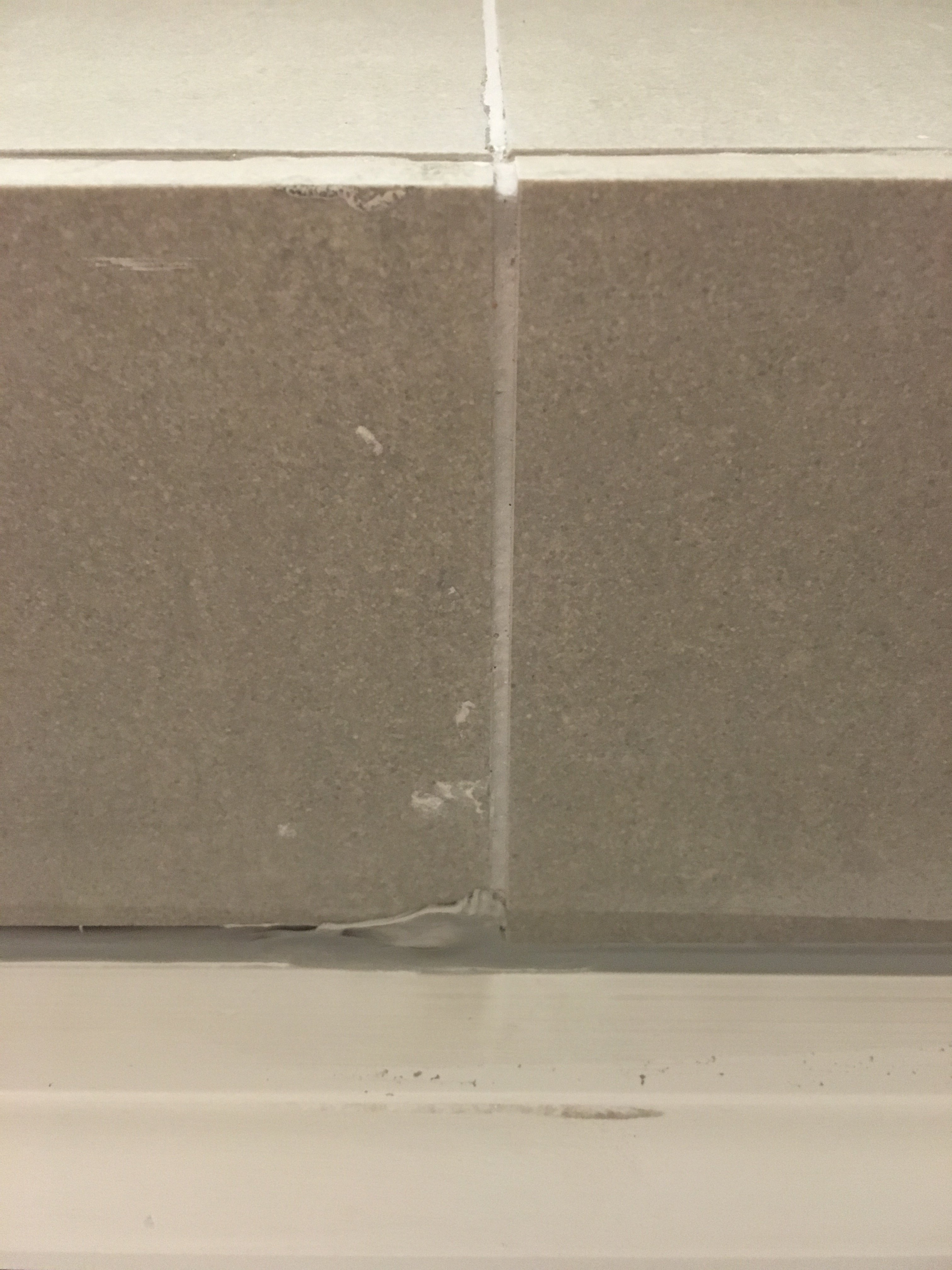

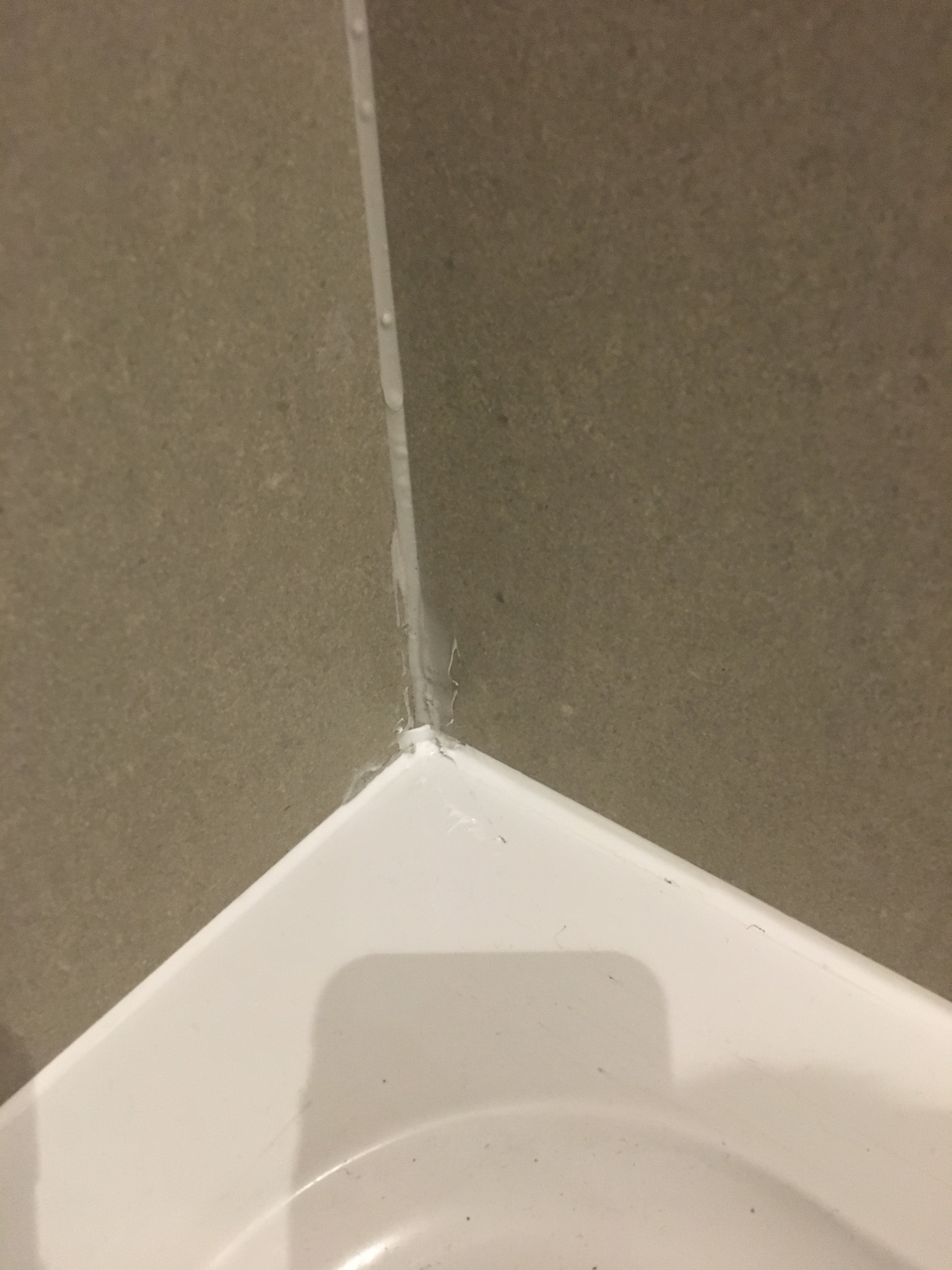

That's pretty bad. What would bug me is it is all so messy. Did they use a brick to finish the Silicon off? And at least clean the windows so there's not dirty grout fingermarks everywhere.
If I left something like that I wouldn't expect to be paid, but then I don't think anyone decent would leave a job like that anyway.
