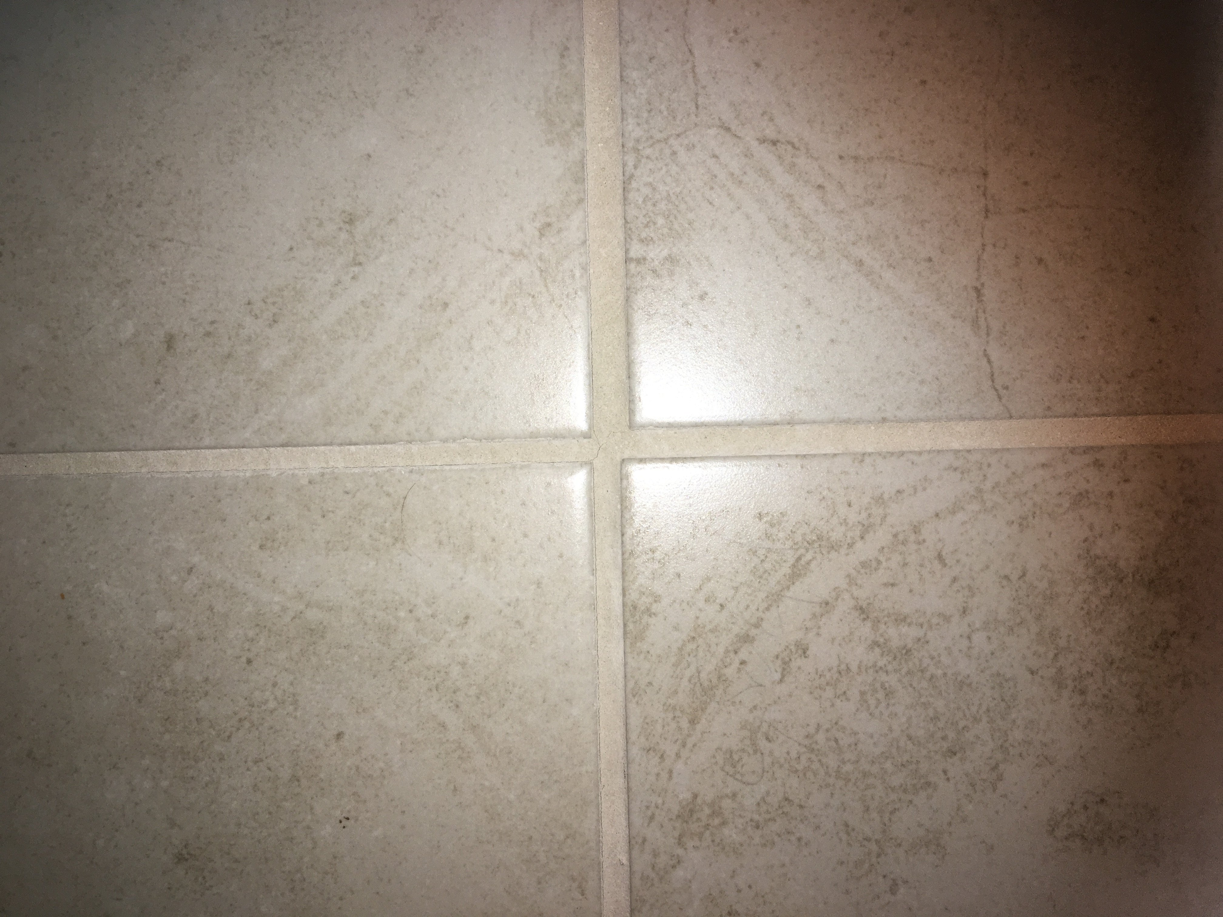

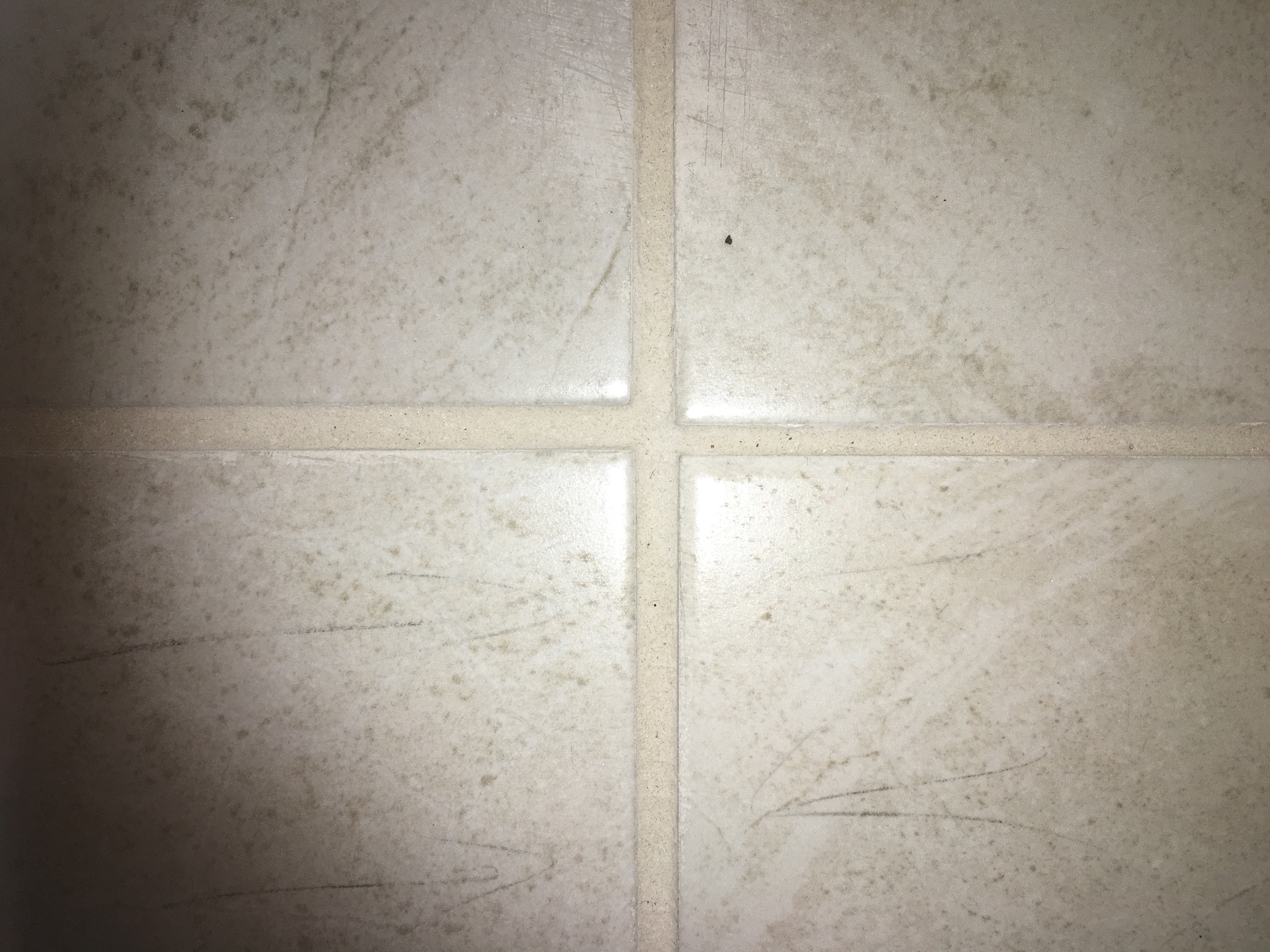

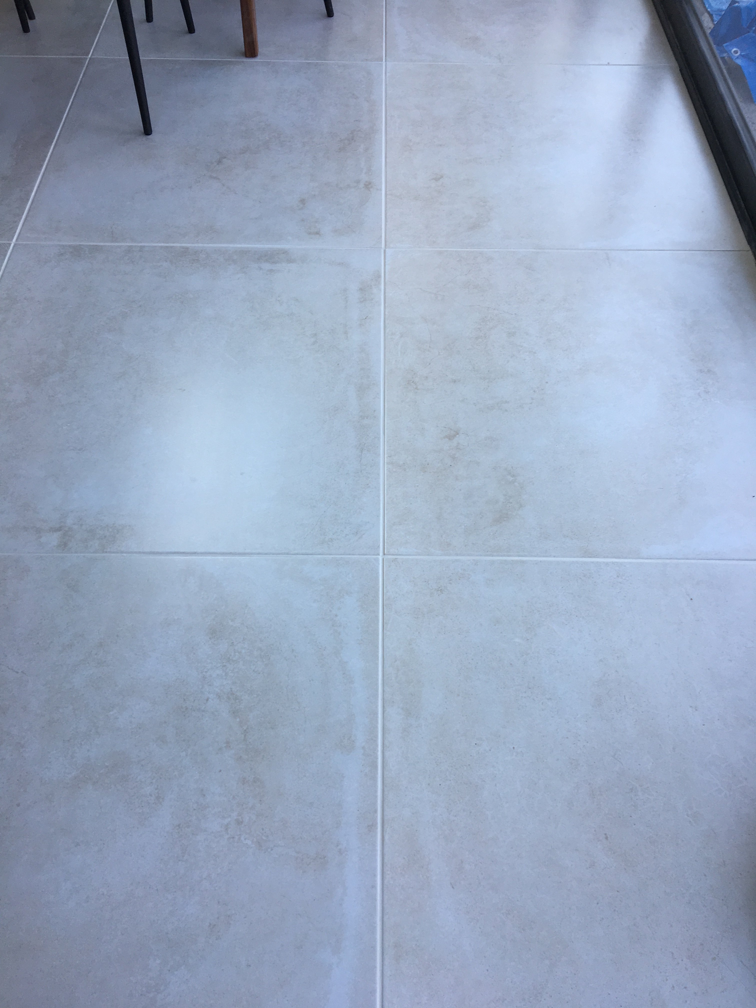

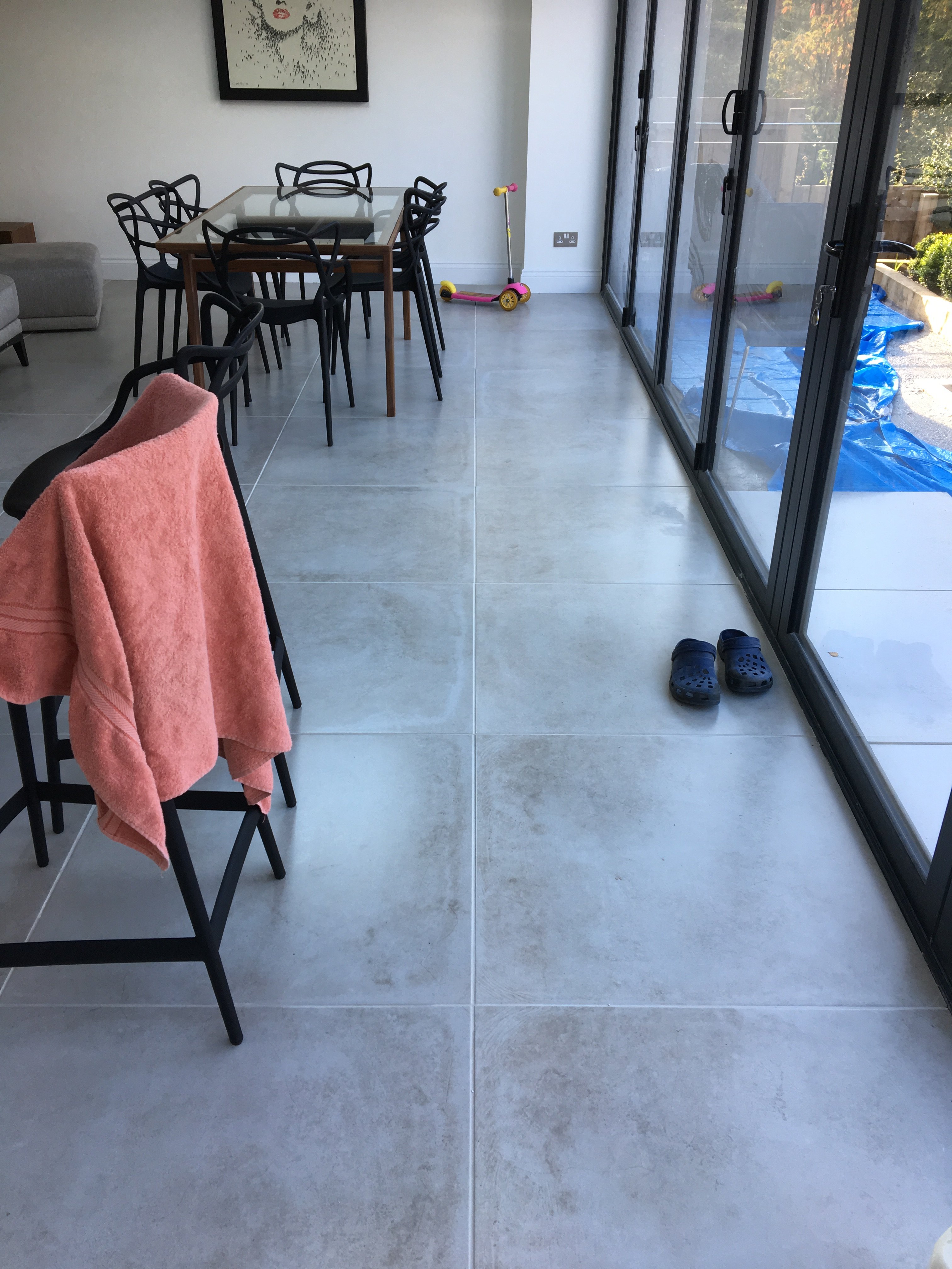

Would you consider this quality work?
I think your screed was cured, but not dry. Was it moisture tested before tiling?
If there is any residual moisture left in the screed, this will be forced upwards and once it hits the porcelain tile it can't get out and can de bond the tile.
Was the floor checked with a hygrometer before the adhesive was laid , and do you have evidence of the results ? I normally take photos
And potentially soften a gypsum-based adhesive too!
I didn't test it myself and don't know if the tiler did.
But it was left well over a month longer than it needed to be before the we tiled the first time (and it was force dried with ufh and dehumidifyers) and the second time we laid the tiles was a year later. I think the screed was dry but I can't be 100% until I speak to the tiler.
I'm wondering, any damp not getting through the porcelain - would it not also trap the damp of the adhesive too - so we'd always have a damp issue?
I've lifted 3 tiles. One is dry and two are a touch damp so it's not an issue with all of them. And when we had this issue last time and had to get the tiles up the adhesive was Rock hard and dry as a bone. So it seems odd that it is damp this time still.
Also the adhesive was one that allowed a bit more moisture in the screed to begin with I think. We checked that and it was more tollerant than the others.
Can I just say thanks again. All of this is very very useful in ruling stuff out and finding a problem. I really appreciate it.

can I ask how you clean your tiles, mop and bucket? Steam cleaner?
if the tiles had failed and grout cracked cleaning water could be the cause of the damp under some tiles, leading to adhesive breakdown.
Exactly what I was thinking.
Has water managed to get into the grout and adhesive from above?
Cleaning/dog water bowl???

Just had the same problem on a anayldrite screed.
The front door was leaking for 2years since I laid the floors (over 100m2) about 2m2 became lose and grout cracked.
Me and the owner lifted tiles , tiles came away clean, I'd back buttered , back buttering was still on tile and addy on the floor.
Addy was dusty and damp.
Looking at your bifolds and outside , could water be penetrating under the sill ?
