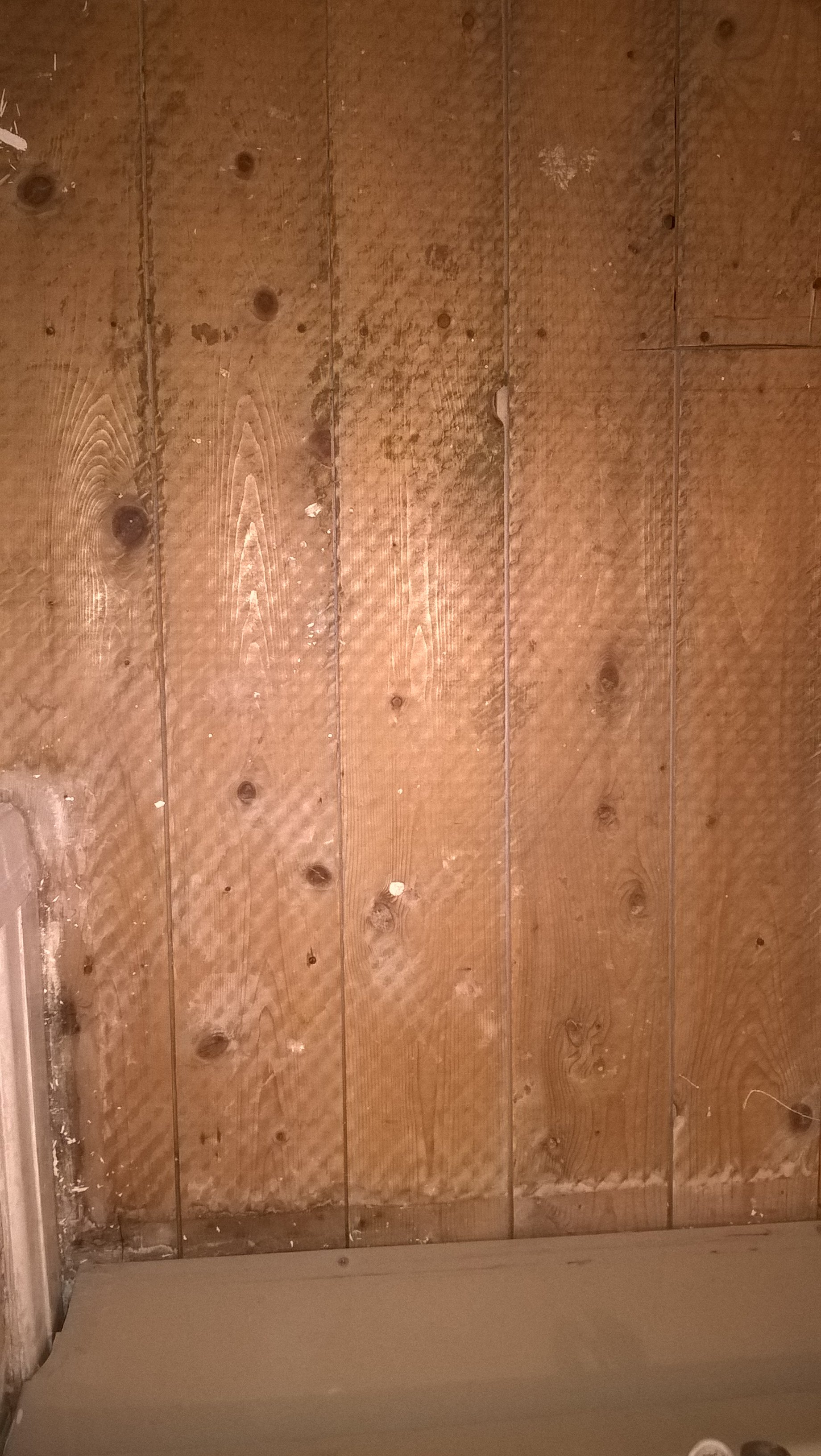

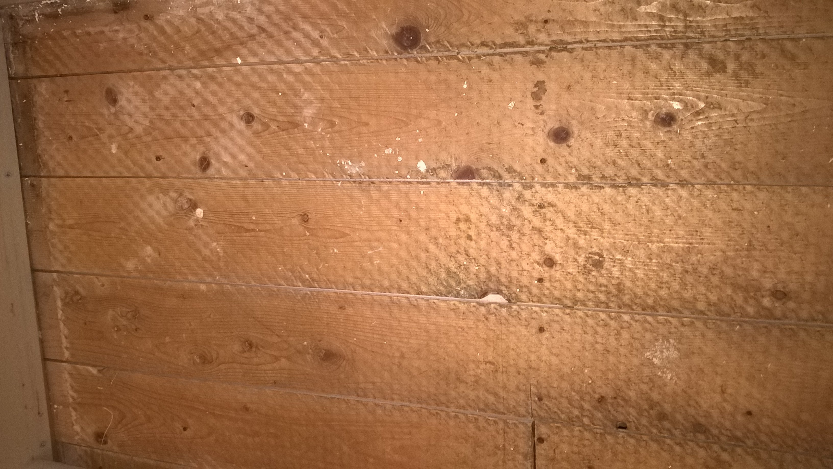

The wooden floor on upstairs en-suite is sound and level and i have planned to install a 800 x 900 stone resin shower tray. See attached photos of the floor. The instruction says to lay the tray on S/C mix.
Do i lay the sand/cement mix straight on the wooden floor or PVA before putting S/C?
To avoid S/C going into the wooden floor grove, i was going to seal the grooves with mold resistant sanitary sealant (please advice which type), PVA the wooden floor and then fix by screws 6 mm hardiebacker board to the floor and then put the sand/cement mix on the hardiebacker before laying the tray. this will increase the tray hight by 14 mm (6 mm (hardiebacker) plus 8 mm for the S/C mix). Is this is acceptable as i do not want to remove the floorboard?

WP_20181122_13_44_35_Pro_-_Copy[1].jpg WP_20181126_19_10_47_Pro[1].jpg WP_20181126_19_11_37_Pro[1].jpg

Firstly make sure there is no deflection (bounce) in the floor, those shower trays are heavy!
Tile adhesive under the Hardie before screwing to the floor. SLC over that if the floor needs levelling.
I set trays on a tile adhesive, mixed slightly loose. Silicone tray to wall before tiling.
