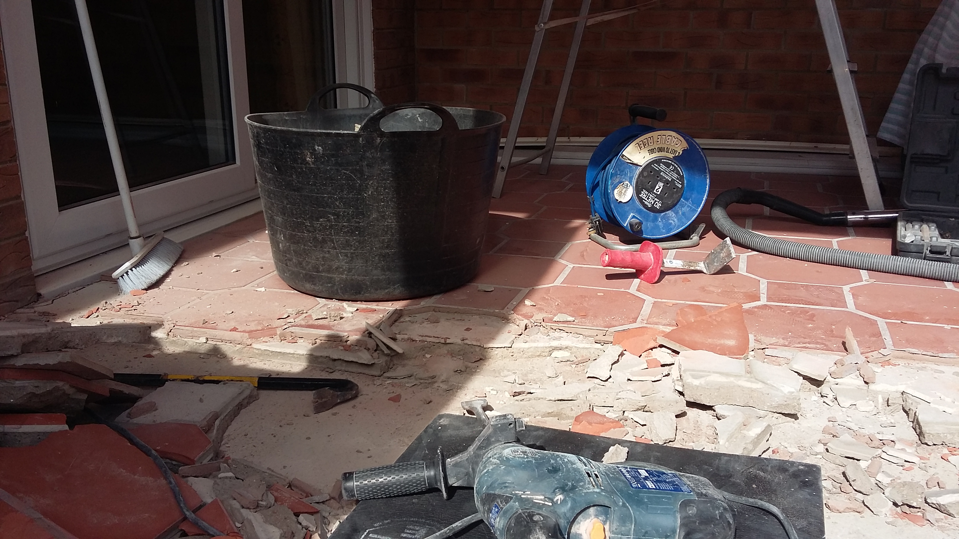

Floor finally up and it's nearly filled a 4 yard skip!
Base slab primed
Got to hit it with a load of leveller! Slab is in good knick with no cracks but really rough in places and the whole floor slopes down from the bay area to the house by 25mm. 20mm thermal boards isn't an option now so will go for 10mm. Went round
after work to set datum dots and my Dad is going to do the rails in sand and cement tomorrow. 4 bays - perimeter and halved with a small bay near the exterior door to level last on my way out.
The final finished floor height (even with 10mm boards) will be above the pvc step but I have got a plan to sort that out.
