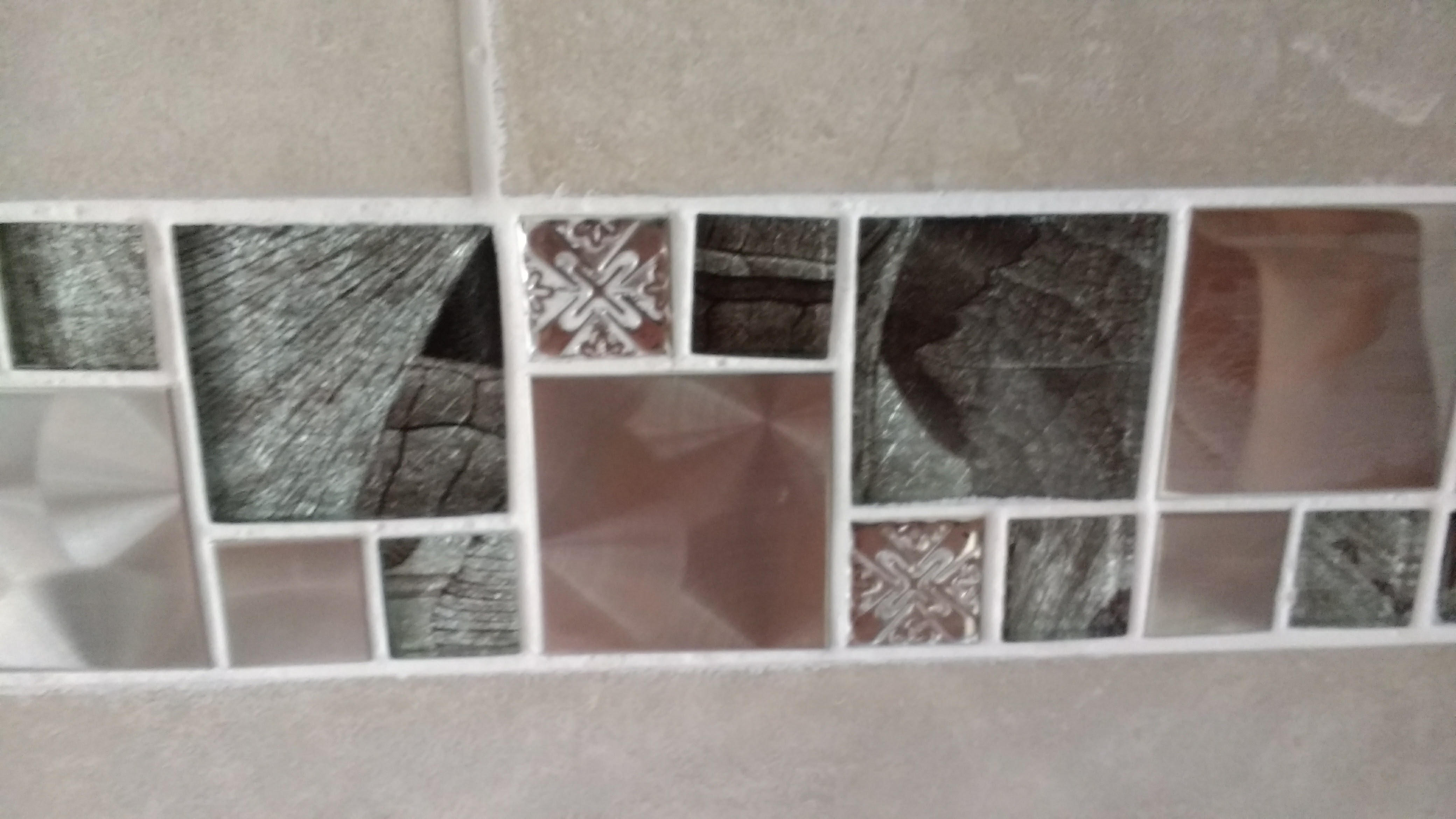

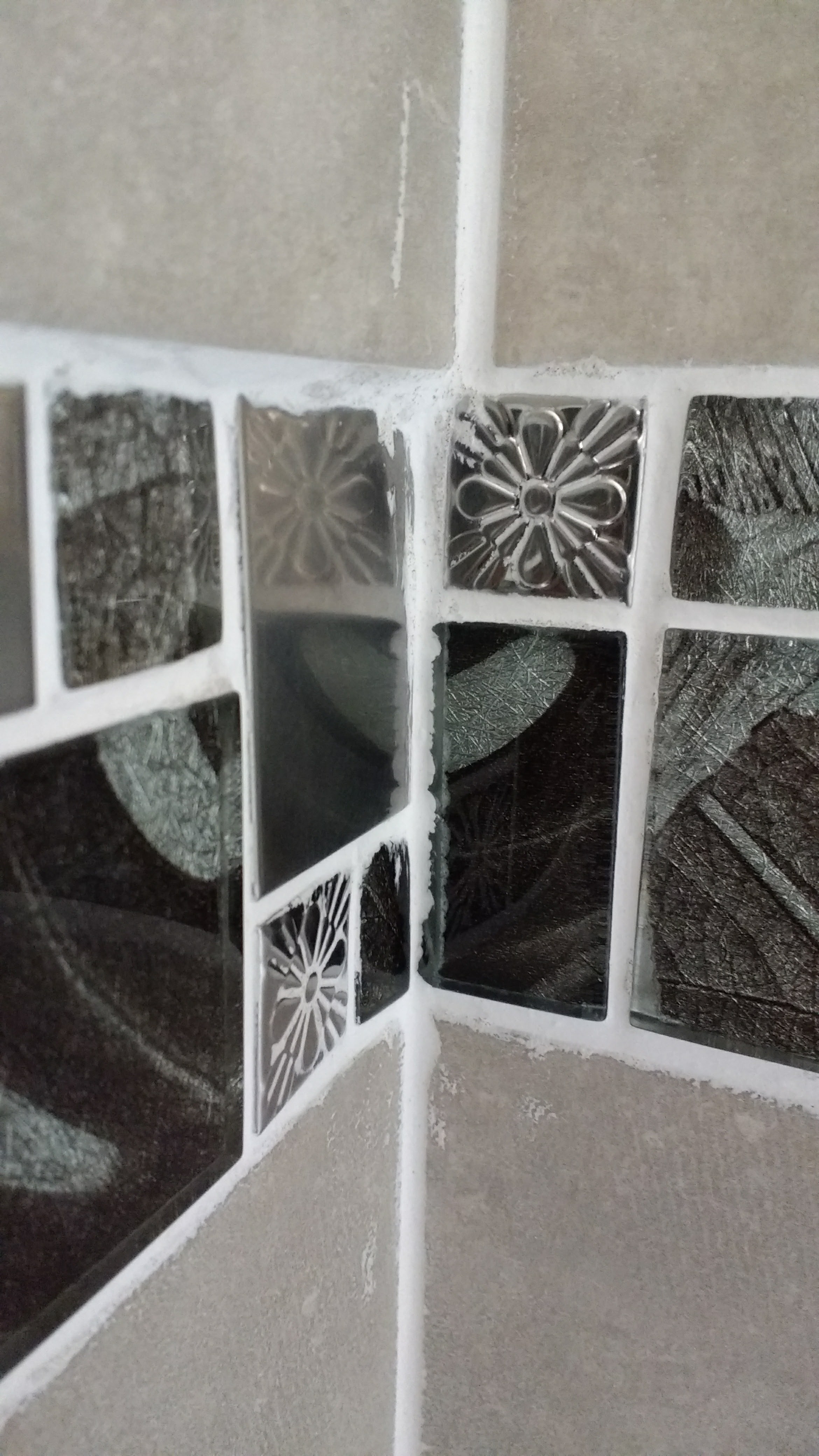

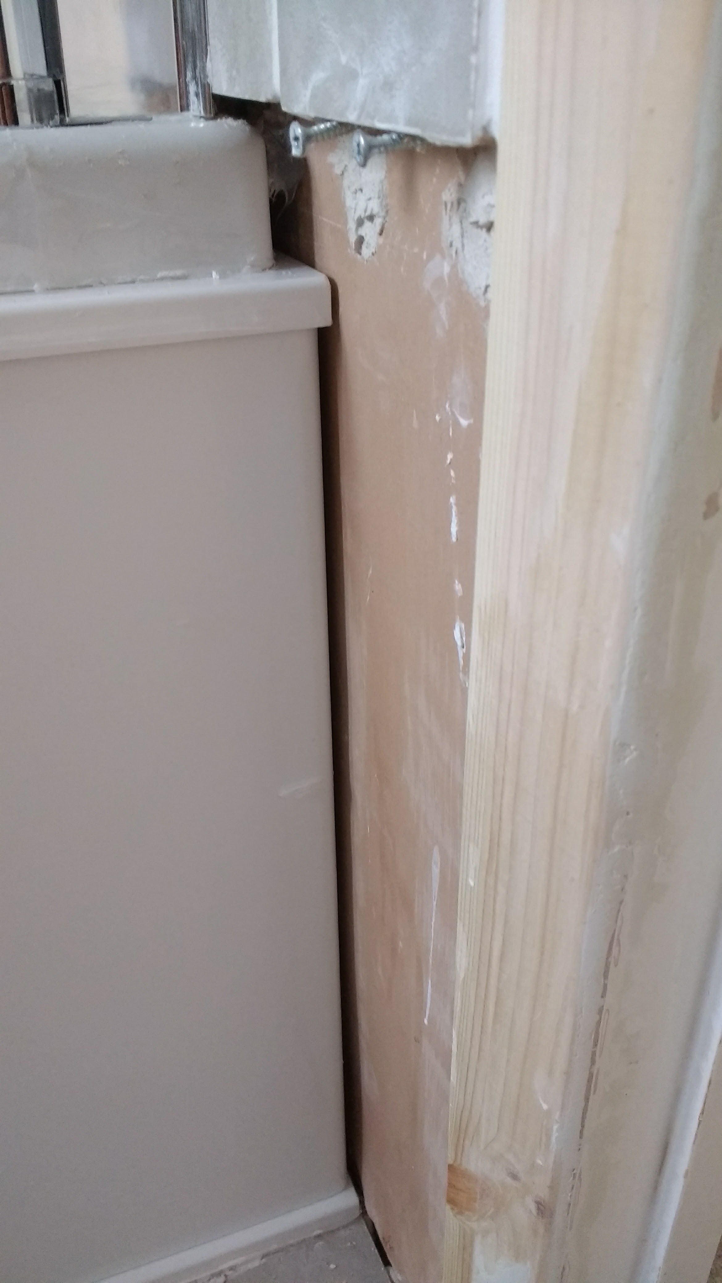

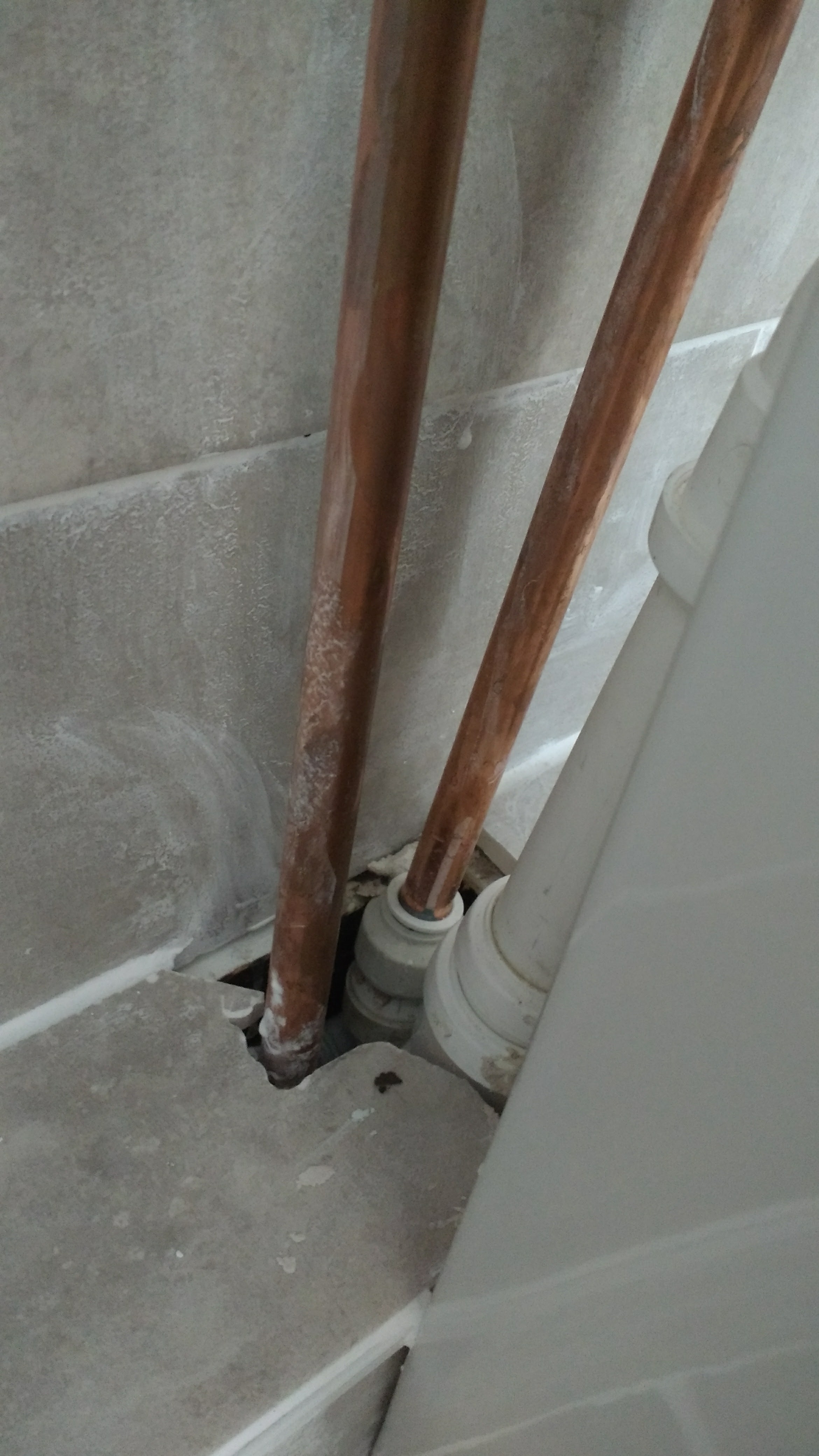

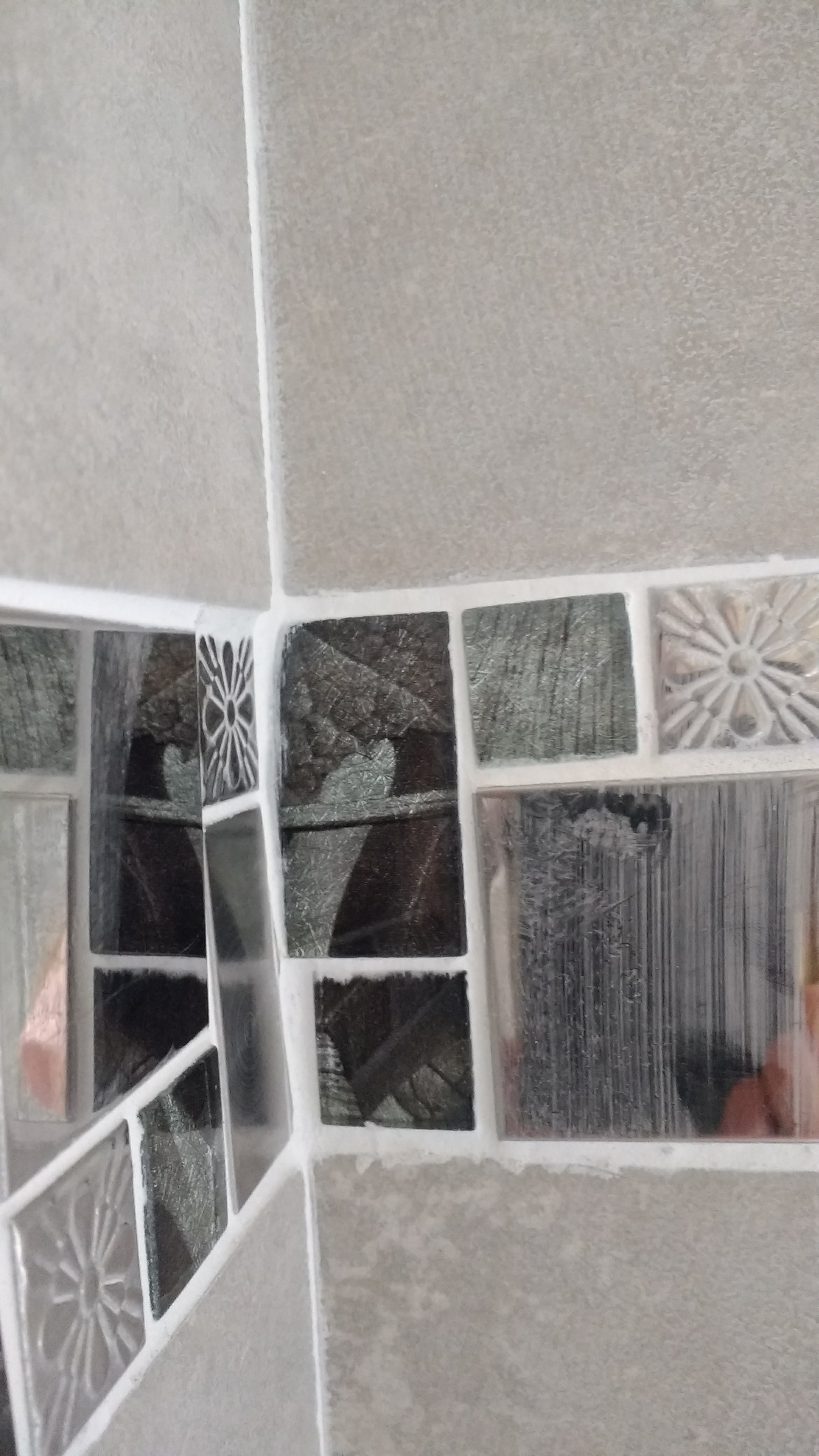

Hello, I am new to this site and seeking some advice on the tiling in our new bathroom.
We are really unhappy with the quality of the tiling and have voiced our concerns to the plumber (he also did the tiling). He says he did the best job he could and blamed wonky walls and a difference between the thickness of the wall tile and mosaic border for the defects (the walls were re-plastered prior to him tiling by a plasterer he chose, he sub-contracted the work out).
He believes he has done a good job and cannot understand why we are not satisfied. Surprisingly he said he would be willing for us to deduct the cost of having the issues rectified by a tiler of our choice and he will also agree to us deducting the cost of replacing tiles from his invoice. It was agreed that we would pay on completion so we haven't paid anything yet as the job isn't finished.
We have since had 2 different tilers come and take a look and both have suggested that all the tiling needs to come off and the bathroom suite will need to come out beforehand to prevent damage. Depending on the condition of the walls underneath the walls may need plastering again and then the bathroom suite would need reinstalling. So basically it would be like starting over again.
I have told the original plumber what the 2 tilers have said and he says that they are probably just saying that to get extra work. He is now asking for part payment to cover the cost of materials and the labour for the work he sub-contracted out and we don't know what to do as the quotes we've had to rectify everything are around the same as the total amount he is requesting!
I have tried to attach some photos of some of the issues (there are so many!) but I can't figure out how to do it! I've added 2 pics under Poor workmanship? I don't know whether you will be able to see them? I would be so grateful for any advice you can offer me. Believe me, I don't like complaining and I am truly devastated it has come to this but I stand to lose a lot of money if I pay him and do require the whole lot doing again. He is not willing to put right his own defects either so we're stuck!

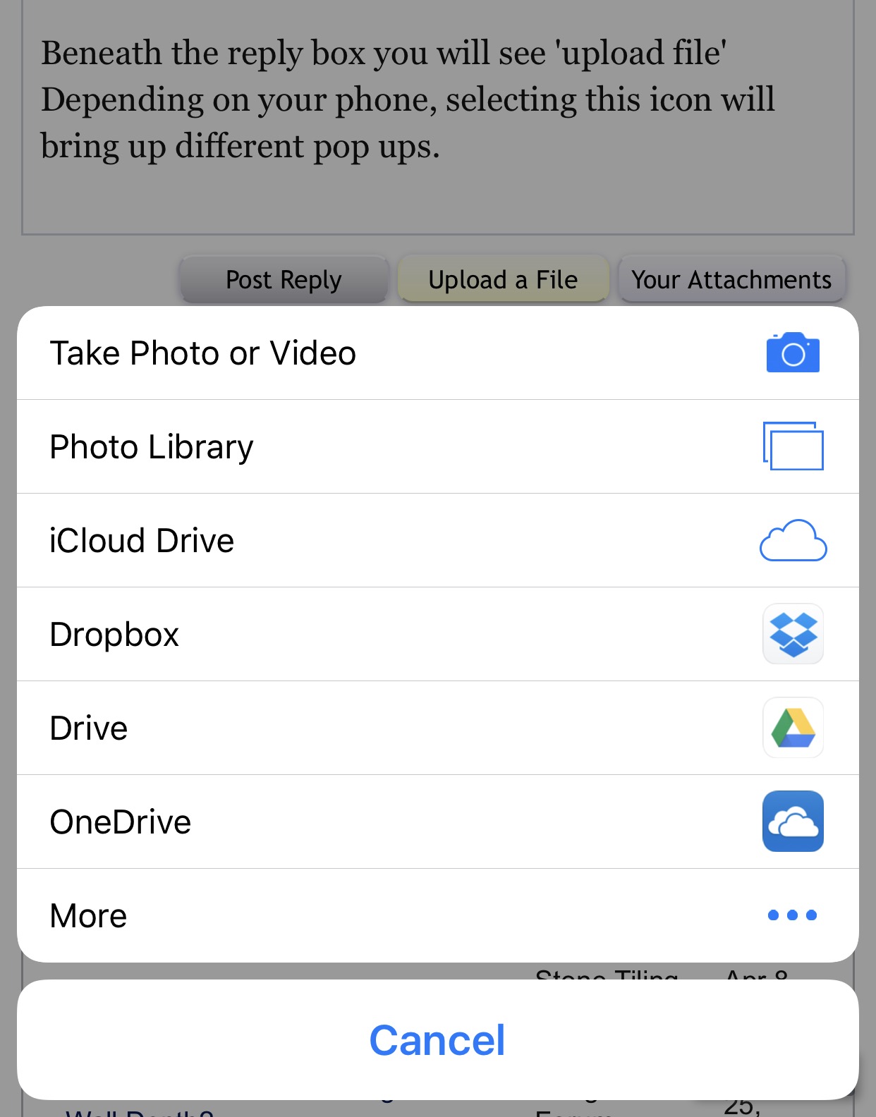

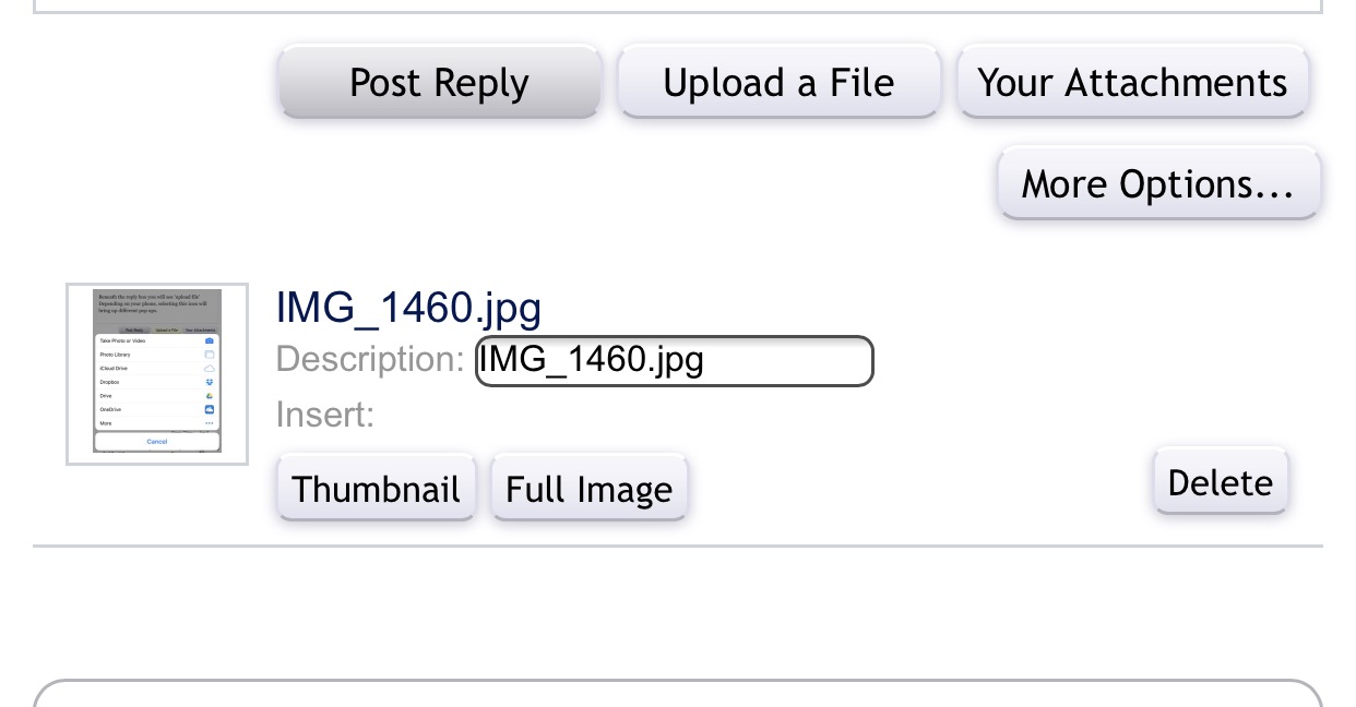

Hi Karen,
welcome to the forum, shame it's not under better circumstances.
Beneath the reply box you will see 'upload file'
Depending on your phone, selecting this icon will bring up different pop ups.
This is mine.
Select which source to select your images from.
I believe in some phones it says 'files' or similar.
Once in your photo album, select your required images, all at once, in the same way you would with FB, if you use it. :)
Once selected, click done.
The images will then load beneath the reply box like so.
Once they have all uploaded, at the top of the list you will see an icon that says
'Upload every image as'
Select 'thumbnail'
They will then all upload in to your reply box.
Then just select 'post reply'
They should then all be contained within your post.
Any problems tag me with an @3_fall using the @ sign, prefixed to my username.
Or select 'contact' below my avatar and it will generate a 'private message' and we'll see what we can do to help.
Good luck. :)

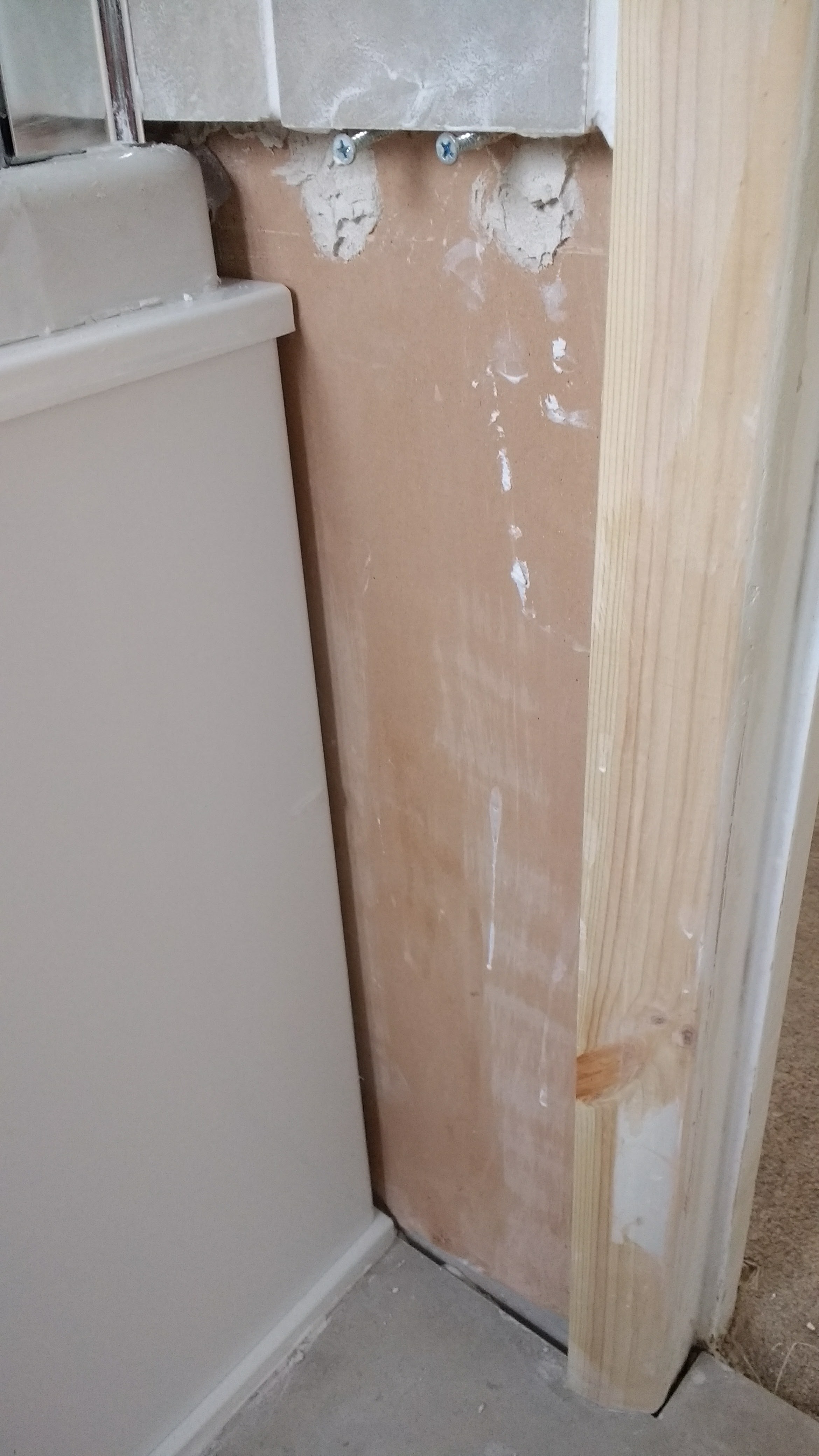

I think I would prefer to start again as the joints don't seem to line up and the tiny slithers are not great I think it would be more work to try and make it look good did you see what adhesive your plumber used ?
Unfortunately not I didn't. Both the other tilers who came to look said there is no way they'd be willing to patch it up and they believe I will struggle to find anyone who will. The original plumber is not willing to come back and re-do it (probably a good thing).
He said that he did the tiling to the best of his ability and blamed the walls (said they were wonky) and the fact the mosaic tiles were a different thickness to the tiles for the finish. The mosaic border is a fair bit thinner than the tile but surely this is common? We spent a lot of time looking at borders and tiles and the mosaic borders were always thinner.
Thing is as well, he sub-contracted for a plasterer to come out and plaster the entire room so if that's the case why weren't the walls straightened? Surely the plasterer would have picked up on that as he knew they were going to be tiled? Our contract is solely with the plumber, he sub-contracted work out to a joiner, plasterer and electrician. I can't fault the electric work although we have received nothing to say the work has been signed off.
The plumber is asking for part payment to pay the sub-contracters. However, if it all needs ripping out the plastering may need to be re-done so why should I pay twice? Also, on one of the pics it shows how the tiling is flush with the architrave then further down the tiles protrude out past it so the architrave will need to come off as well. Also, the skirting the joiner did is not even attached to the wall yet so the work is unfinished. Yet the plumber is refusing to come back!

One other thing I haven't mentioned is that on 2 walls and then at the bottom of the third wall he has used a brick effect pattern as we requested. However on the wall around the window he has just stacked them one on top of the other so he's used a different tiling pattern for that area! He hasn't even finished tiling into the window alcove either, that is still bare plaster.
Now that I have posted more pics, I would be really grateful for people's opinion on whether this is satisfactory and whether the problems could potentially be rectified without ripping it all out? The plumber has said anyone we get out to look will say it needs ripping out because it's more work and money for them, in other words he is suggesting they won't be honest. But as he is unwilling to rectify the issues himself I don't see what choice we have?

Don't pay anything out until you know how much the rectification is going to cost,
or you will end up paying twice.The cleanliness of the "finished job" is an indication of
the quality of work unfortunately, good luck.
The issue I have is no tiler is willing to rectify it by putting right the defects, all so far have said it needs to come off altogether and start again. I've had another come this morning and say the same thing so 3 different tilers now. The plumber argues they're just saying that to get more work and money but I genuinely don't think they are. All 3 are inundated with work, the earliest any of them could do the work is in 5 weeks time, one said it would be November!

As you havent paid yet you have the upper hand. He wont come back and if he did would you really want him there? He's blaming the walls but they were plastered on his recommendation. Get one of the other tilers in (probably qualified) and get them to do a total refit as the recommend,they sound like they know what they're doing. Hopefully you get the job done at no extra cost to yourself.

As above. Finishing and remedial works are required, whether a total rip out is necessary - additional photos may be usefull (showing whole walls etc,) to get a overall picture, the attached pics definitely shows the devils in the detail). As your plumber had carried out the tiling works, what expectation/standard of workmanship can you reasonable expect, that of the average plumber doing tiling work?.

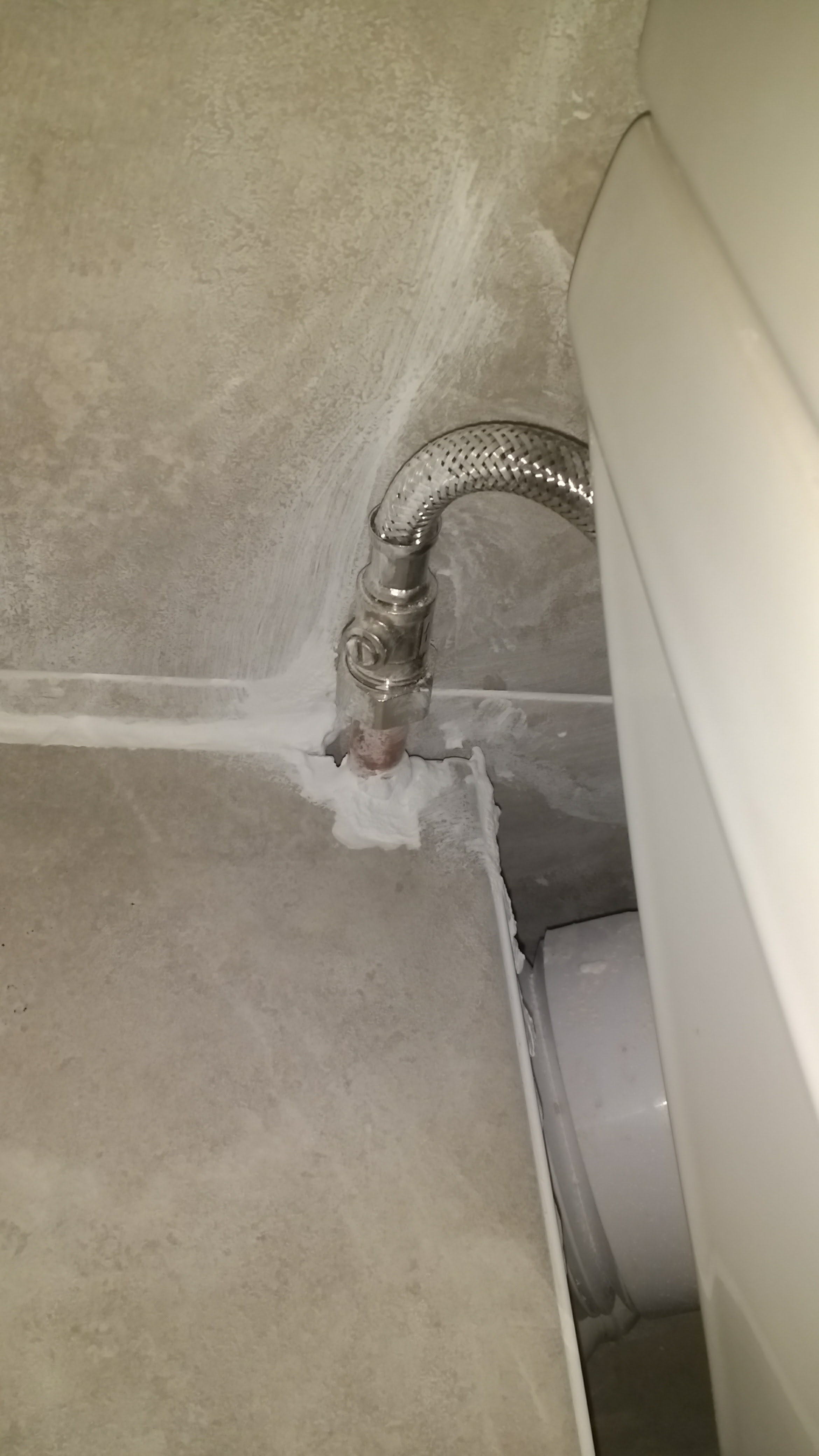

Ps.. if he's a plumber he's not a good one,that flexi-hose seems to have a too tight "kink" in it,this could affect your water supply to the tap,get someone to look at it,hope you get everything sorted.
