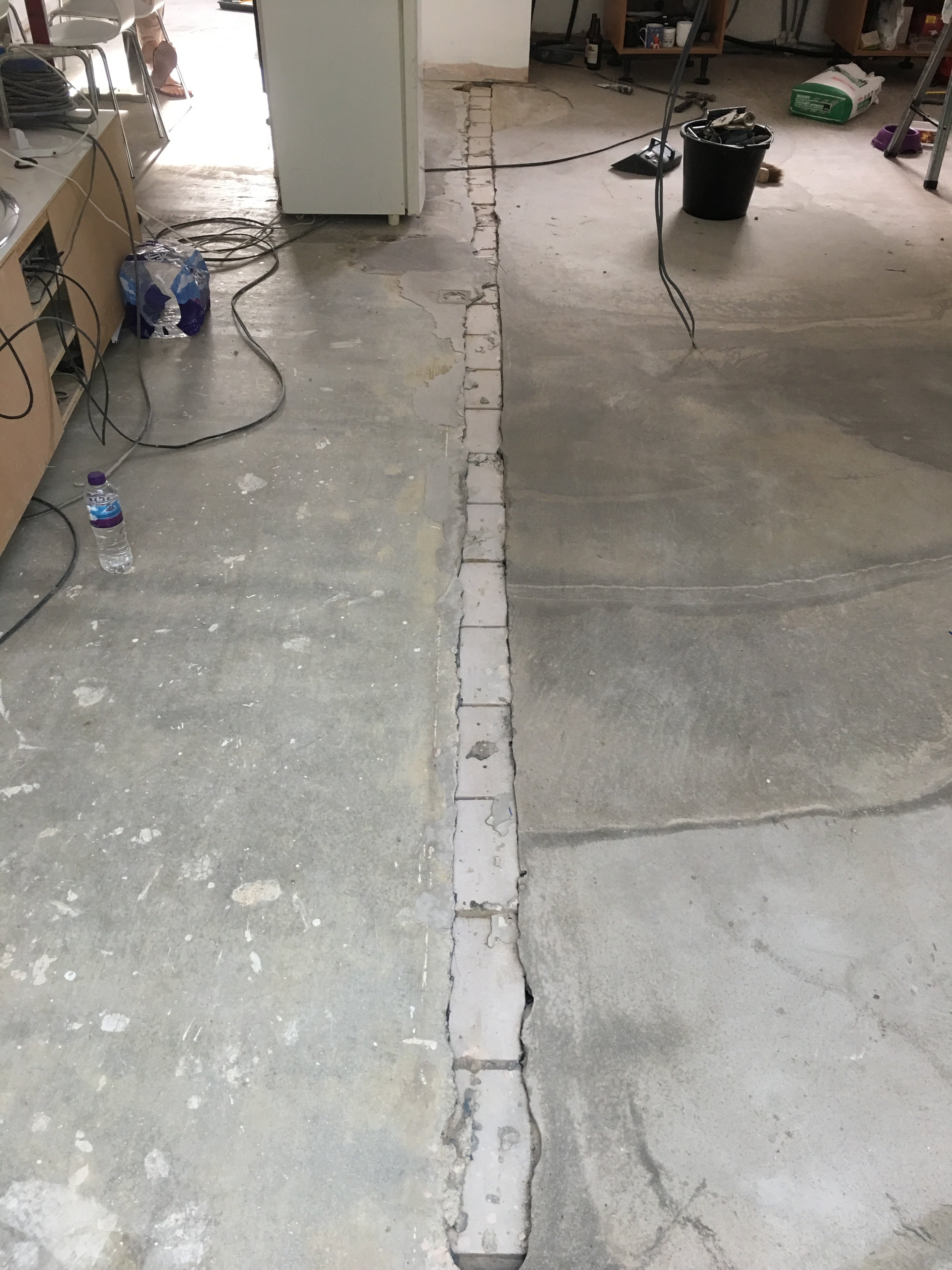

Should have walked into a job that was left"perfect" by the customers builder on Monday but its gone to pot.
Long story short its been down for 6 weeks but the Laitance had not been removed. Builder had no idea what it was. Has done loads of these floors apparently.
Also two substrates (old house and new extension) meet each other. The Anhydrite was not bought up to the same level as the old substate so he has used cement based SLC up to 15mm / 16mm in places. Not that this made it anything close to level.
All SLC around 45m2 was pulled up by hand much to the customers disbelief.
I am tackling this in stages as the customer will be claiming back costs from the builder.

Problems are new screed and old substate are different levels 15mm at highest point. 9 inch brick between old and new substrate. Floor is almost 13 meters at longest point by 6m.

You can get gypsum based levelling compounds to sort that out. Expansion joint neeed within that 13m length
I was thinking of Arditex CL for the SLC. Would you agree? The tap is yet to be installed so 2 part works well.
I will upload a picture of what I mean by the two different substrates being divided by brick. Its not shown in the picture but it curves round to all the way to the wall. Where is curves round is around 6m into the room so I can use Schluter Dilex Ex (any other recommendations are welcome) expansion strip across the entire room. I am not overly sure of what to do with the expansion joint where you can see the bricks.
Picture was before the SLC was taken up.

I’m glad it’s not my job!
Its a dogs dinner.
Any ideas? A soft joint won't be enough but anything else will look terrible. How do people get round this. Extensions being built next to existing substrate is a common thing.
