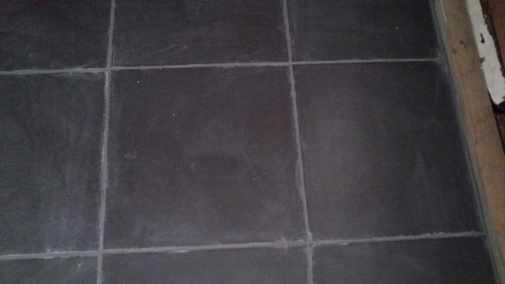

just started buffing off the tiles and there is still a residue from the grout I cant seem to get off.... do these tiles require sealing or something I havt had this issue before and they never said anything in the shop about seling them. cheers
