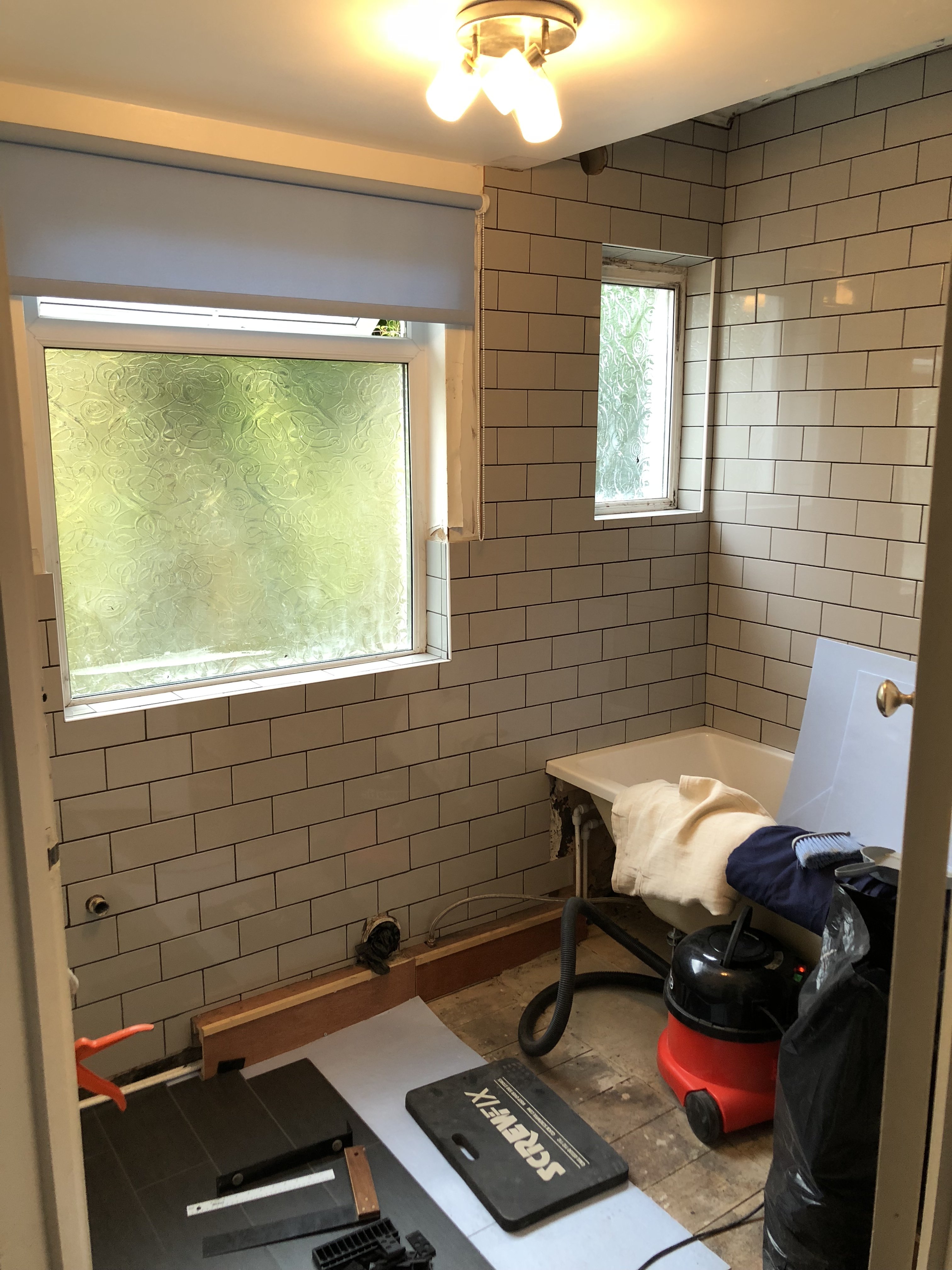

Cheers guys, I ended up using about 7 spirit levels propped up by shims around the bath, tiles and anything else I could get my bass on.. don’t think it turned out too badly?

From a distance it looks reasonable, James but when you look at the windows, the trim and some of the lips, grout joints not lining up etc you soon realise that you have a lot to learn as to what would be considered acceptable.
You need to get things spot on in this game.
The large window reveal, small tile on the right. Did you really look at that after fixing and thing that was OK? You need to maintain your grout joints everywhere. No lips.
