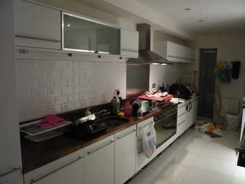

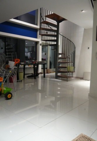

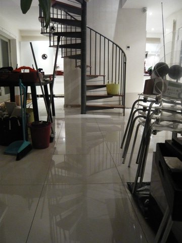

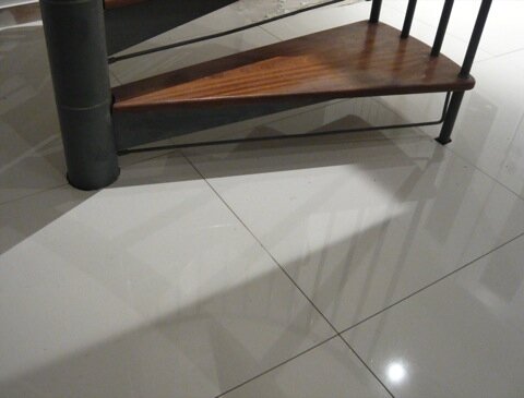

i just used some benferflex to lay some 600x600 polished porc and i thought it was fine. seemed to take a bit longer to set than dunlop or pci that i normally use but it is cold it the room i was working so i put it down to that
