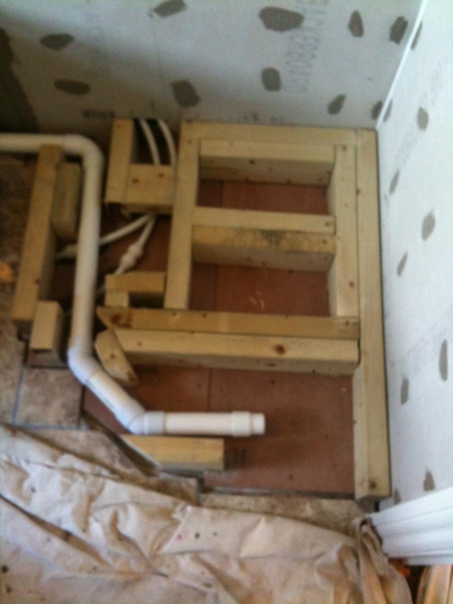

The original shower trays had been fitted with plastic legs so when I removed the showers I built a wooden base for the showers, picture 001 and 002 show some of the construction pictures.
The marine plywood that you see in the pictures is 20mm thick. The marine plywood was glued and screwed to the original chipboard flooring.
You can also see the floor tiles in the pictures next to the marine plywood.

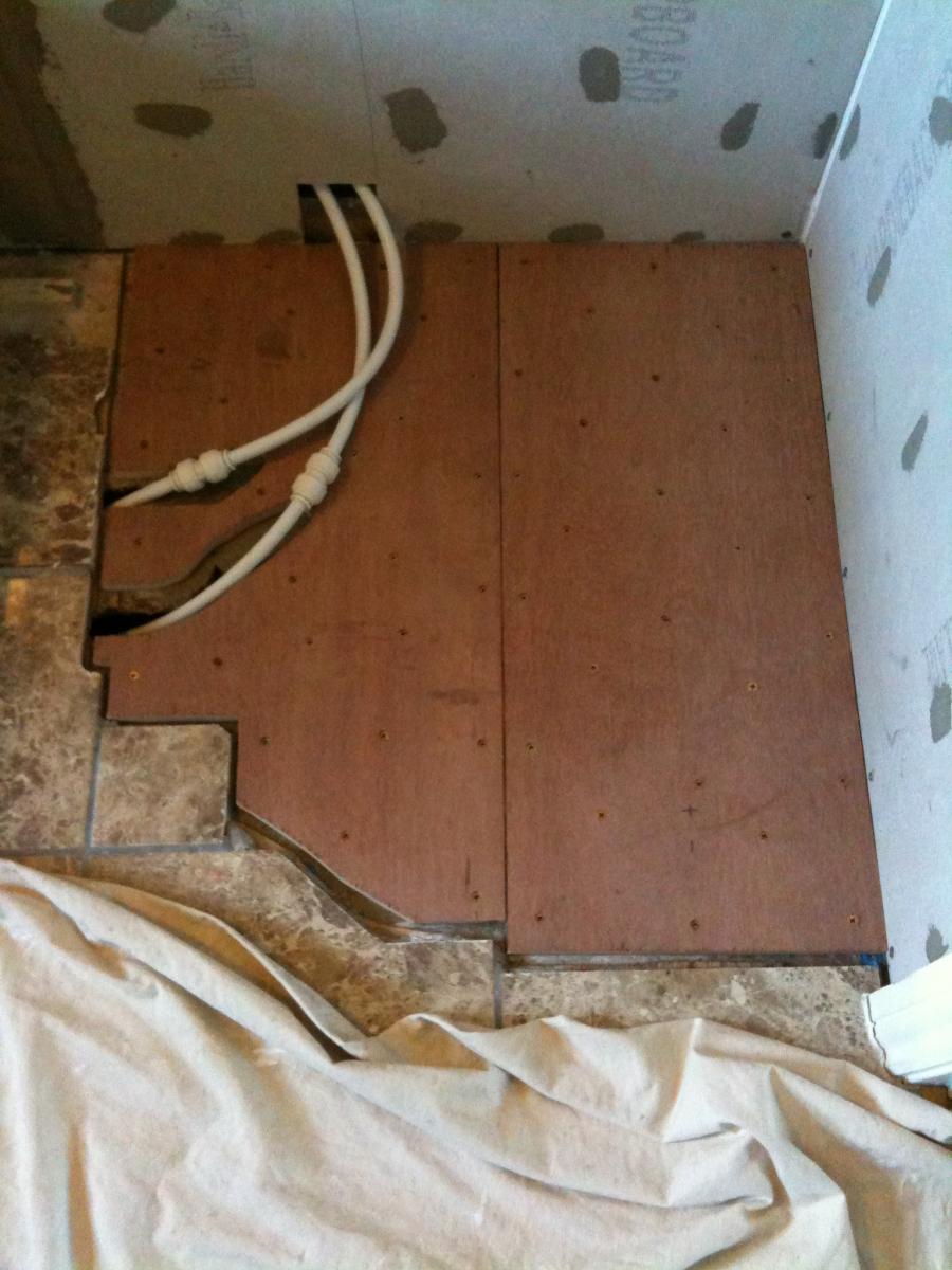

Picture 003 shows the floor tiles that need to be removed.
