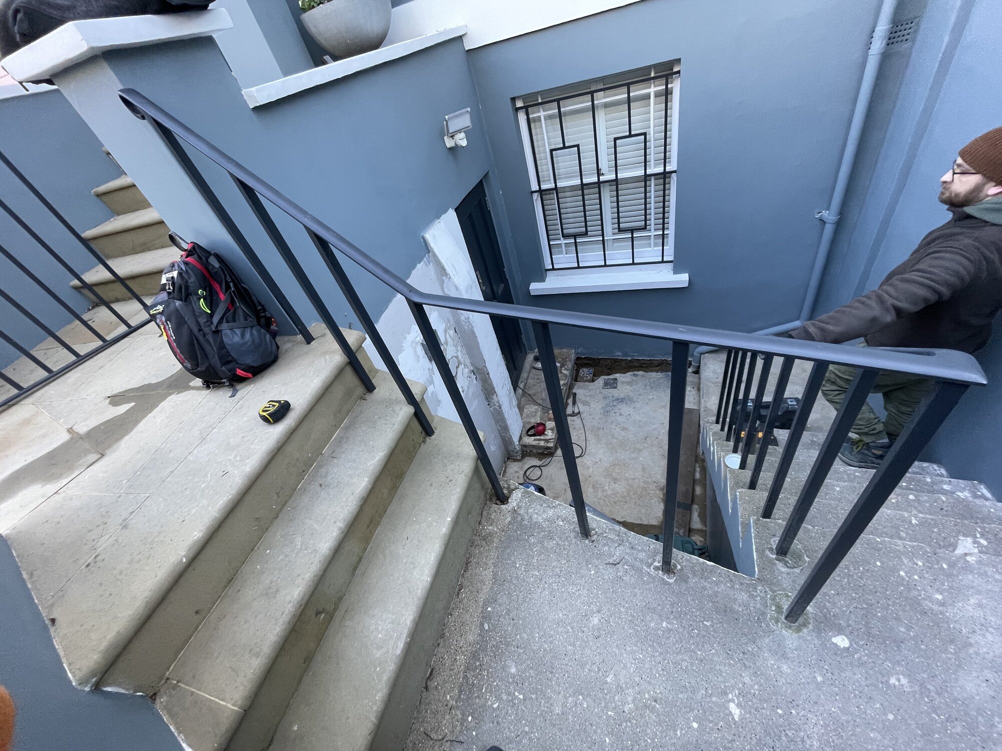

These are the steps:
Buff Yorkstone steps

Cuts edges would go to the back. Or are both edges on show. ?
Do you have any pics of your project?

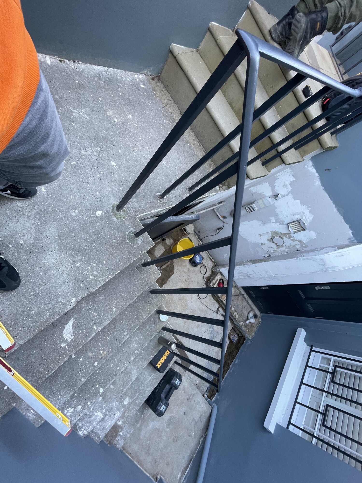

Hi, back and one side are covered but right side will be visible.
Thanks

What’s your intentions with the handrail?
Ok i see its more bespoke work entailed. A rail saw and diamond pads required
Hi, planning to remove the rail and modify it with help of a welder to make attached on the side of the stairway as don’t want to make holes in the steps.
Thanks
