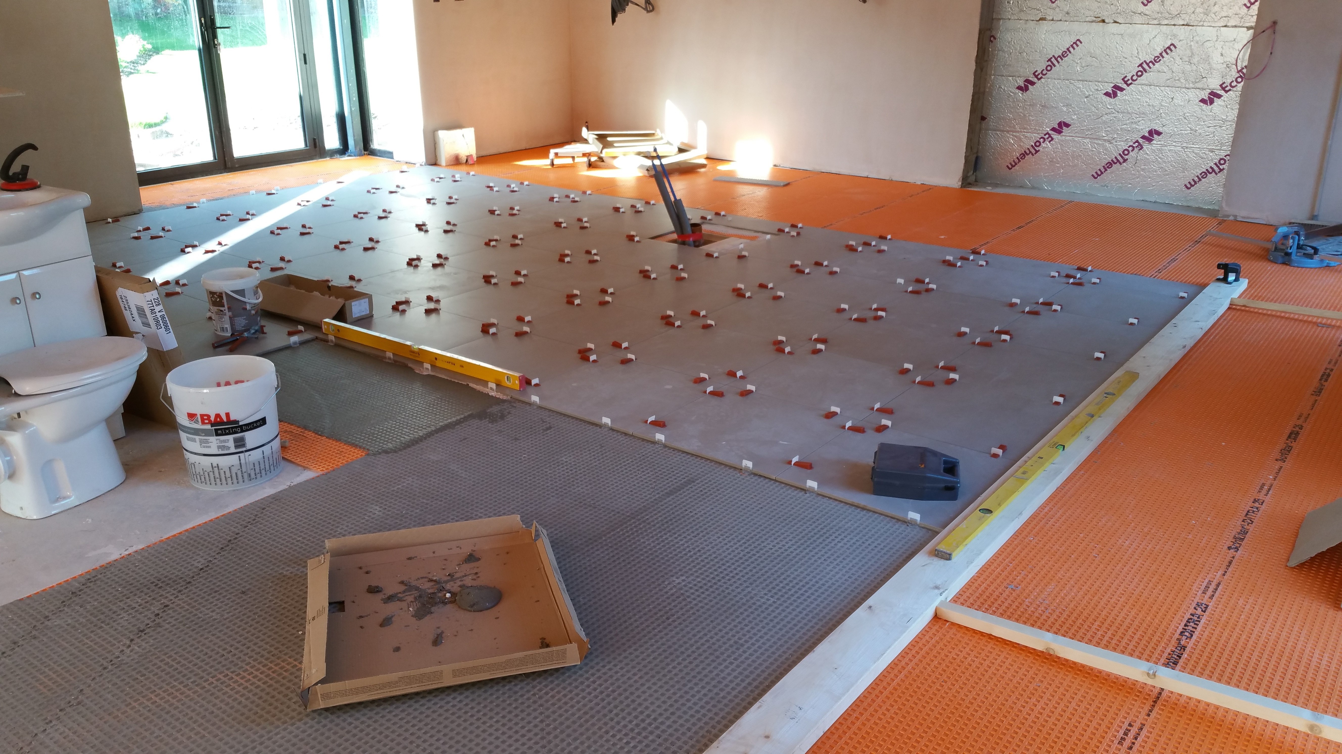

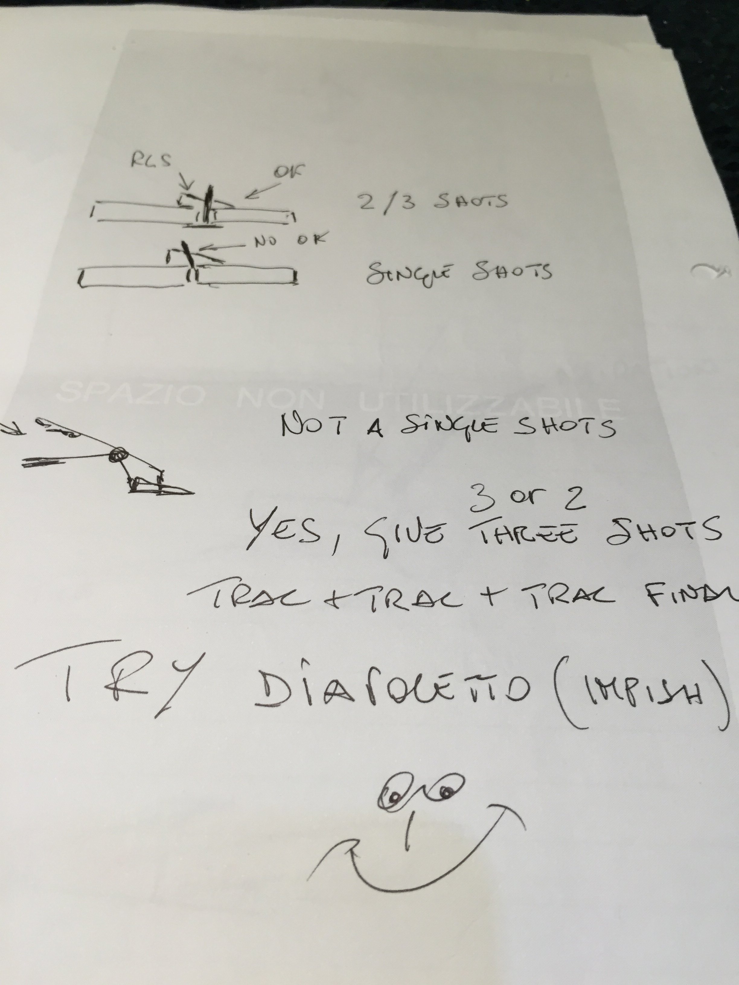

Antonio - I bought a few Raimondi bits this past week...
(don't know why it's turned over!)
Thanks Antonio! This was my first time using them. I didn't think about that.
I struggled for a while (that area took me 6 hours) but by the end of the day I felt I had the hang of it.
I wasn't tightening them past 3 or 4 clicks on the pliers but I will watch out for the alignment on the clips.
