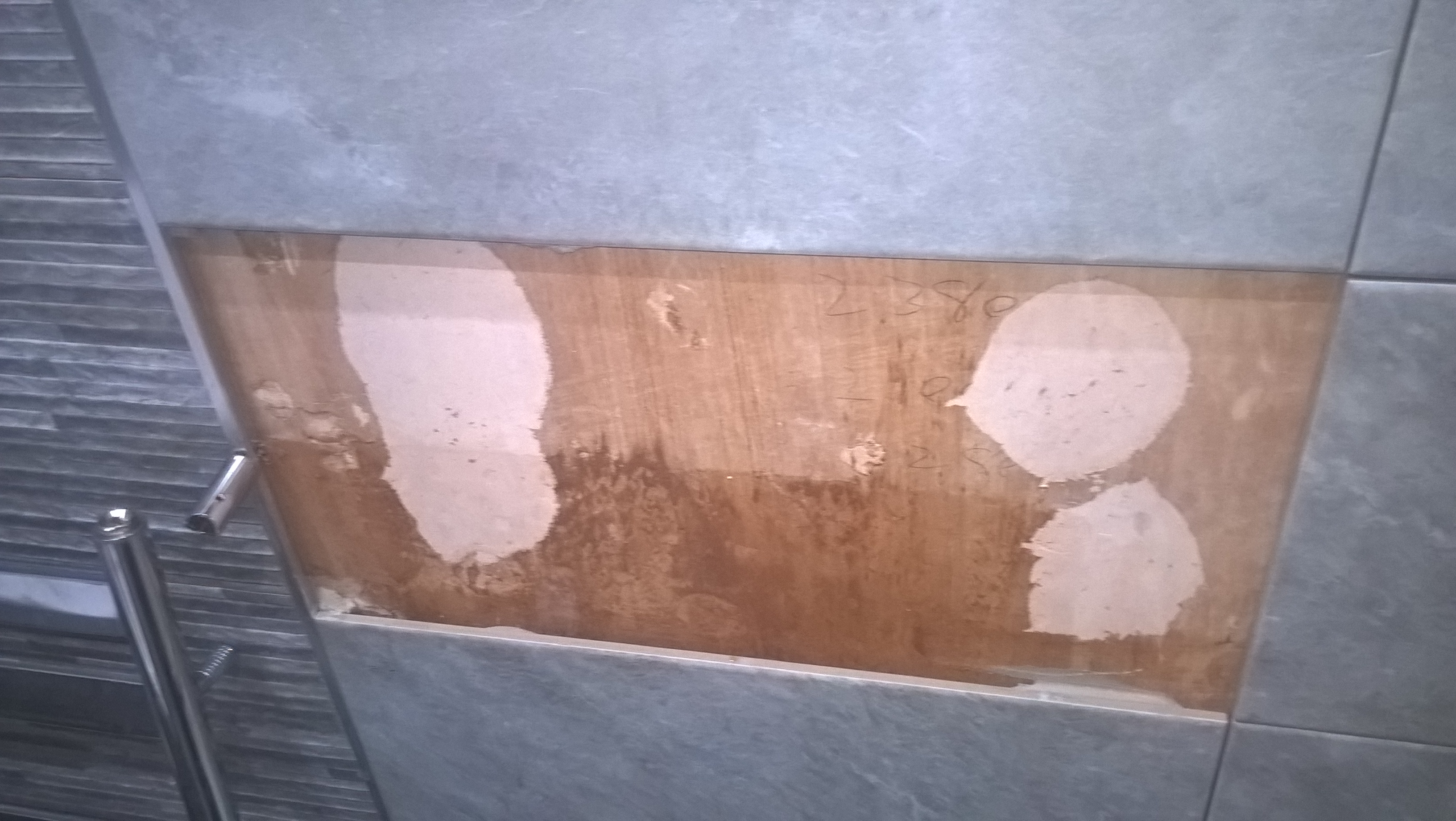

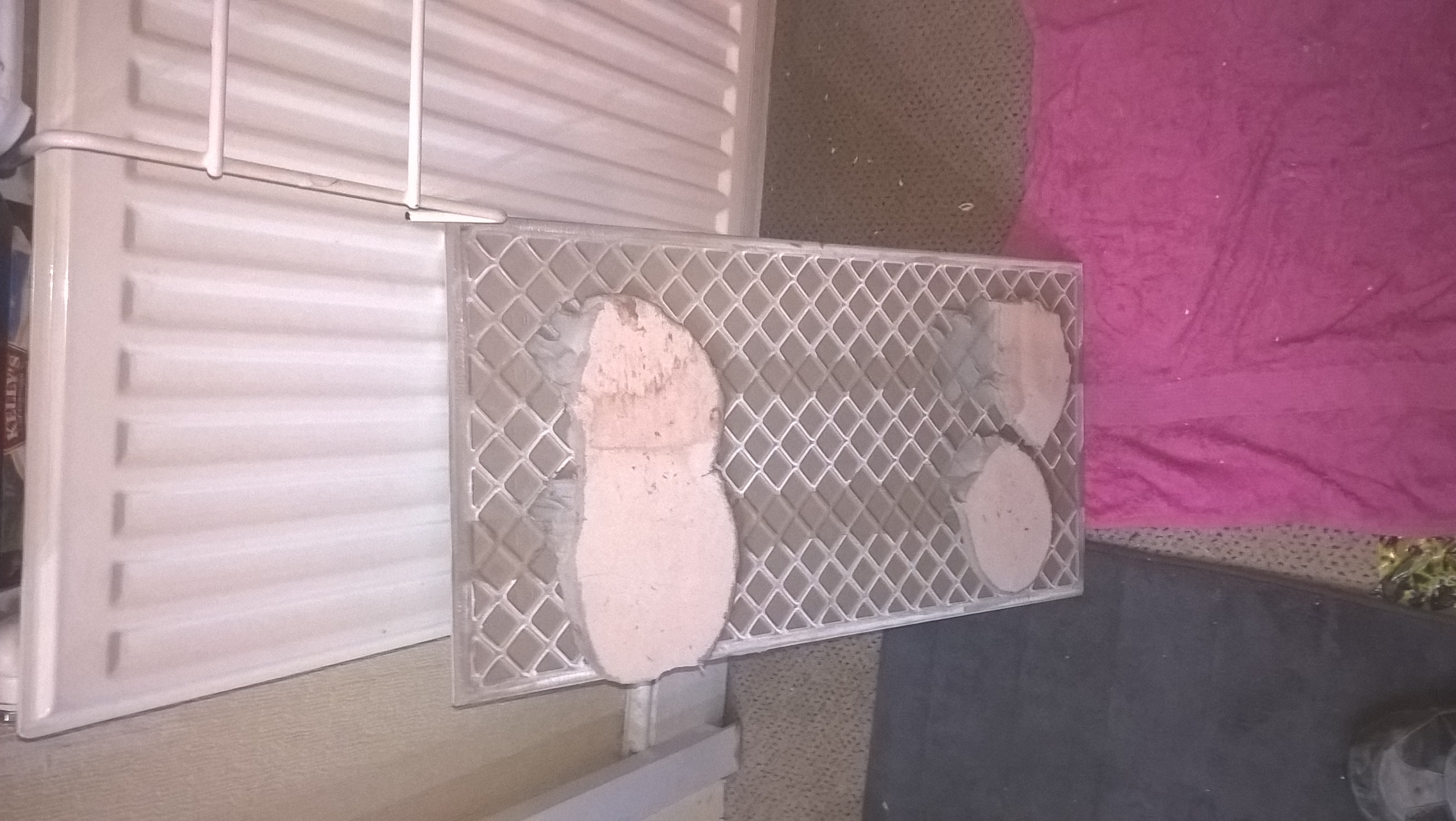

Got called out to look at this one before Christmas, had only been fitted a month earlier by a tiler recommended by the tile shop who wouldn't answer his phone anymore 🙁 it looked a very nice job on the face of it, HOWEVER..this tile was getting hit with the door handle every time they opened the door and had come loose...can't think why 🙁

Ooh now that's not good...on ply as well
See, and this is why I had to put this idiot in his place...
Bad that, on ply as well, not good...
@Ste450 , that's the kind of dot and dab this thread was originally about. Clearly far from the method you describe and use but I hope you can see where the criticism is coming from.
