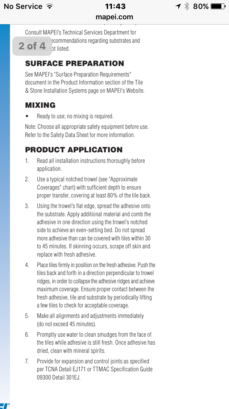

It was about 8 years ago mind, but I've had a look on Mapei's website and found the technical specs. It now says 80% coverage... 🙂
http://www.mapei.com/public/US/products/Type_1_EN_lr.pdf
