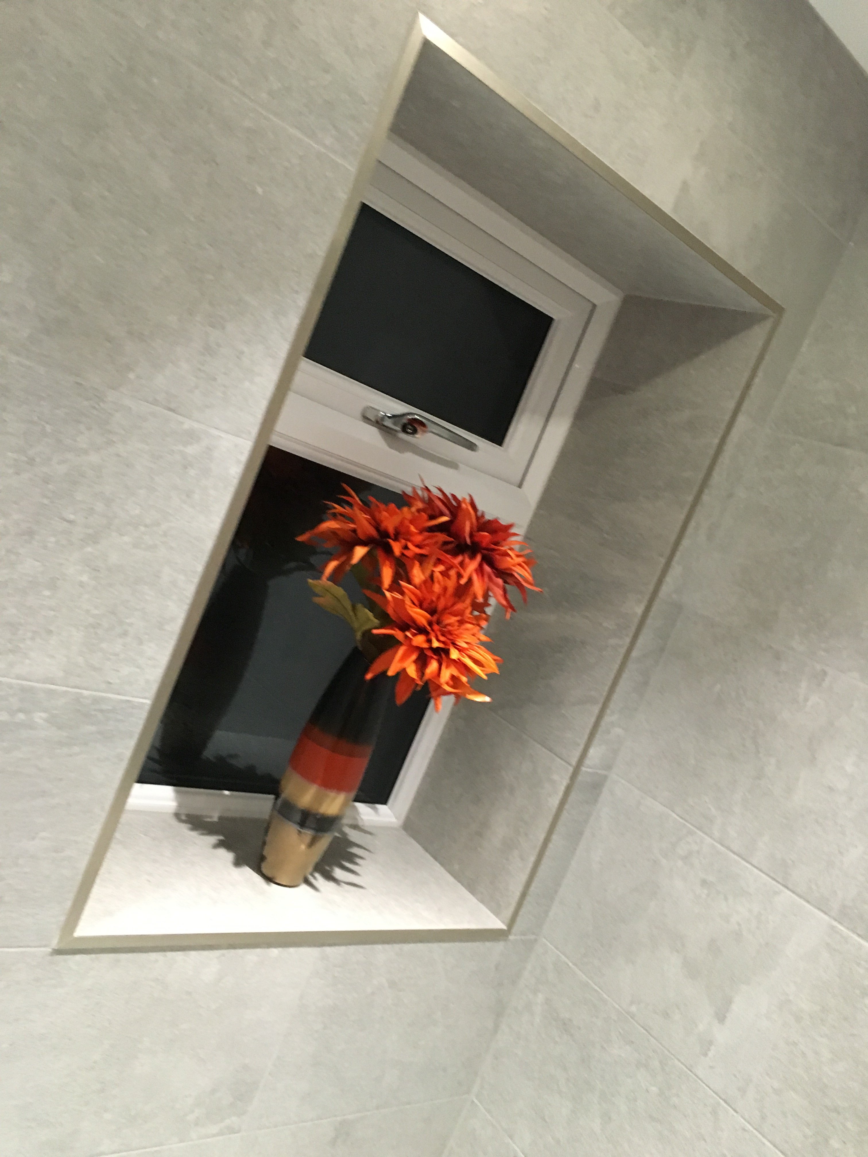

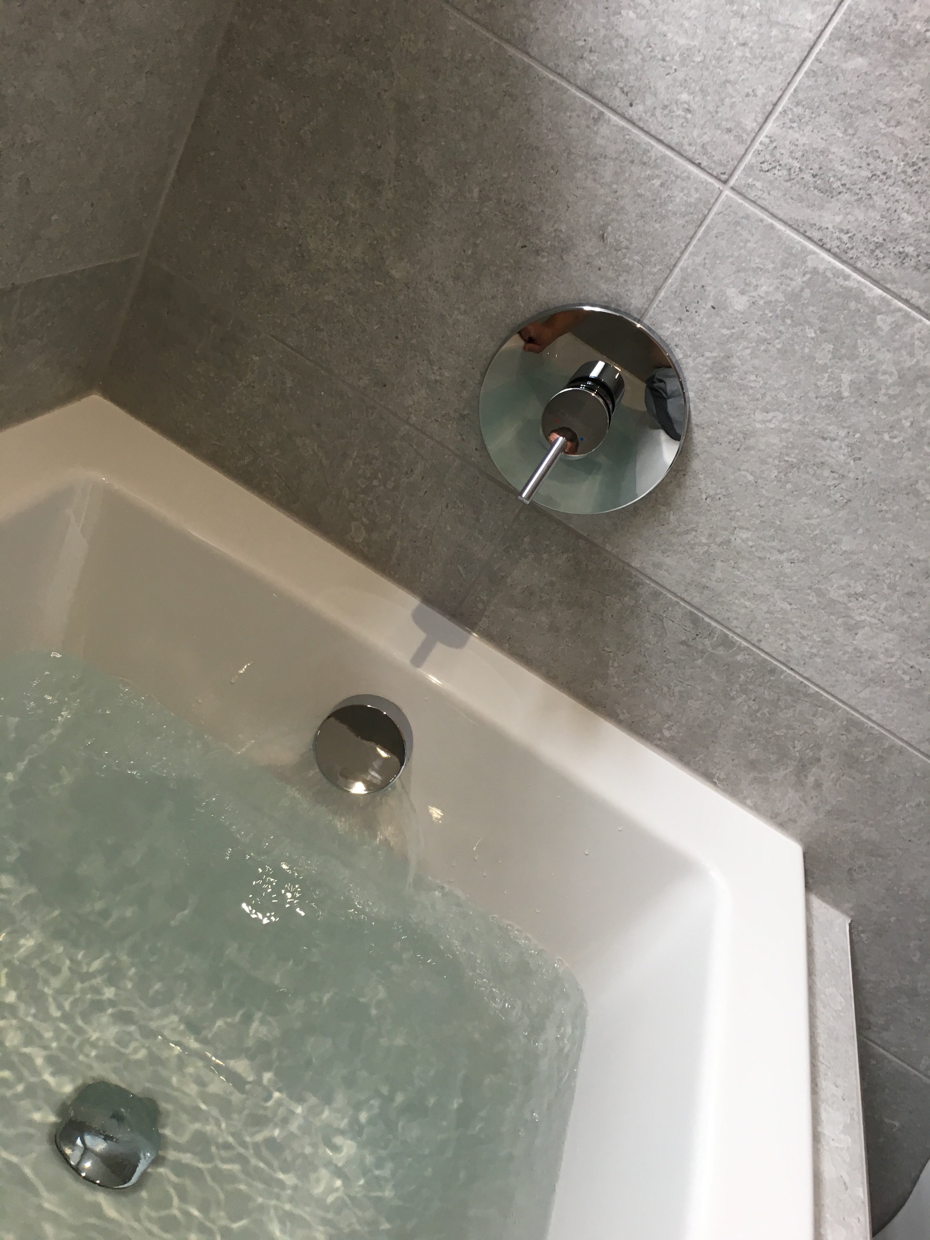

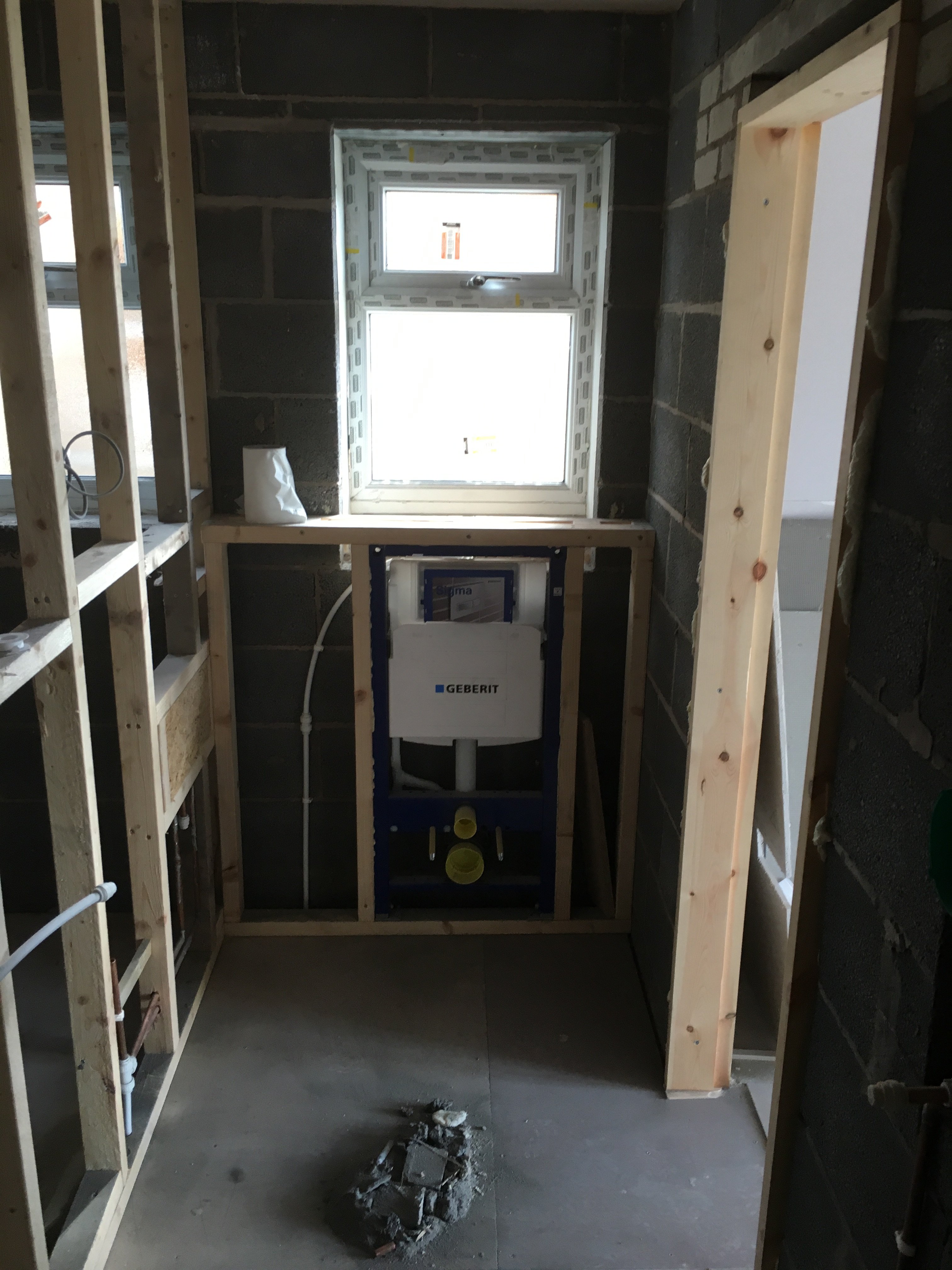

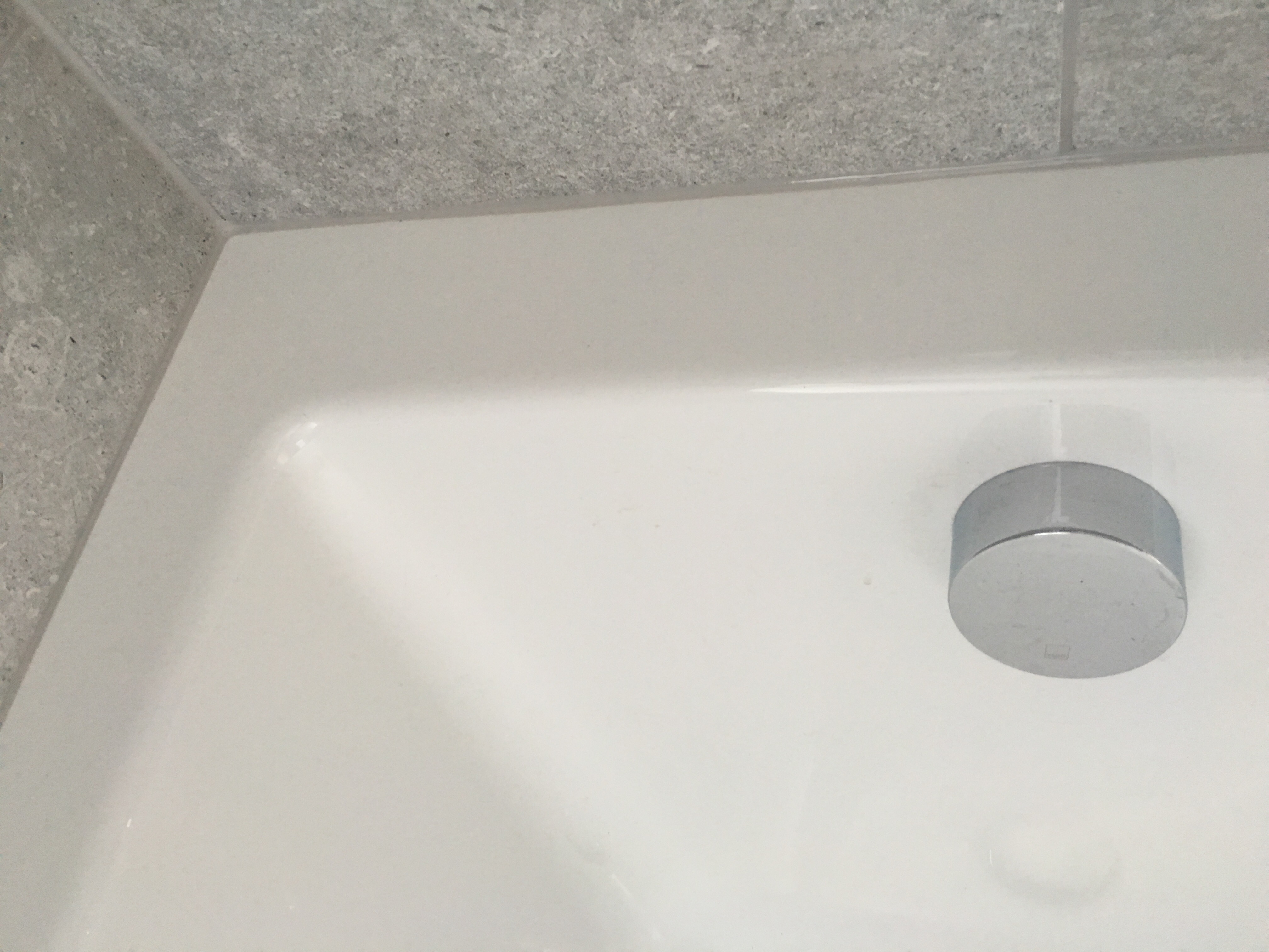

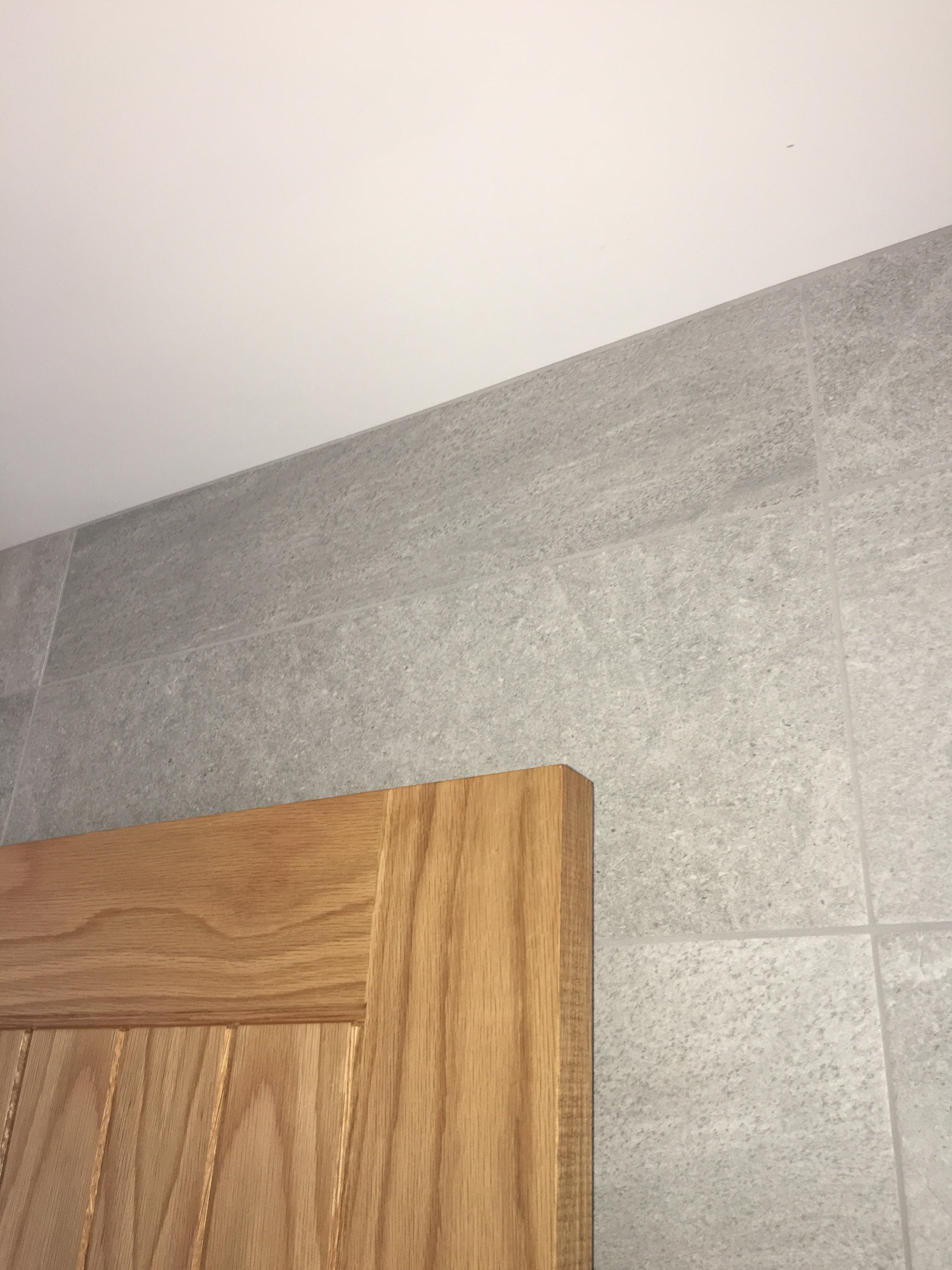

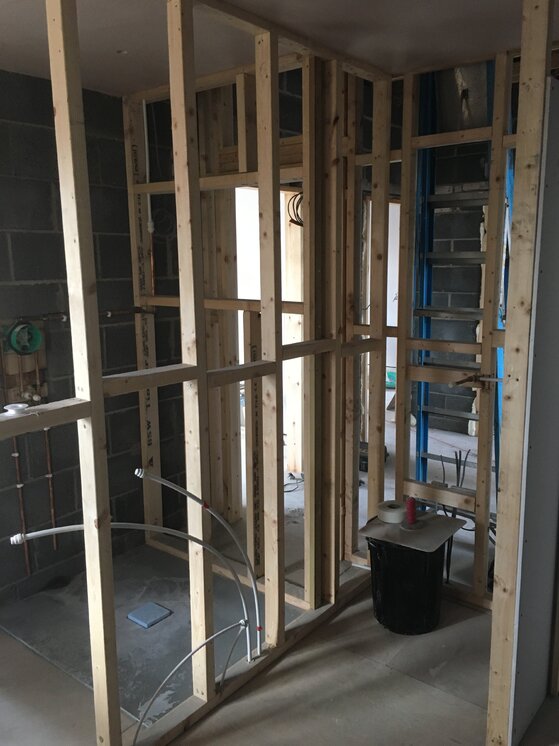

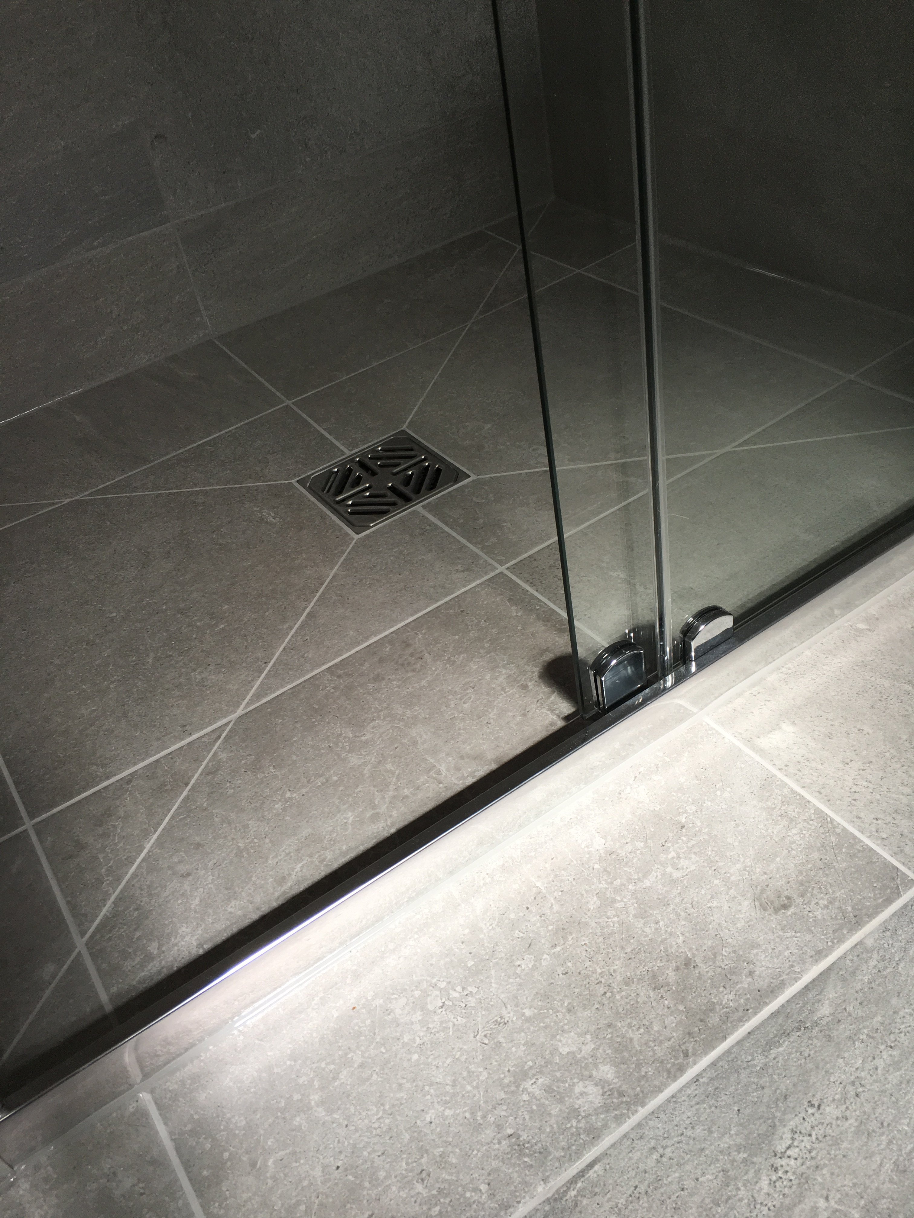

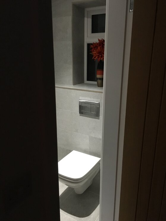

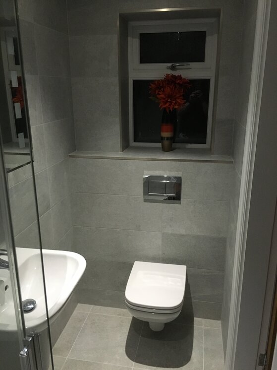

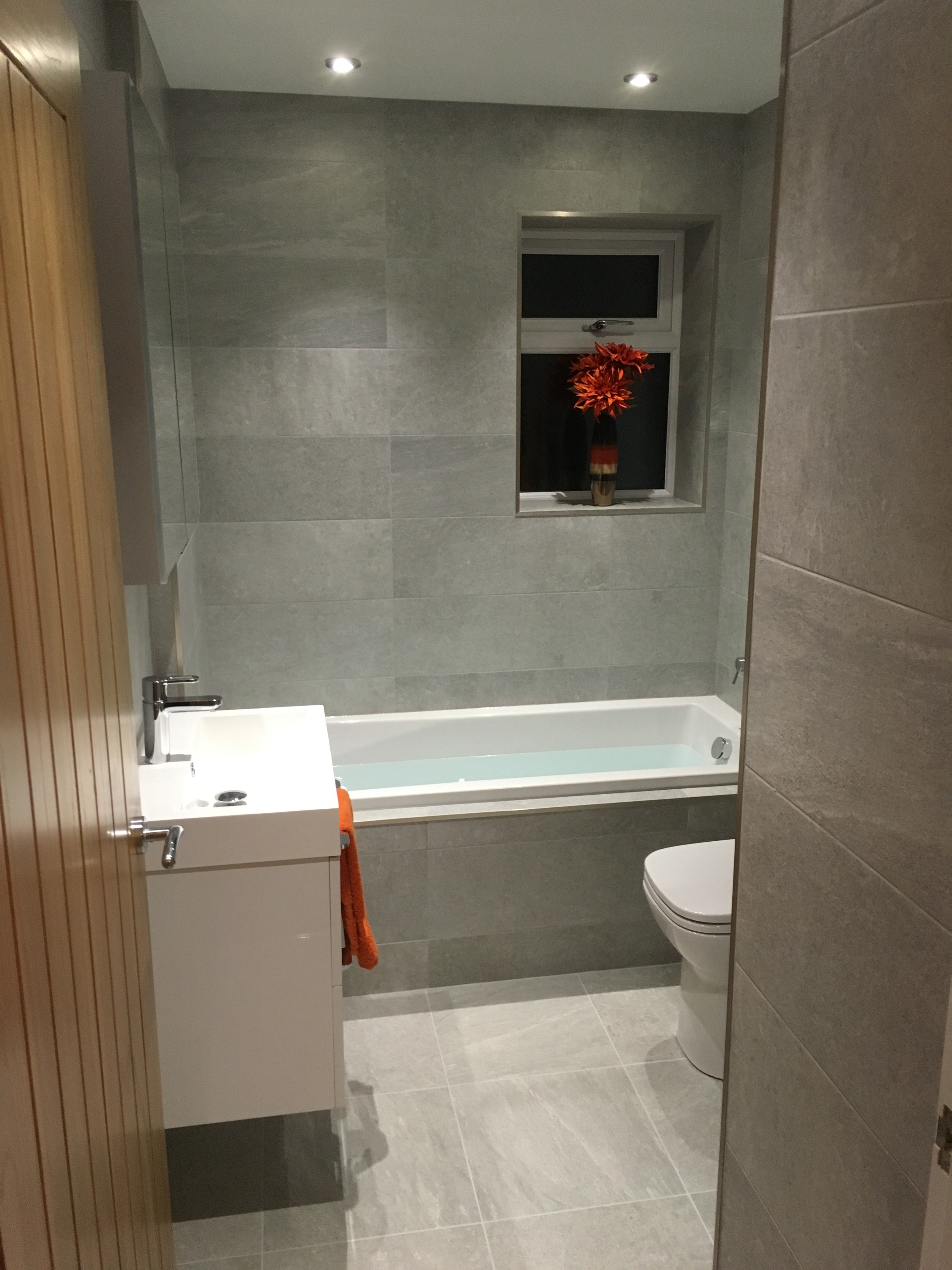

If the wall is out, I know exactly how much adhesive I need to put on and where. It does take a litte bit longer than combing, but will look a lot better, well worth the extra bit of time it takes. The manufactures recommended thickness is there to cover their own arses. Ive done 20mm thickness in parts before now, that was 8 years ago, I still have access to the tile and it is very much sound. Use a good flexible adhesive, even on a solid floor and you'll have no problems. If the wall or floor is miles out then I will tell the customer and I will level it up, but if the wall is only out 1/8 or 1/4 I'll get it out with the adhesive. Don't get me wrong if the floor is perfect, I'll comb it, but it has to be absolutely bang on. Wall prep, I can get perfect when dry lining, but building studwork is a little different. No matter how true you try to get it it's always out a tiny fraction because of slight twists and bends in the timber and it only takes one or two to throw the wall out an 1/8 of an inch or more, which you can get out with the tile and adhesive, so it doesn't matter too much. I'll put some photos up today... 🙂

Nice bathroom ste .

Cheers mate. I've not come on here to cause trouble, just to inform people that it can be done the way I do it as long as it's done properly using high quality cement based adhesive and using enough of it. I'm not going to do something that is going to damage my reputation and to be fair, it's been fine for 13 years 🙂
If your method works for you and you're achieving solid bed without exceeding adhesive depth limits then good for you mate.
The bathroom you've posted looks like a very nice job but as for people on here being 'gobsmacked', i think not. Also, compared to some on here, 13 years tiling is not a long time.
