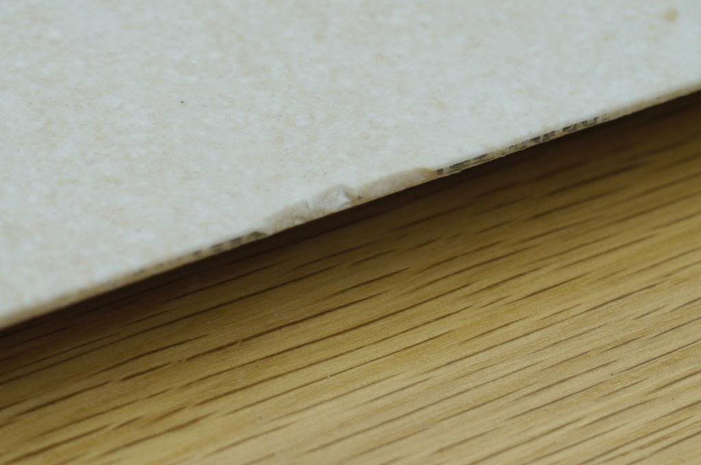

After a few runs it was obvious that we needed to be running speed 1 (the slowest) on the machine dry. Surprisingly this didn't slow the cutting down a great deal as the cutting head spent 100% of the time in contact with the tile surface rather than skipping about and ground it away evenly and neatly. I was timing what we were doing and I'd estimate it's going to take around 3 to 5 minutes to mitre a 300mm porcelain edge to a finish.
Surprise number 2 was the finish of the entire mitre was smooth, almost as if it had been finished with some emery paper and all smoothed off - not a sharp edge in sight. That wasn't something I'd even thought about.
