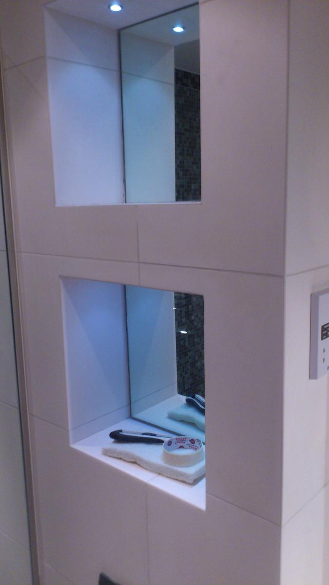

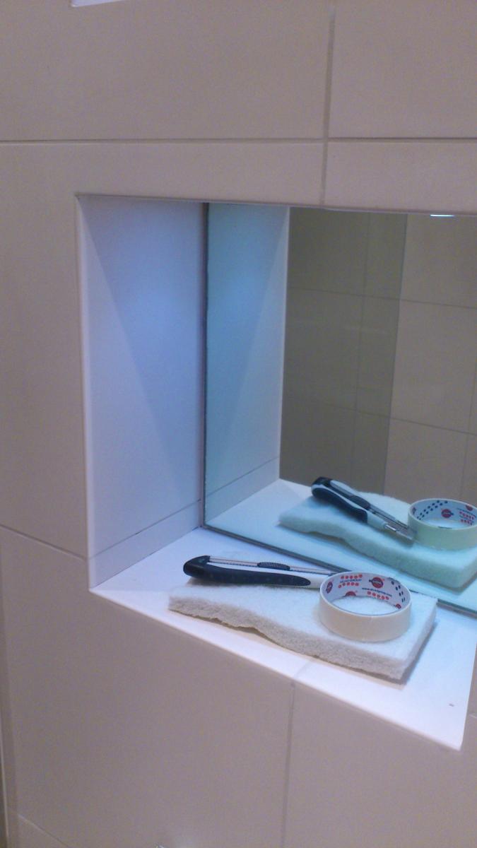

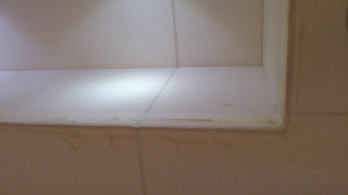

I'll get a few made up and see how we get on. The upside of this particular tool is the "profile" is being entirely hidden by design.

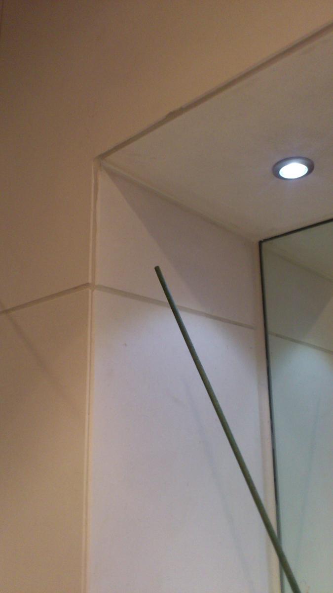

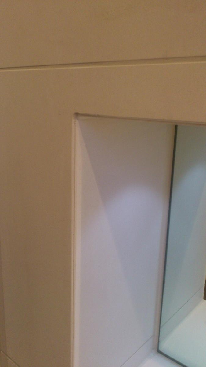

This is the profile I've asked the factory to provide a tool for. As you can see it actually cuts very slightly more than 45 degrees to give a little extra room and get the front edge tight.

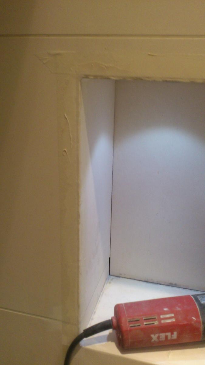

It will have an M14 thread in the top and although it would fit nicely on a grinder, unless the grinder was speed variable, you'd pretty quickly wreck the profiler and the tile.
Target speed would be under 4500 rpm (I'll get a firm number but that will be close). So that covers wet or dry polishers or speed variable grinders.
