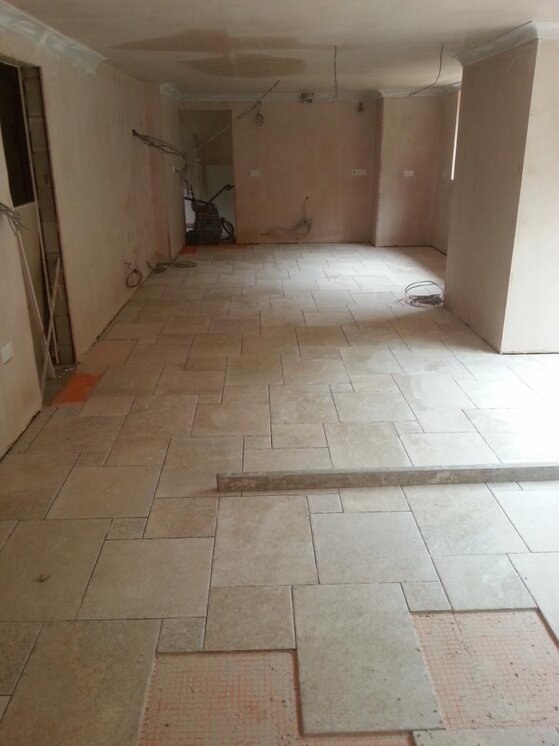

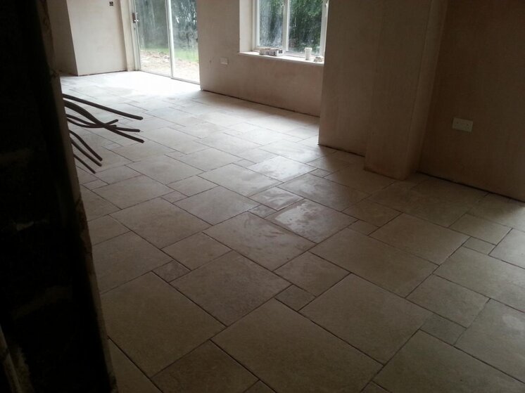

so here is what I did yesterday and today , tiles were already on site the floor was scraped, hoovered , primed and ditra matted the day before , about 75m2 tiled by me and another lad all tiles were back spread and the floor was bedded out with adhesive where needed . started at 9 am finished at 4 the first day started at 8.30am and finished at 5pm this evening and also latexed a small 10m2 utility floor as well , nothing special we didnt rush just worked at a normal pace left the place clean and tidy and put all our waste in the skip. I know tilers like PJC has guys that knock out 60m2 plus a day on their own to a fair standard on shop floors and do this day in and day out

Looks great mate, 2 days is bloody good. I really have to find someone to work with more often, i do 99% of jobs on my own and a floor like that would prob take me about 5 days 'odd'. Not so sure it's working out cost effective for me to keep doing it on my own, yeah i get a bigger lump of money but it is so much graft on your todd, all the washing, tidying, mixing etc takes up so much time. Trying to find a laborer is bloody difficult though.............

that looks like a real good job m8 and done in quick time ;0)

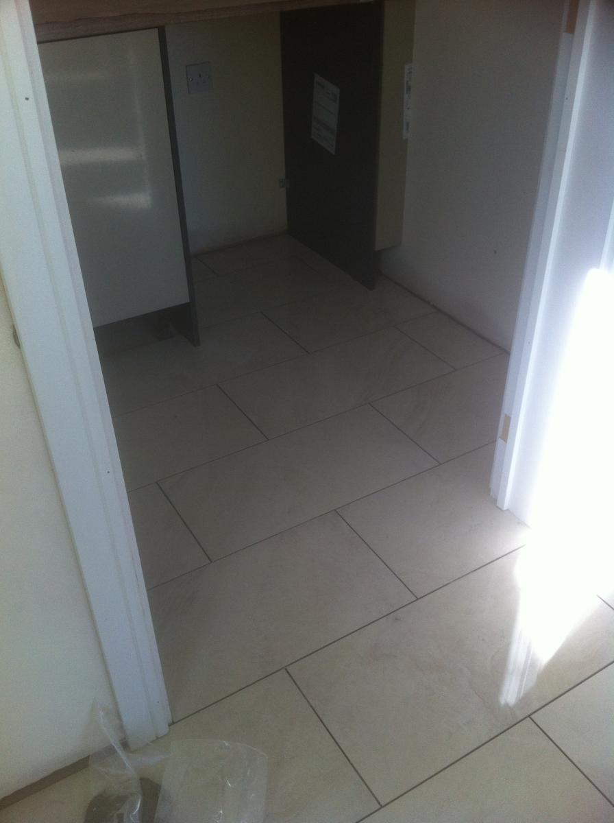

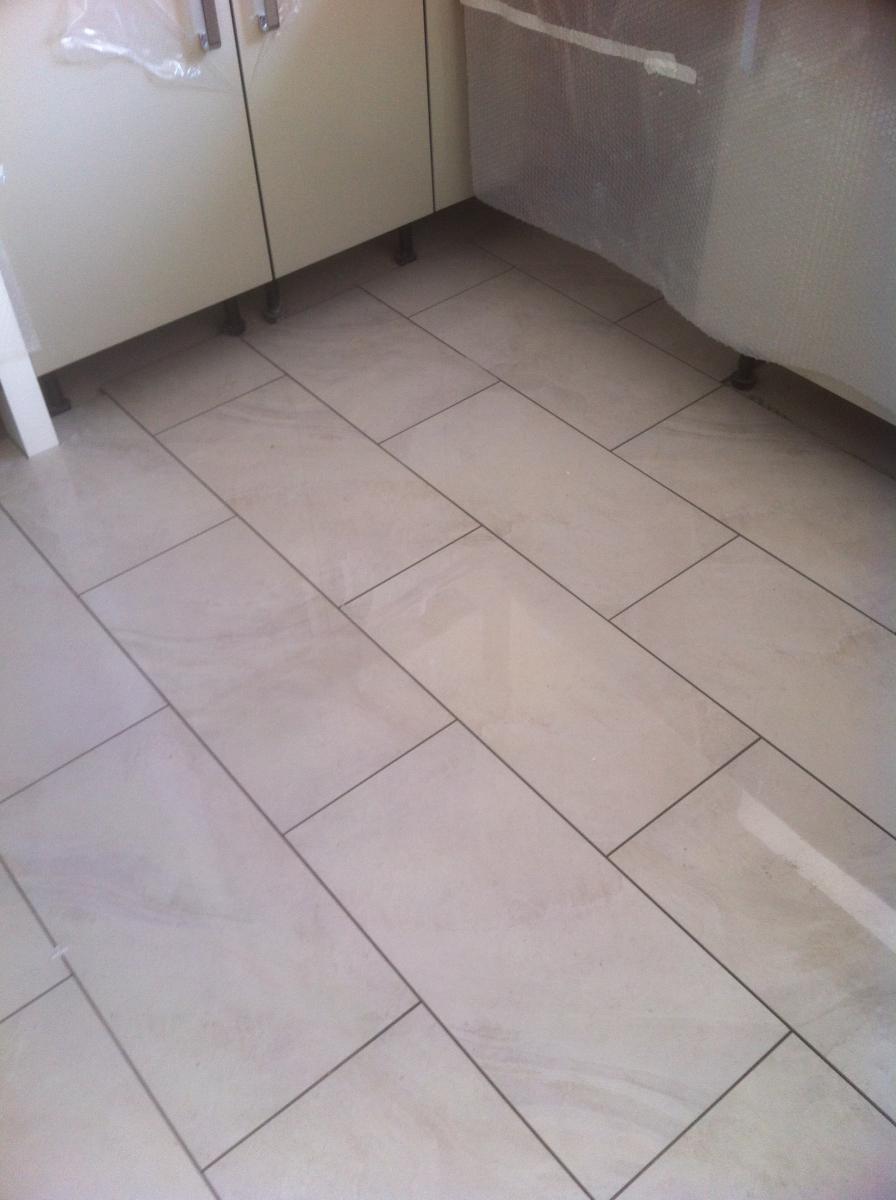

OK i was reading a thread and was quite surprised at the attitude of some of the members when it comes to tilers that can get the m2 done quick time. the comments came thick and fast "if it was done that quick it must have been done wrong as in not back skimmed or it must be rough or a lie". now I'm not one to start an argument and i know that fast does not automatically mean good. but it does not automatically mean bad. and i know it is hard for some to conceive that a tiler can fix more than five m2 per day without it being complete rubbish but believe it or not some of us can. and to be honest slow is no guarantee of quality either. i will post some pics tomorrow of a floor i did today 36m2 kitchen, dining room, broom cupboard, hall, cupboard under the stairs, and cloak room. on to a power floated floor using 600 by 300 Eagle polished porcelain.
but for now here is one from the other day not exactly high end but not minging either
View attachment 58889 View attachment 58890 View attachment 58891 View attachment 58892 View attachment 58893
