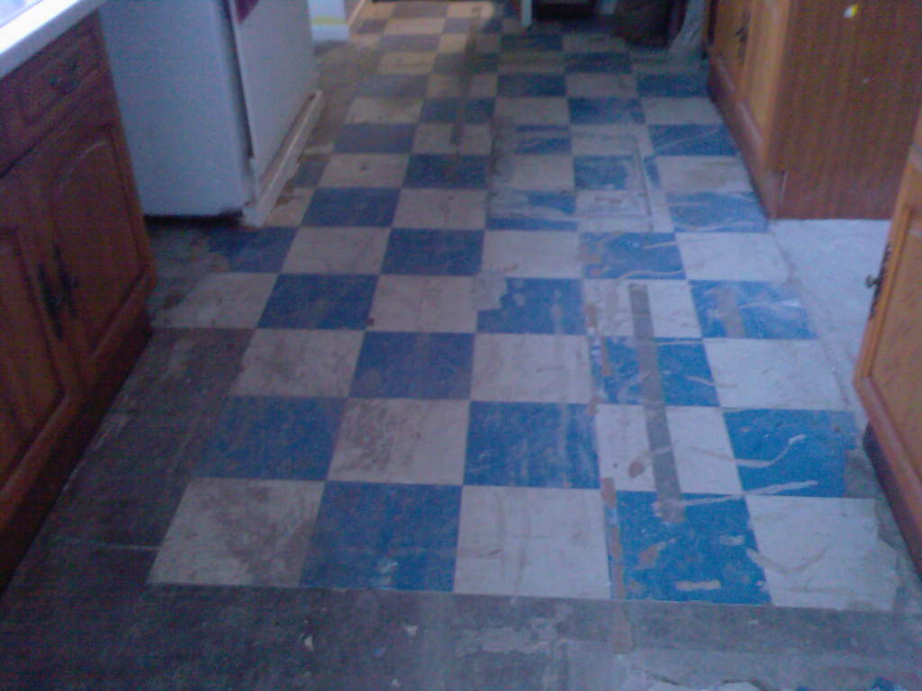

In the other part of room there are vinyl tiles and stuck solid, cant get them up with my SDS either was wondering whether a clean and slurry coat over would be suffice. Here are some pics.

Its flush with the floor and sealed with no movement so was going to use flexi addy over this part only with normal over the rest.
BAL SPF will go straight over secure vinyl tiles. If they are rough you could skim over with BAL Acrybase first.
